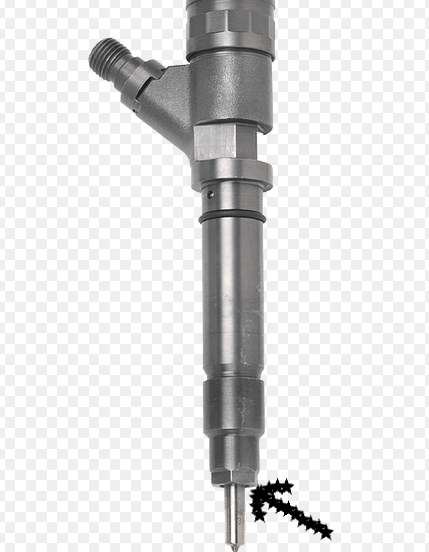

Just as an afterthought ... I once had a Ford Escort diesel that developed an-almost-impossible to start problem.
The fault was the injectors. They weren't 'sticking' or blocked - they were actually worn. Where the nozzle fits to the body ... the body had become 'dished' because of being worn away by compression/fuel spray. If it hadn't been for somebody pointing it out to me I wouldn't have noticed or realised.
The image below is of a diesel injector (not your particular injector). I've drawn an arrow where the wear - the 'dishing' occurs.
