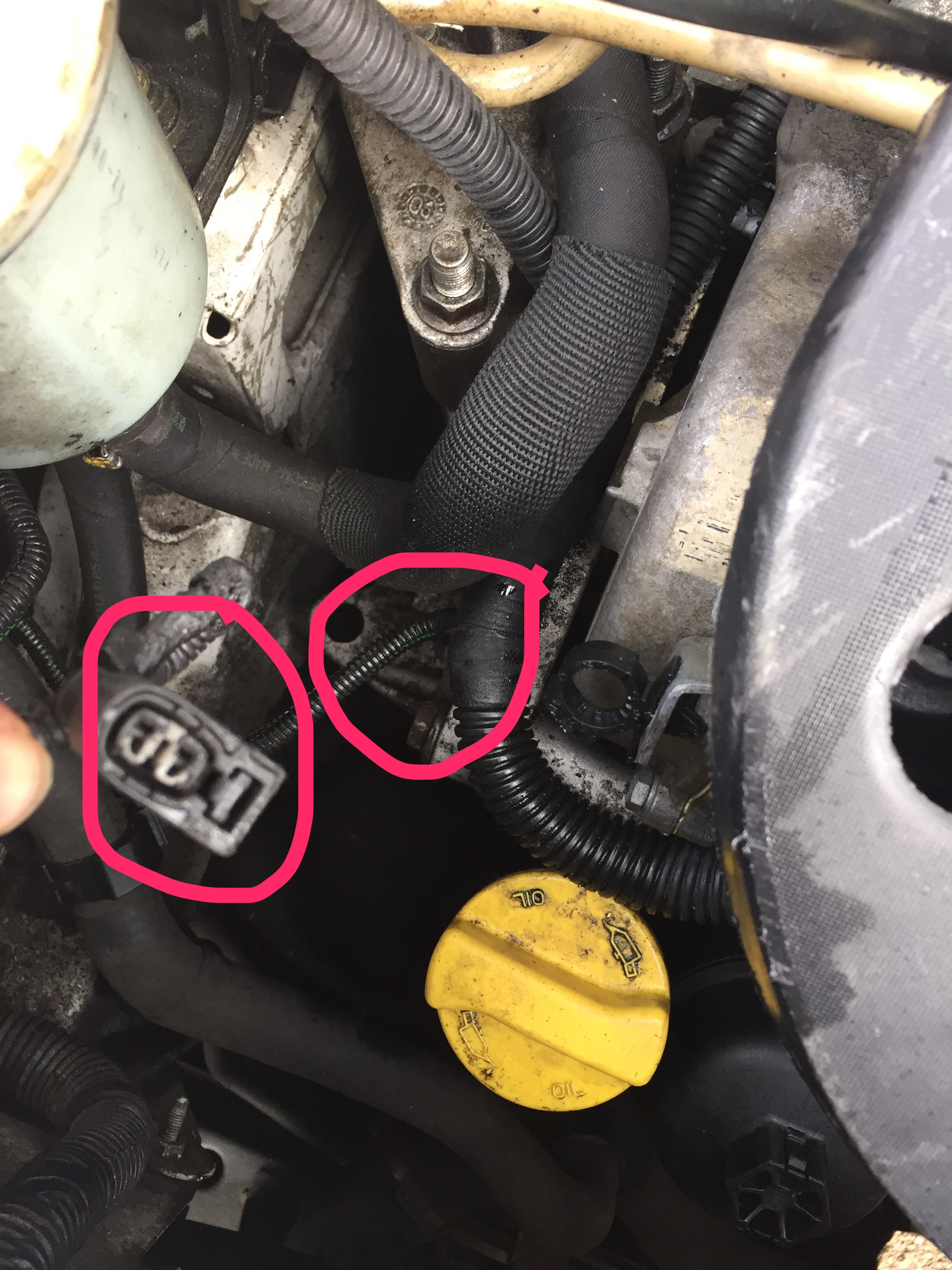

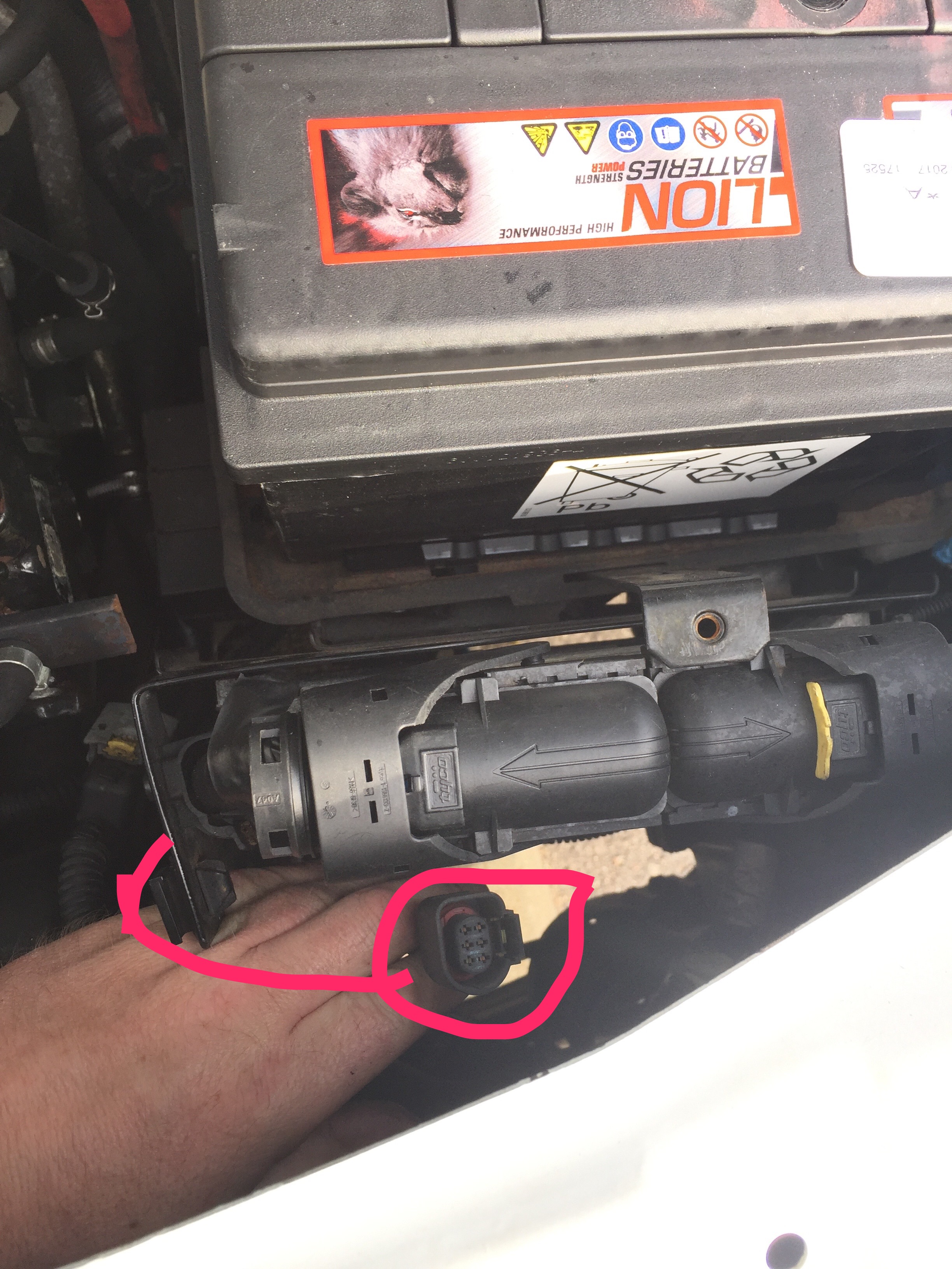

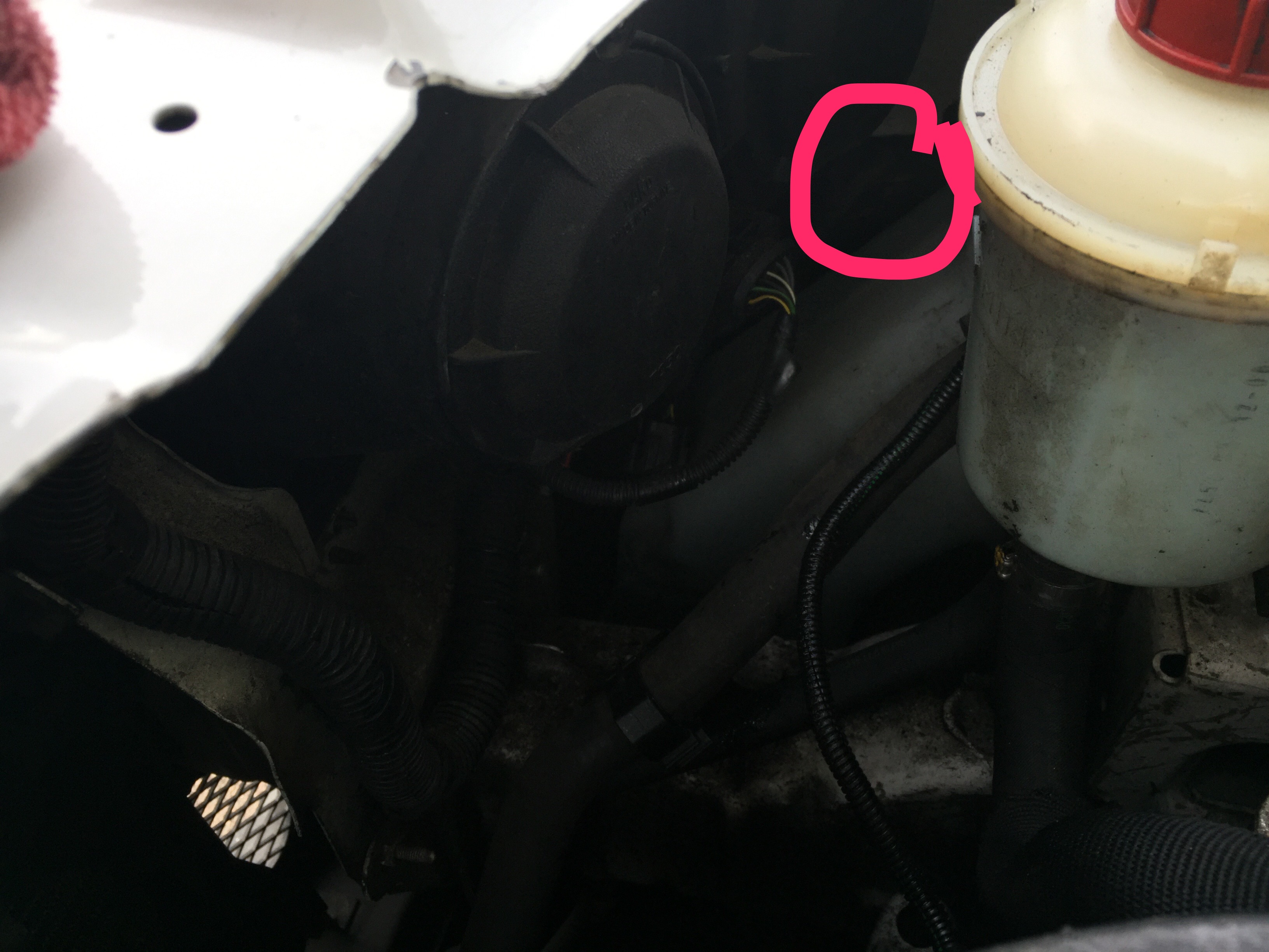

whilst I was rummaging around I found a couple of loose connections.
Does anyone know what these are for ?

I have outlined on the photo where someone has been tinkering about . The lie line is where the air filter cover has been cut away and glued . The pink circle shows where there has been connections removed and a steel bar been added! This cannaot be good ?

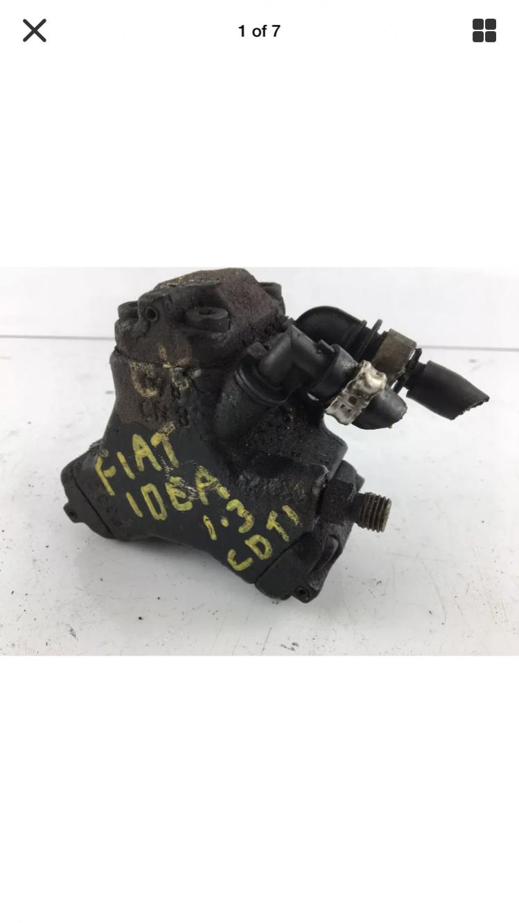

Looking at the state of my pump I would imagine that I would need a new pump. Would this fit my 2007 Doblo ? It's off a fiat idea 2006.
