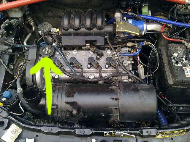

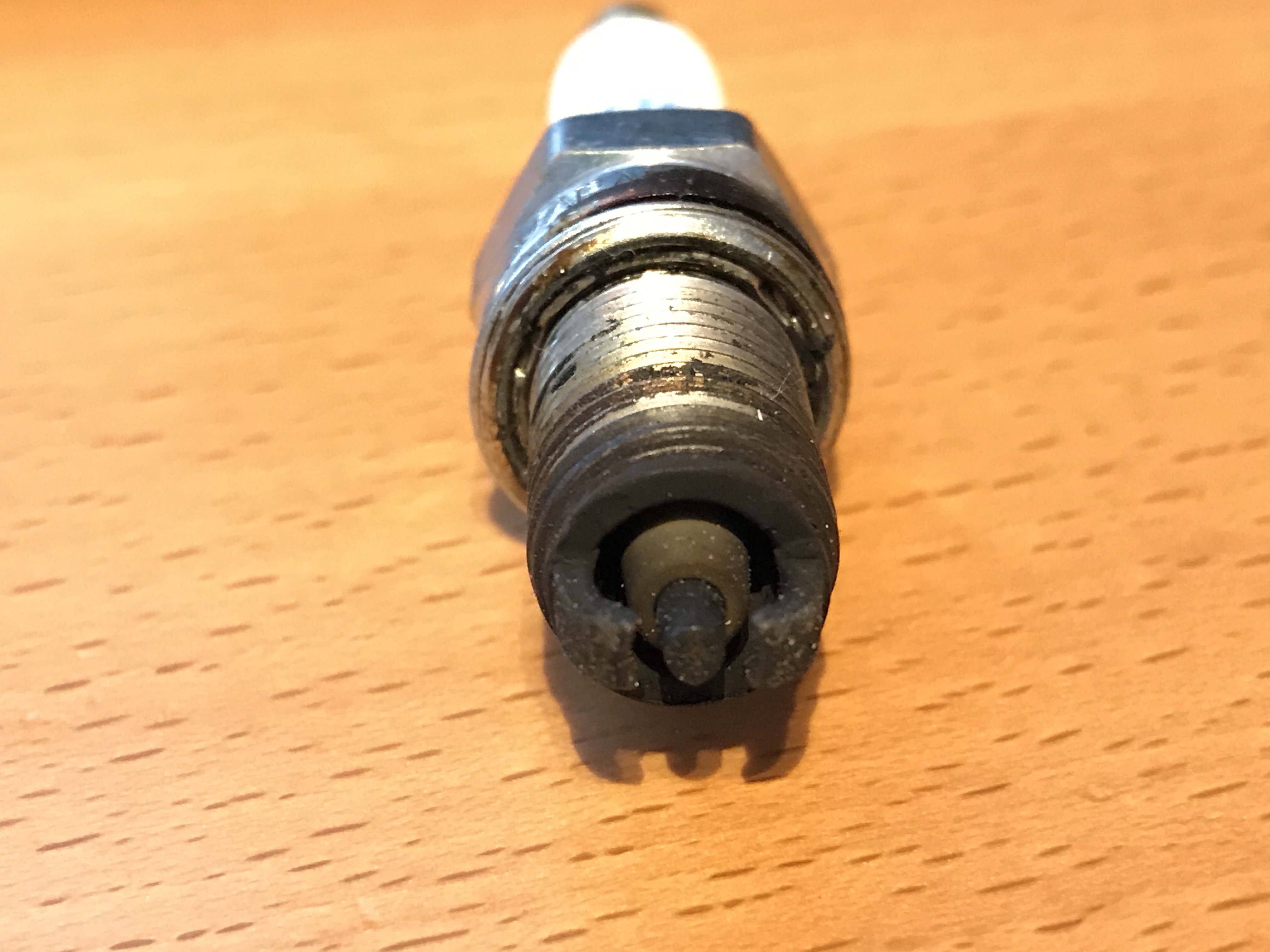

Thanks for the diagram flisko. Looks like my plug is "carbon fouled".

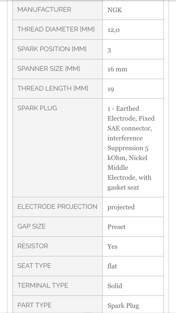

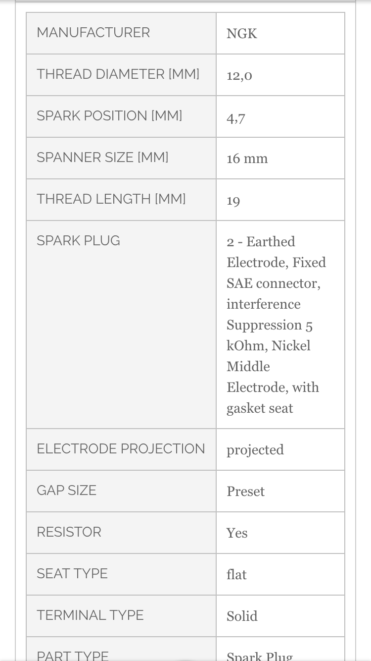

Just back from the car parts place. The original fit item was ngk dcpr8ekc. They have sold me ngk dcpr8e-n. Is that ok? Only difference I can see in the specs below is on the -n version the spark position is 3mm compared to 4.7mm on the ekc?
My plugs are from 180,000km and on 245,000 now. They look very good. I have set the gap a few times but it has been so close it was not really necessary. Presumably computers enable the spark to be as small as possible for good ignition? Spark is fairly puny compared to old style arrangement but no problem starting or running.

>>ngk dcpr8e-n I think I have those. Got it written on a piece of paper here but not sure they are the ones fitted. I will check later today

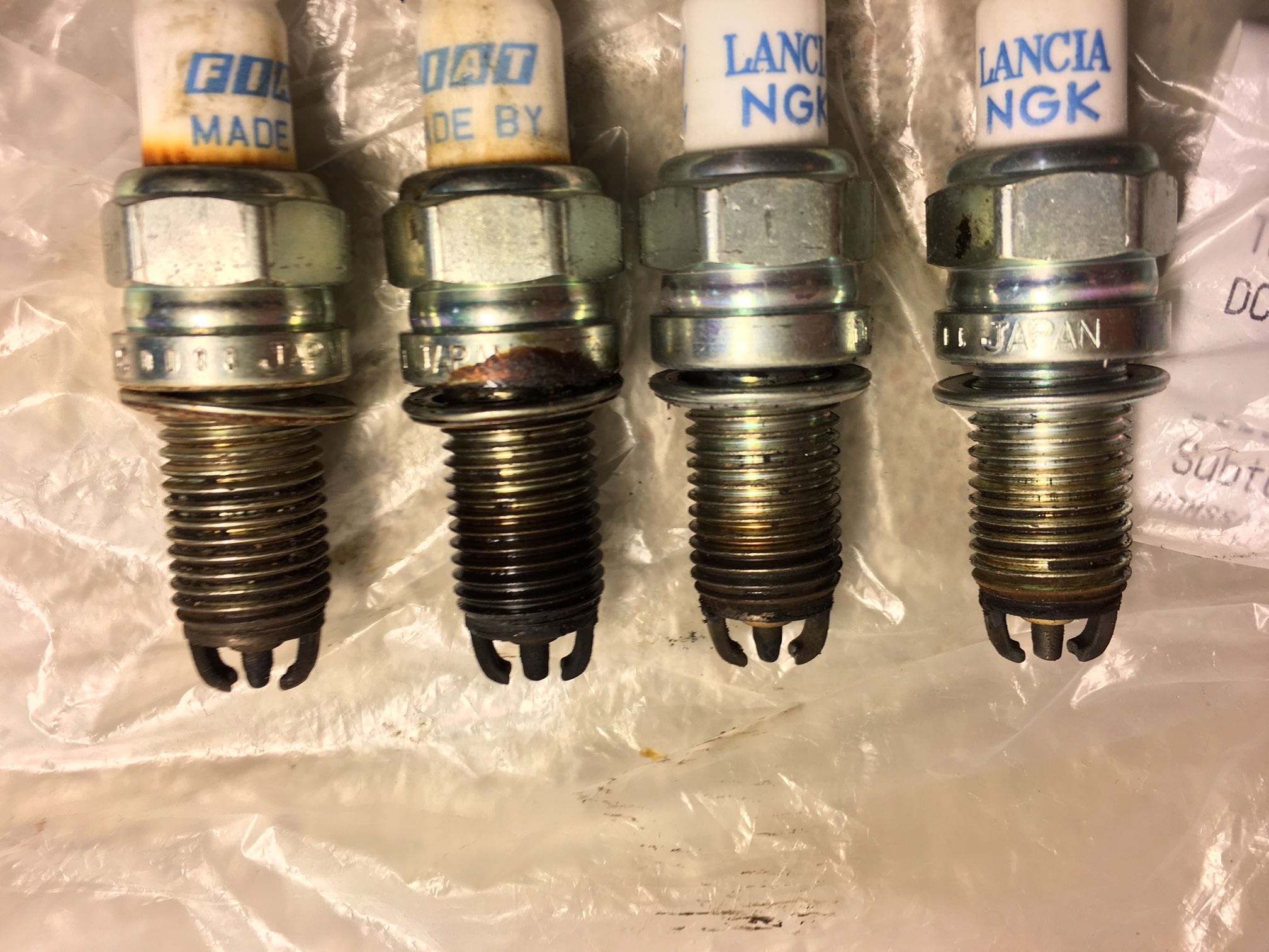

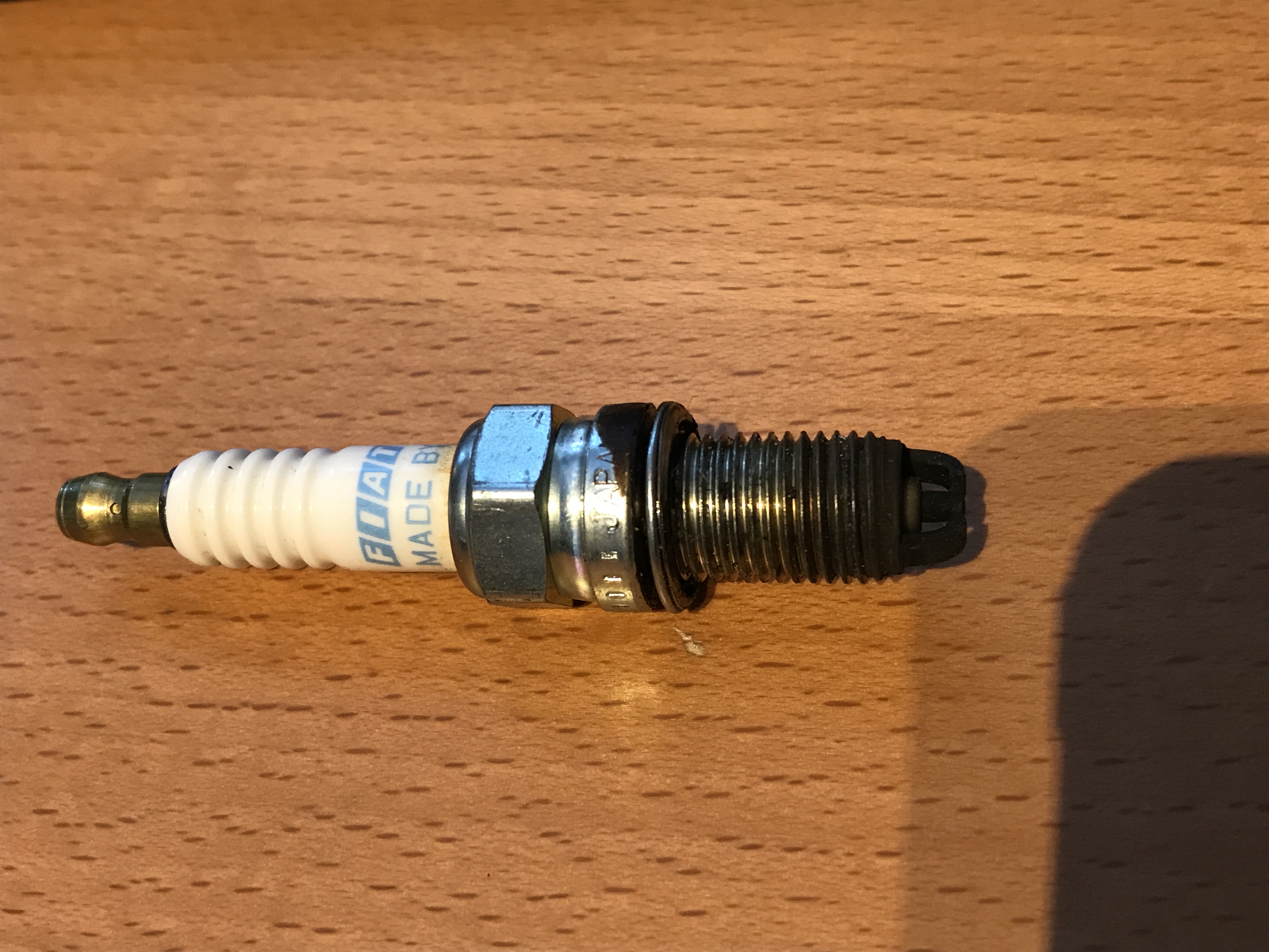

Below image shows the plugs I pulled out, arranged in the same order as the cylinders as you look at the front of the car. Would the blackening on second from left indicate this is the one which has been misfiring?

I would assume that cylinder is the problem one.
Might be worth looking at the wiring to the injector and maybe swapping the injector.
A misfiring cylinder can be found by a cooler exhaust outlet.

my 16v has DCPR7E-N-10 which means nothing to me but when i go to the supplier they list a hotter or colder plug. The ones I have work so I have left them alone.

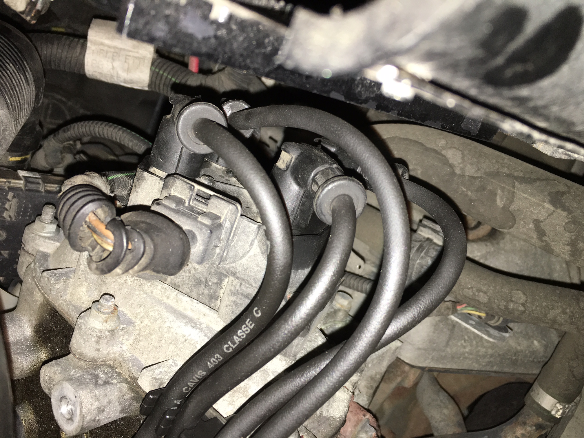

Well today I changed the HT leads and so far it seems the problem is fixed, so it looks like the "burning rubber" smell was a side effect of one of the leads having a high contact resistance. I'm glad it was something simple after all.
