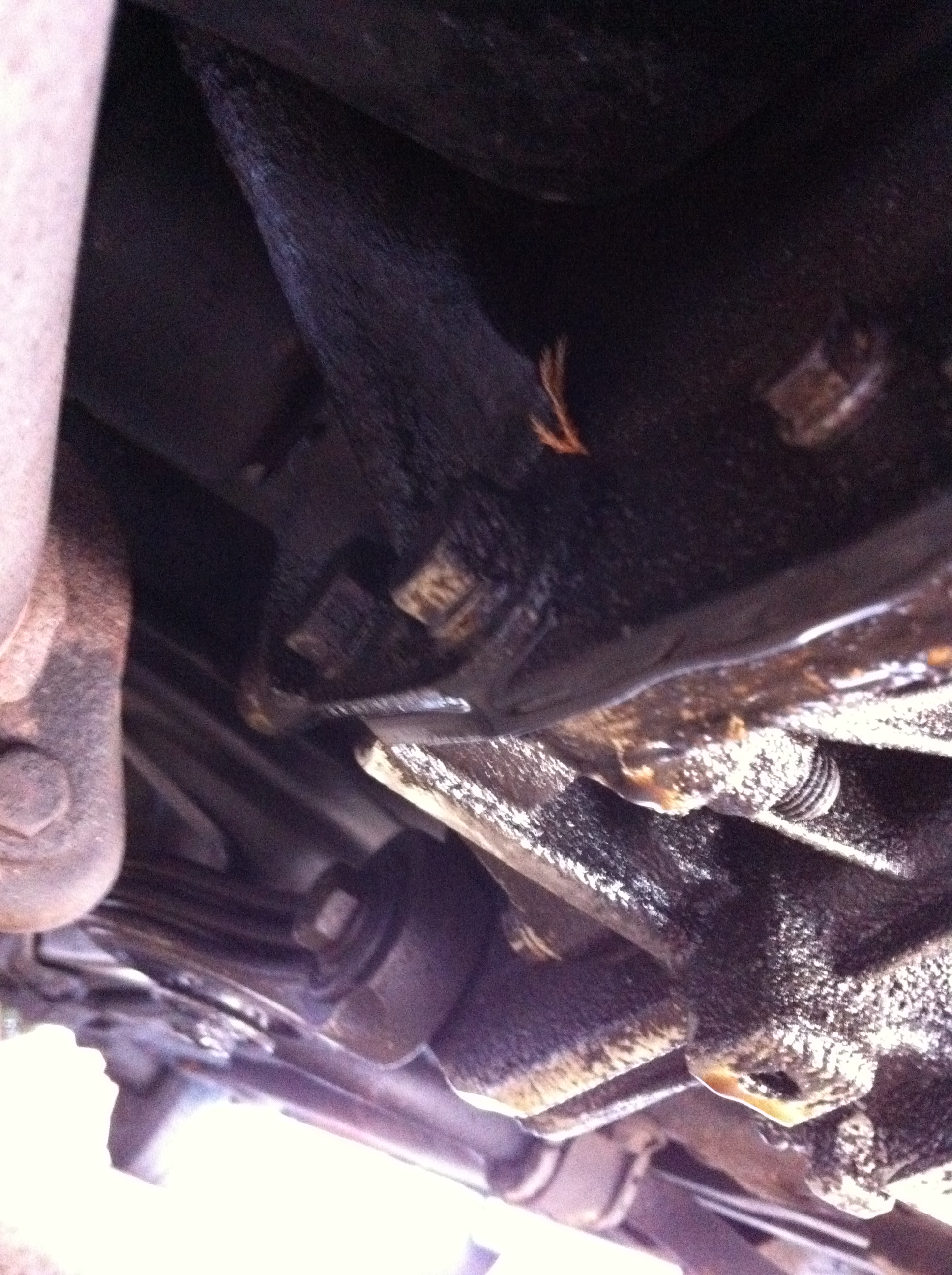

Ive been trying to keep it topped up as best i can, atm i havnt got enough money to get the box replaced. Ive spoke to a few people and they said it could just be somthing as easy ad simple as a seal. Ive took some pics of the box but cant put em up yet coz im on my phone. Would this be a MOT failure btw as its due in a couple of weeks? Cheers. Marc

The drive shaft looks dry but the bellhousing looks wet.
If both shafts are dry, its leaking from the gearbox input shaft (a more common fault). But continue to use the car and it will collapse. Sooner or later oil will get onto the clutch so the MoT wont be likely unless its towed in.
As its been run low enough to make whining noise so while a repair is possible, a new (used) gearbox makes more sense. The clutch may not be too good either as oil usually gets onto the friction plate.

is the input shaft seal the big thick pipe that connects from what looks like the wheel, if it is then this the only actual thing on the whole box that is bone dry as you can see from the pics. really confused about the whole thing. atm just havnt got spare 300 quid to get a new box lol.

The gearbox has input power in from the engine and clutch via a shaft and an oil seal and bearing. It has 2 outputs (driveshafts) - one to each wheel.
If the outputs are dry and there are no obvious cracks or leaking fill/drain plugs its likely to be the input shaft bearing and seal. That will often be dry until the engine is started so fits your symptoms. TBH the mechanic should have run your engine on his car lift to look for the source of leaking oil.
Easiest option is a new (used) gearbox and a new clutch as it will have got contaminated with oil.
