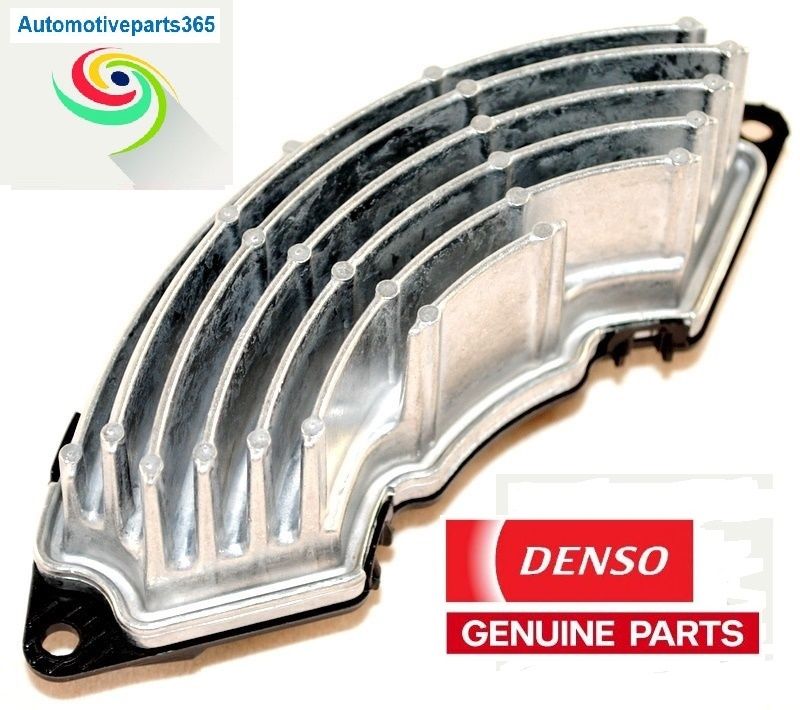

I did send pictures , not sure if they showed . But I can’t seem to find the 5 pin plug. I do have some cables that look burnt out so I’m assuming it’s around there , but I have 2 plugs , one black and one grey , both being 2 pin plugs
Does this look familiar? I did some searching and this popped up , which is what I have in my car

It only now showed ?. Thanks , I’ve seen that photo before t I don’t have the 5 pin plug in that place on my car.

Go get some photos of the area under the passenger side dahsboard. Should be the fan, the heater resistor and another connection. Take the glovebox out and way of you can. Maybe, just maybe, there is no resistor there as the previous owner removed due to burnt connectors that you have. So rather than replacing the resistor and wiring loom he just took out the resistor and hence why you are getting nowt working. The resistor well back against the bulkhead and *should* have a wire connected to it.
