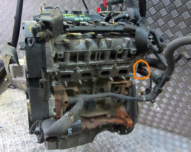

Quick Google search. Obviously, the wiring for top sensor is near the top of the manifold. For the second must be lower. That's all. No "mystery" here. You can always disconnect one sensor and see what's the reaction of the ECU and OBD2 (MES). Where is the change or a fault code (before or after the cat.).

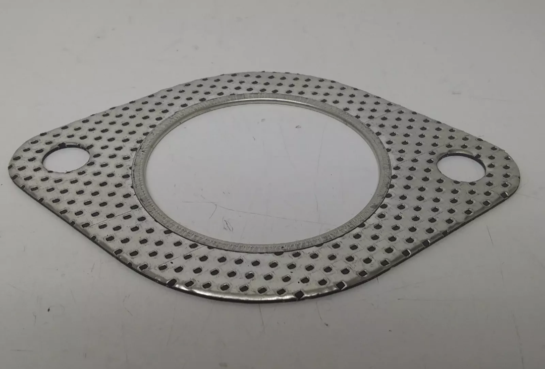

Also, does anyone know what is the product code for exhaust rvs donut gasket ?
I thought some Punto experts would have been along, by now
It was my understanding that the 1.4 16v of this era didn't use a doughnut, and used this type instead
FIAT 71736864
I could easily be wrong though
FIAT 71736864

I have even two of those gaskets, they are leaking in the middle and clearly on both exhaust pipe and cat. flanges there is an groove. I'll figure something out.

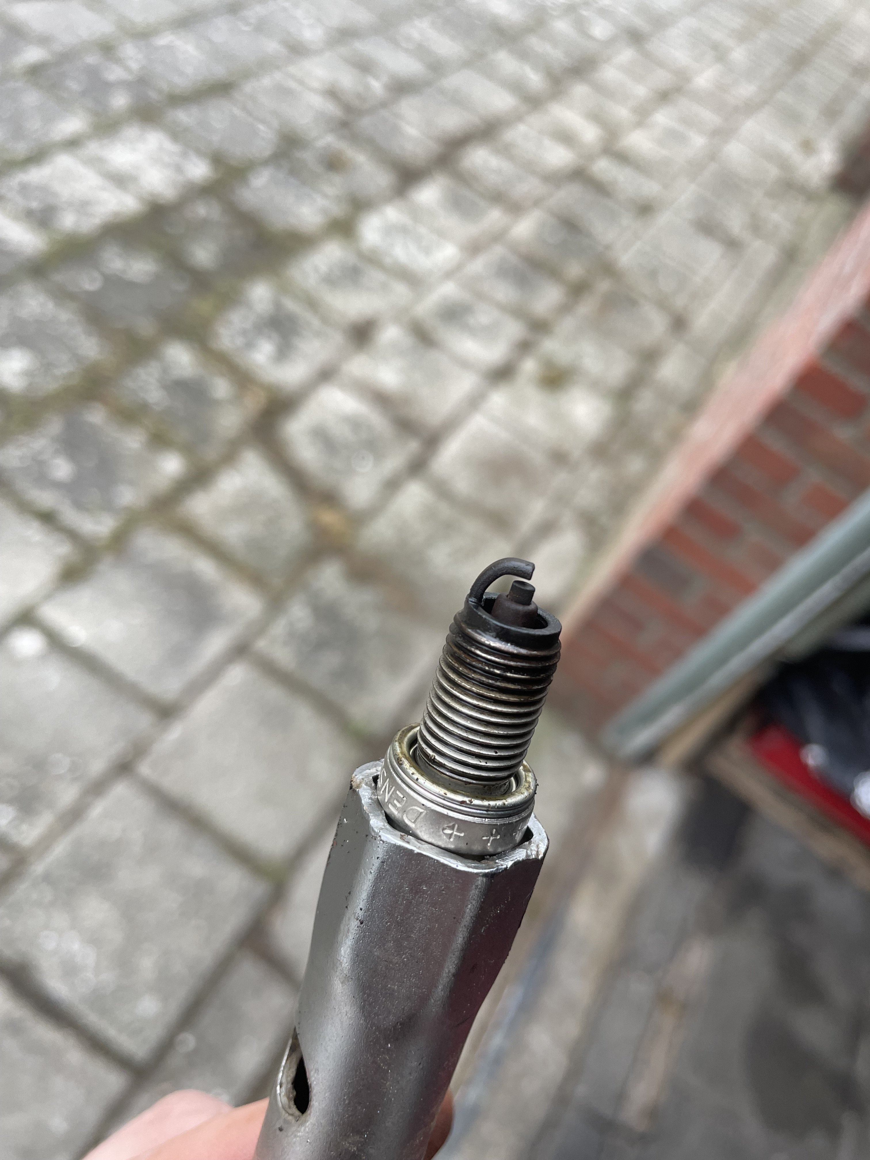

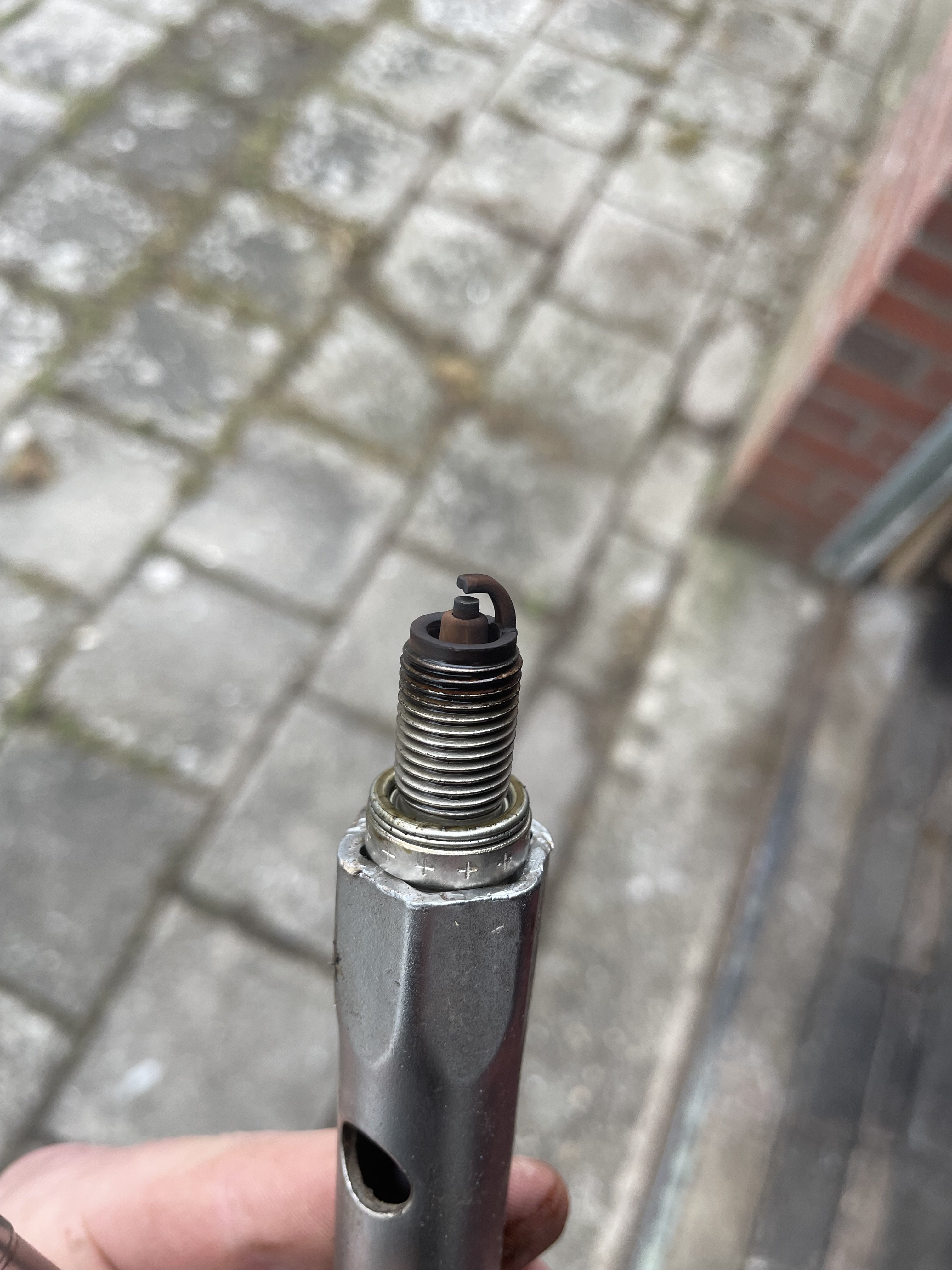

New alternator,ignition coils spark plugs,oil and filter and air filter,special LPG spark plugs. On top of that brand new catalytic converter. The plugs were last resort , while pulling out old ones I snap these pictures. Obviously ,third one is a bit oily and probably new valve stem seals are necessary, note there is no blue smoke coming out of exhaust , anyways what are opinions of you guys? I'm not a pro on reading spark plugs
