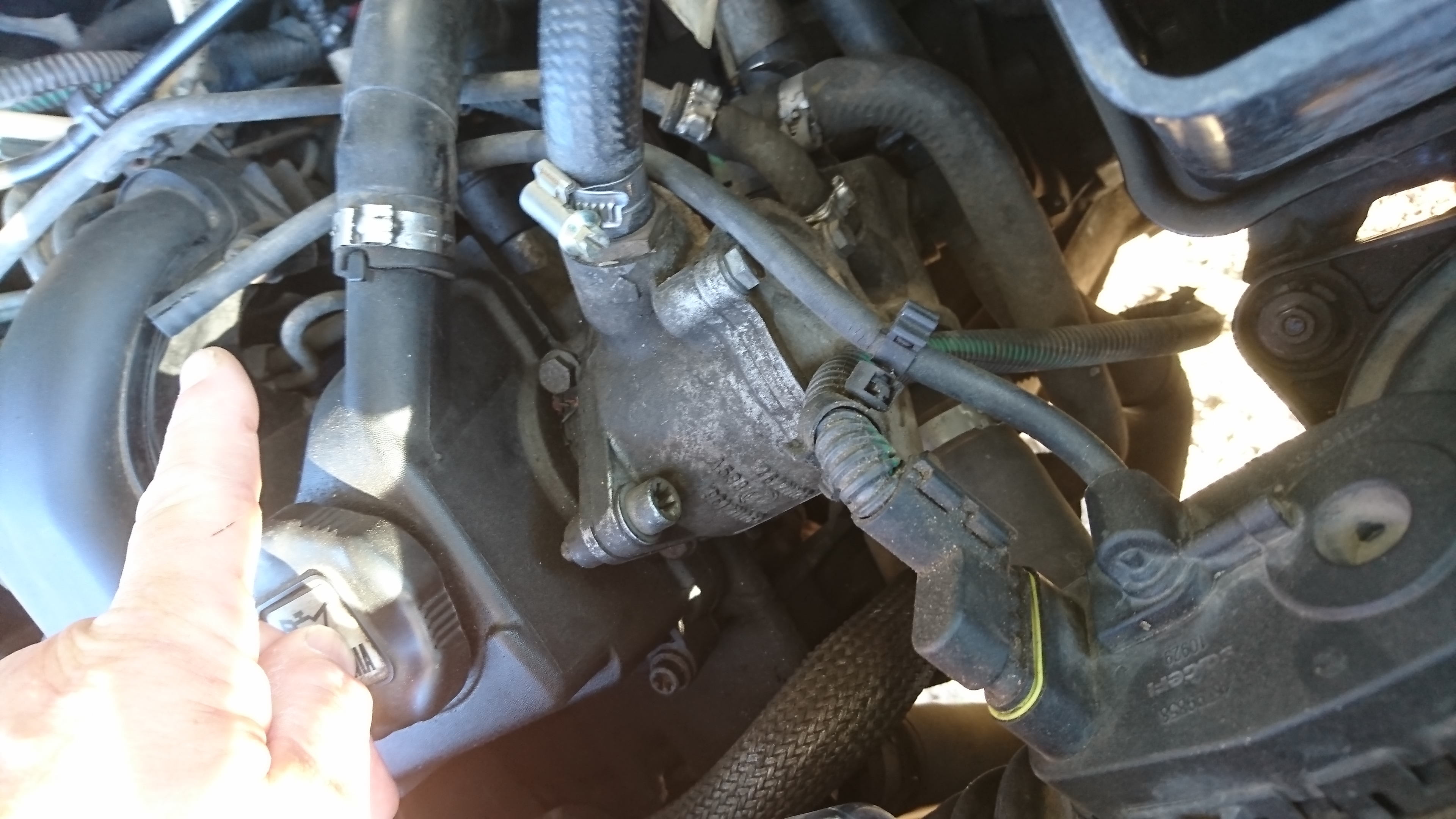

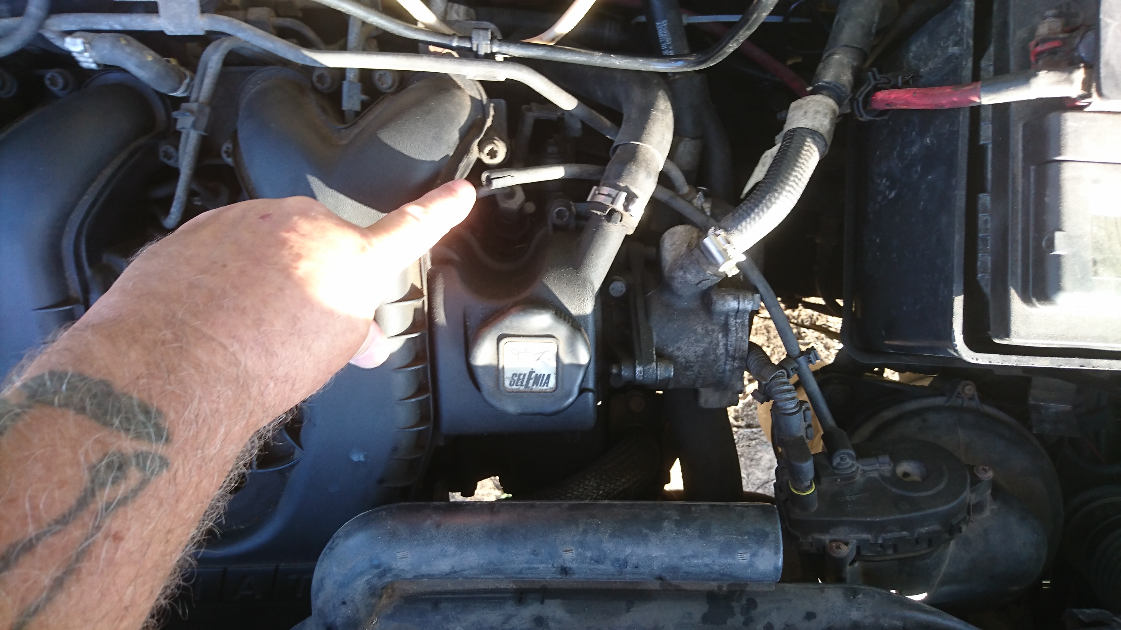

This tube, which I hope is visible in the photos, runs from the top of the air filter housing, the MAF sensor and looks as though it should connect somewhere with the inlet manifold but I cannot find where it should attach :bang:
Any ideas?

Looks like a vacuum line,
Not sure what the device is with the yellow electrical plug..?
But the other end Is probably on a stub under the airbox,
500 petrol cars are always having these sheared off
