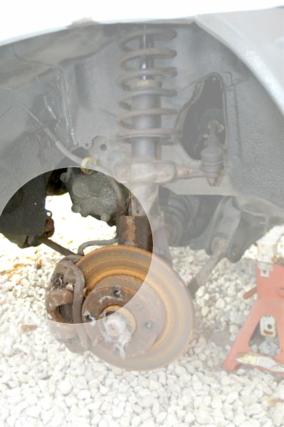

It's the tie/bar dealers call then strut? they are about £20 from the motorfactors. Thety are very easty to replace BUT you have to ensure you put the correct ammount of washers back as they position the wheel.

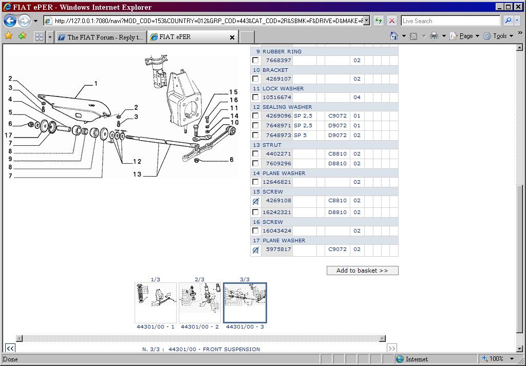

The only thing it can be is the steering tie bar as Alan points out. Installed it's this thing in the picture.
Like Alan says, not sure why it got removed. Problem now is getting one before Tuesday.
You will need to fit it before you drive the car to have the tracking and wheel position checked at a garage.

The reason i was removing it, is because the bullbars attatch to the component part marked number 1 on your diagram. This part on my car doesnt have the welded-on bracket for attatching the bullbars, but the bullbars came with component part #1, with this bracket. So i had to swap them over, removing the 3 bolts that hold it to the chassis, and the one bolt (that never came undone) that held part#1 to the tie rod bar.

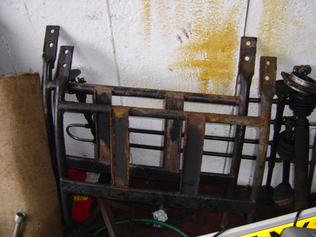

My Panda is a Panda "parade" K-reg. Not a 4x4. Have taken a photo of the bullbars to show what i mean...
Ah! now, I see those are 4x4 suspension/tiebar units that the guard is attached to, they have an extra piece of metal accross them with the screw holes that the sump gaurd and bullbars bolt into.
Thats what i was trying to describe. Didn't describe it very well! My last panda had these extra metal plates allready fitted, which wouldve made fitting the bullbars hugely easier. Damnit.
