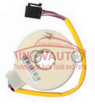

Just to clarify the points raised re the Torque / Position sensor on the Punto Mk2.
Contrary to popular belief, the torque / position sensor can be both bought seperately, AND, swapped over by a person reasonably competent in mechanical / electrical work, and, with a copy of MES for final setup.
There is no mystery to it. Just a steady and careful approach and no big hammers (y)
Here are a couple of pics, one of the sensor housing and the other of the torque / position sensor.
I am personally not convinced about the quality of some of the sensors used in so called remanufactured units in the UK so I would avoid them (that is purely MHO !). The sensor in the picture is a damn good quality unit easily equalling or surpassing the OEM. I have used quite a few of these.
The EPS is a fairly simple system in reality.
Price for torque / position sensor is around £60.
Enjoy.
Enjoy.
