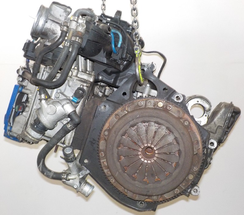

Hello, good morning,
My HGT has a leaking water hose.
I want to get a replacement, but I am having difficulty to identify the hose on the Fiat EPER.
It is this one:
It’s the hose that connects here:
I would really appreciate the help so I can order it.
Thank you.
Regards!
I spent quite a bit of time trying to find a picture of your engine and the part you wanted. It seems there are two different pipes on the front of the engine and Eper is very unclear about one of those pipes.
The simplest way to solve the problem is to cut out the damaged part of the hose and buy a connector and cut a part from any available in stock hose that goes on the pipe. Auto cooling Connectors by Gates come in different sizes and are fairly cheap so whatever the shape of the hose you can most likely repair it using available connectors and pipes to last forever.
