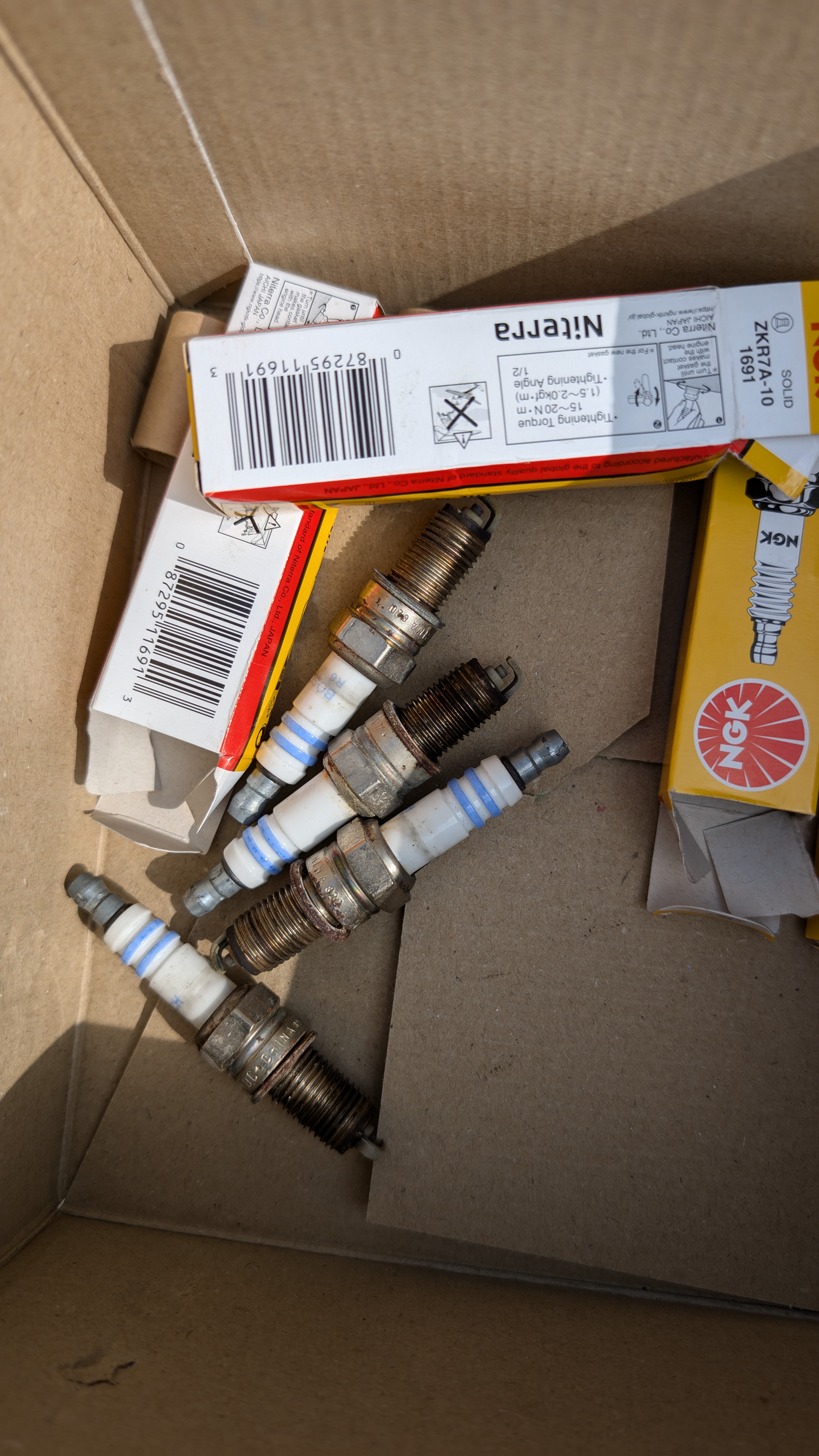

I've bought a new coil pack and a quad of sparks and based on YouTube I might just do it myself, doesn't look hard at all!
If you've not done spark plugs before, just a couple of suggestions:
Get the new plugs seated and start screwing in by hand before tightening with tools. The plugs sit quite deep at the back of the engine and can be a bit fiddly to get started. But be patient - you don't want a cross thread here! A good plug wrench or socket can be very useful here.
Avoid the temptation to over-tighten the plugs. Just nipped would be the best expression I think.

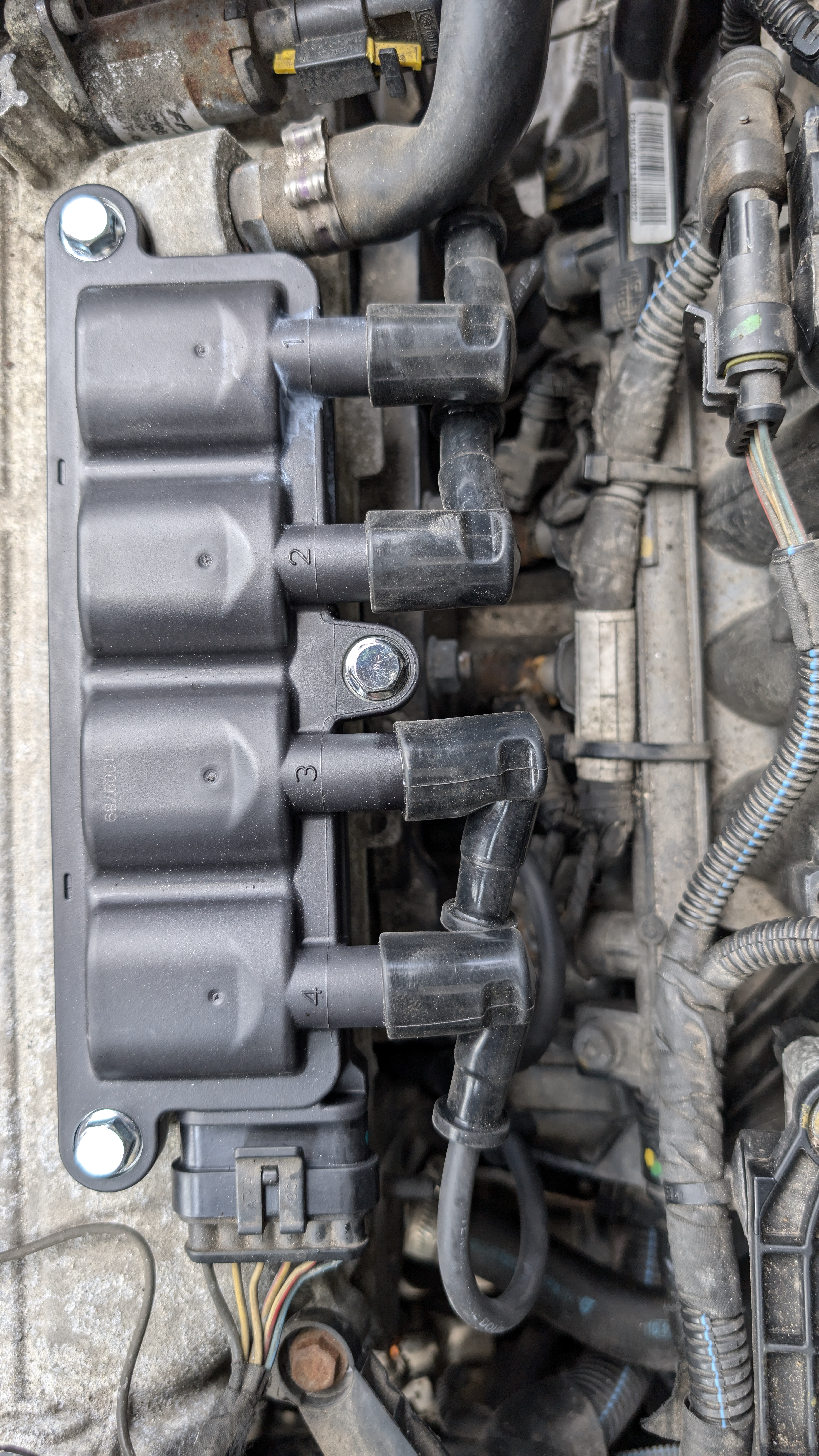

Pack and plugs done, was very easy. I also cleaned the throttle body and replaced the air filter.
I gave up trying to replace the cabin filter however!
Codes have all gone and hopefully won't come back. I've been driving like I stole it today to see if it does and so far all good 👍
