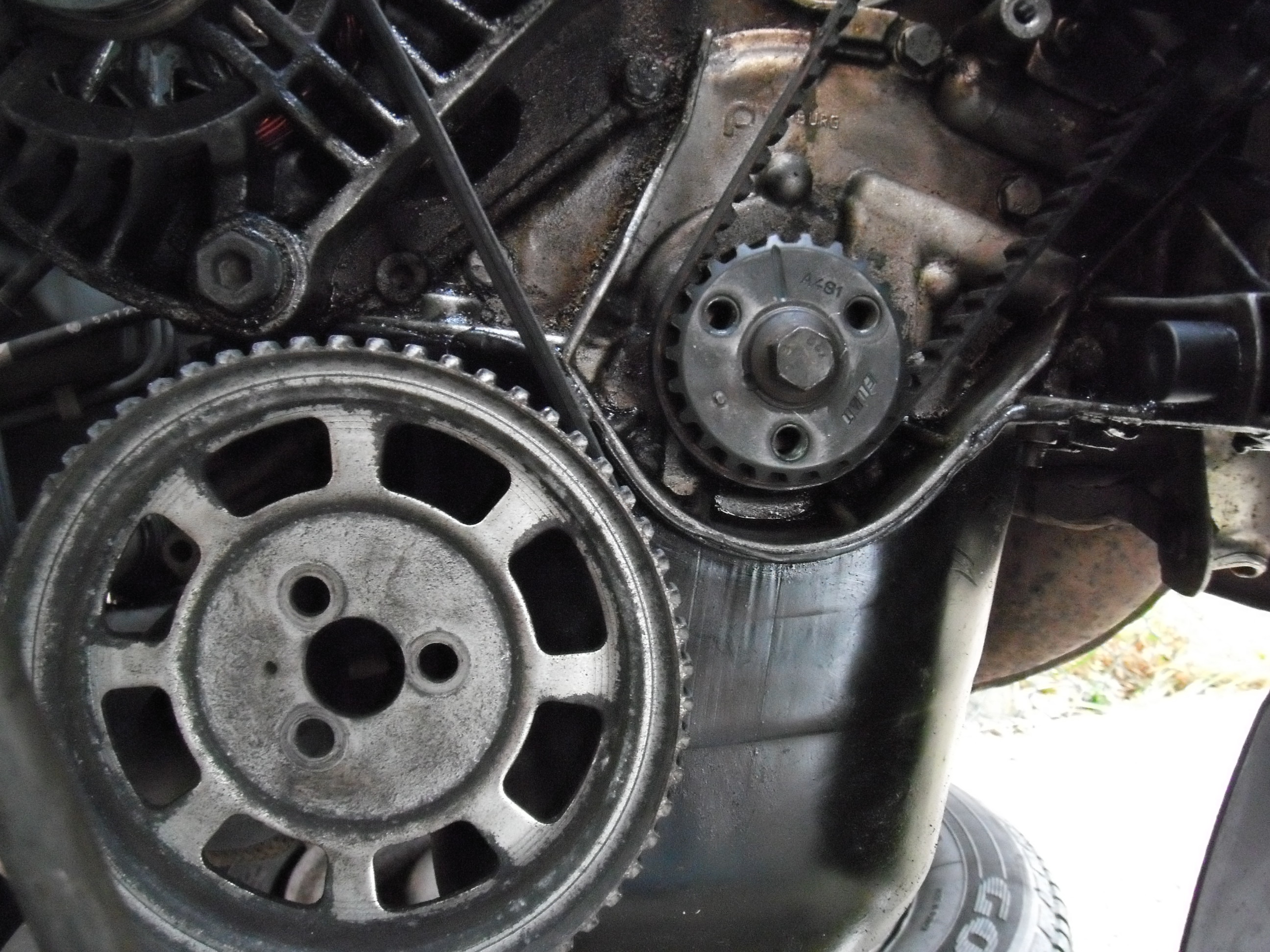

undo @ 4 screws / swing plastic guard out of way to see the crank pulley,

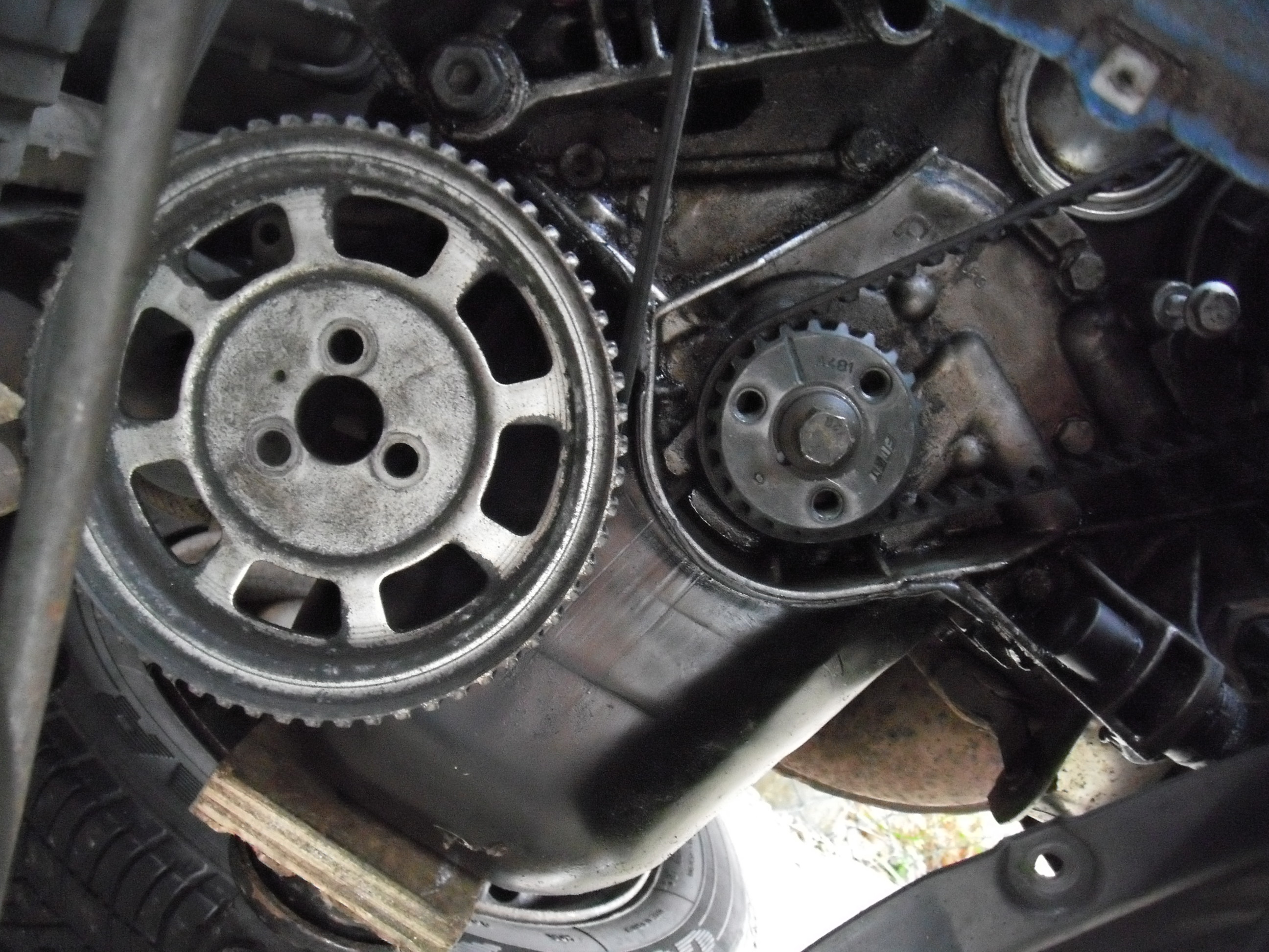

undo the 3 a 13mm headed bolts, - maybe put it in gear 1st,
remove the 3 bolts,

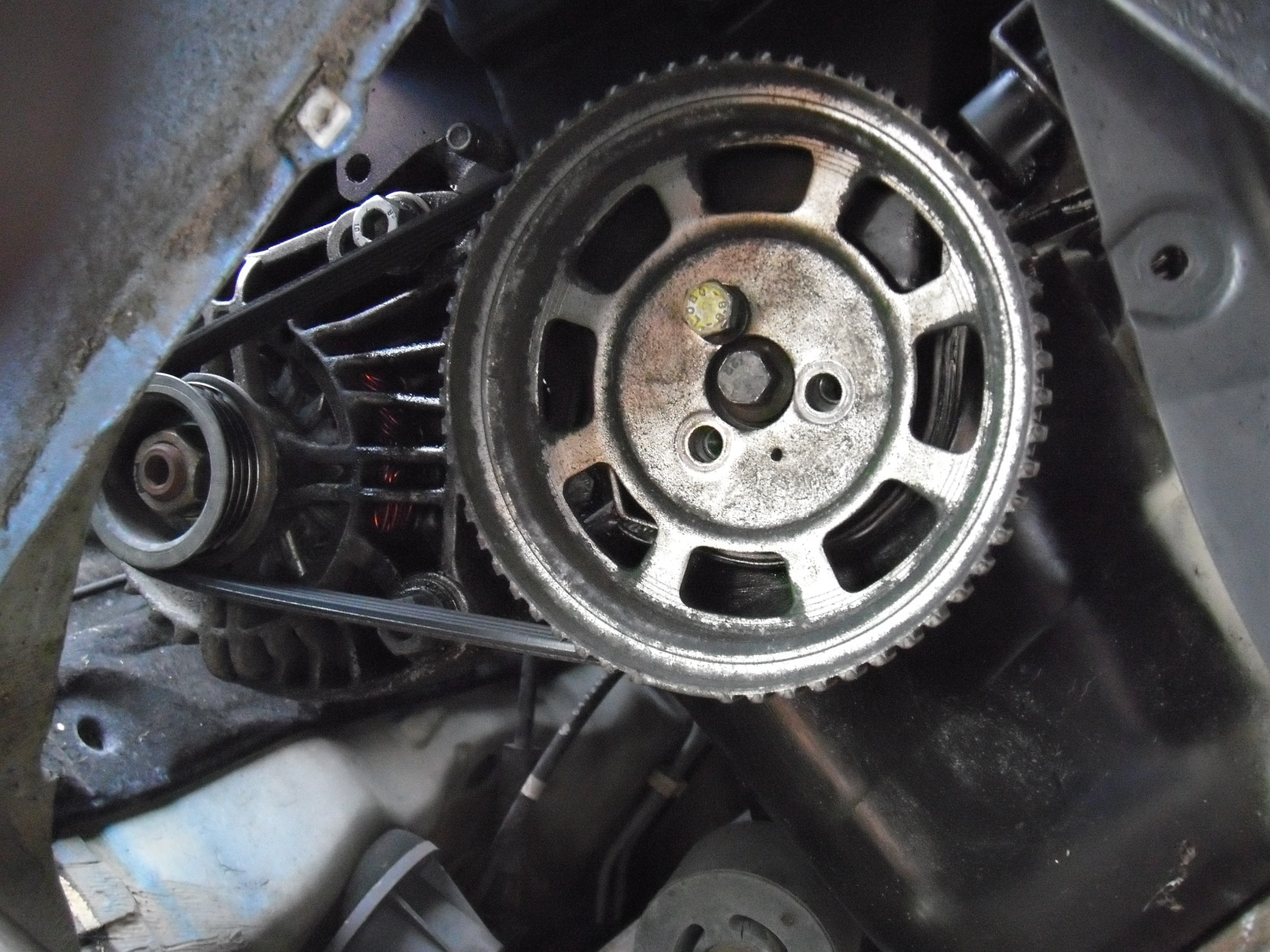

this pulley will now come away..complete with belt,
beware there is a tiny metal "pip" and a corresponding hole.. that sets the engine timing..put it back the same..!!,

if it's the 1100cc FIRE engine,
as you've got the wheel off...,
remove the 3 bolts,

thanks never mentioned its on the 900cc r reg the crank pully is held in by 1 big bolt on mine not 3 little 1.s i a havent got a socket big enough for this and b havent got a spanner shifter big enough if i do manage to get this fly wheel off is it the same it has to go bakc on in a persific place? cheers
the alternator is loosen on both bolt ready to put tension on the belt but the sensor is in the way of the belt going on anything i do is never as simples as it should be theres allways 1 think that stops it holts progression until it get wacked with a hammer till it works or its nackerd lol thats why am not a mechanice and i just fix bits of steel together as a scaffolder lol cheers for you help charlie
