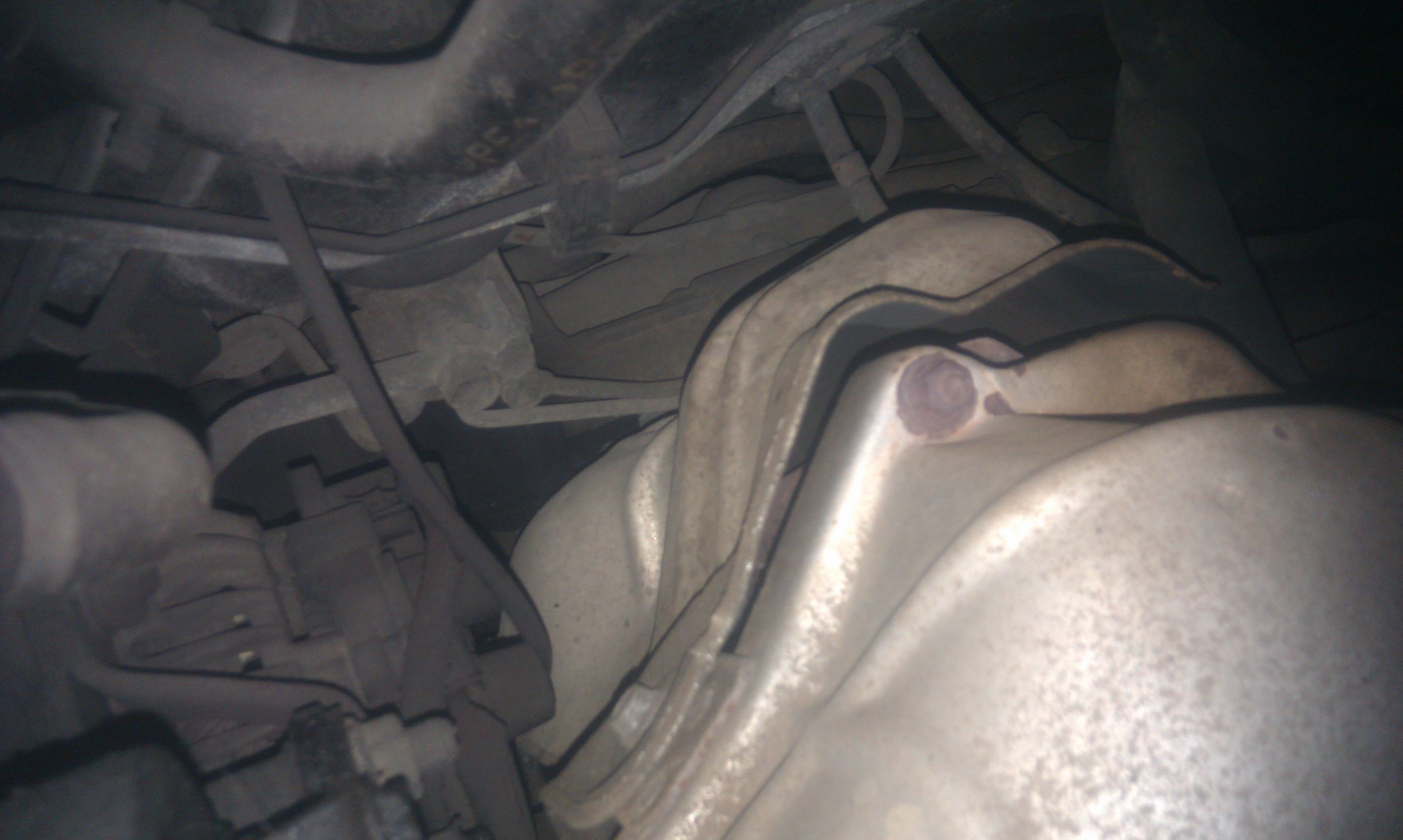

I had the bonnet open whilst it was running and noticed a bit of smoke coming from the back of the engine when looking at it from the front.
Had a bit of a look around and have noticed what I thought was the exhaust down pipe had come away from the engine.
After looking on ebay i now dont think it is the down pipe as they dont look the same.
I have attached a picture which I hope will explain better than I can!!
If anyone can tell me if I am right in thinking it is the downpipe or not, if not what is it, how muchwill it cost to fix, will it be fixable by me (A novice) or will it need to go into the garage!!

Hello,
Its a little hard to tell from the picture, but that looks like the heat shield covering both the cat and the manifold beneath it.
If that is all of your issues then you-re fine, but more likely its a cracked manifold beneath it or the joint on the cat connecting the cat to the manifold that is cracked.
Both are very common issues on multiplas (well at least on the two i've owned).
The heat shield is quite easy to remove, 3 screws on the top and one underneath. Its a bugger to completely remove though, so just for checking, it can be bent back over the lamda sensor in the middle of the heat shield. Once done, you can check the manifold and cat for cracks with a mirror. NOTE, dissconnect the battery, as the heat shield will very likely short on the alternator otherwise.
Both parts are expensive to replace and a major hassle too.
Once you've located the crack, use some 'Themosteel' to patch up the hole, this stuff is the ONLY substance that can handle to high temps and while by no means perfect it is vastly cheaper than the alternative.
