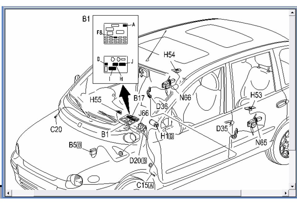

There are only two 25A fuses on the 'loose' fuse holders, so it may be worth checking if either of these has blown. Also, if you press the rear window 'lock' button, can you hear a relay clicking in and out ?
The following pictures off the CD may help you (more than they help me). At least the electrical circuit is clear.
