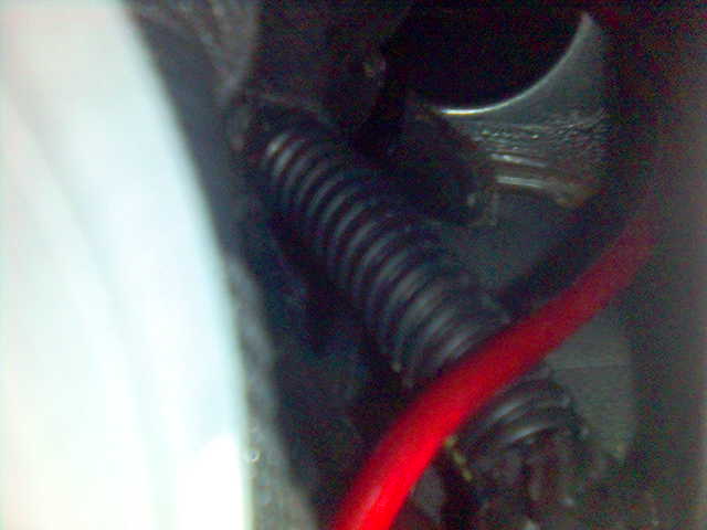

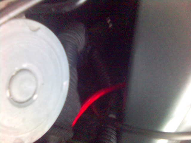

my sub and pic of hole where wires run from the engine into the car

hiya chromegrey i notice from your pics you only have the red power lead where did you run the earth to ?
