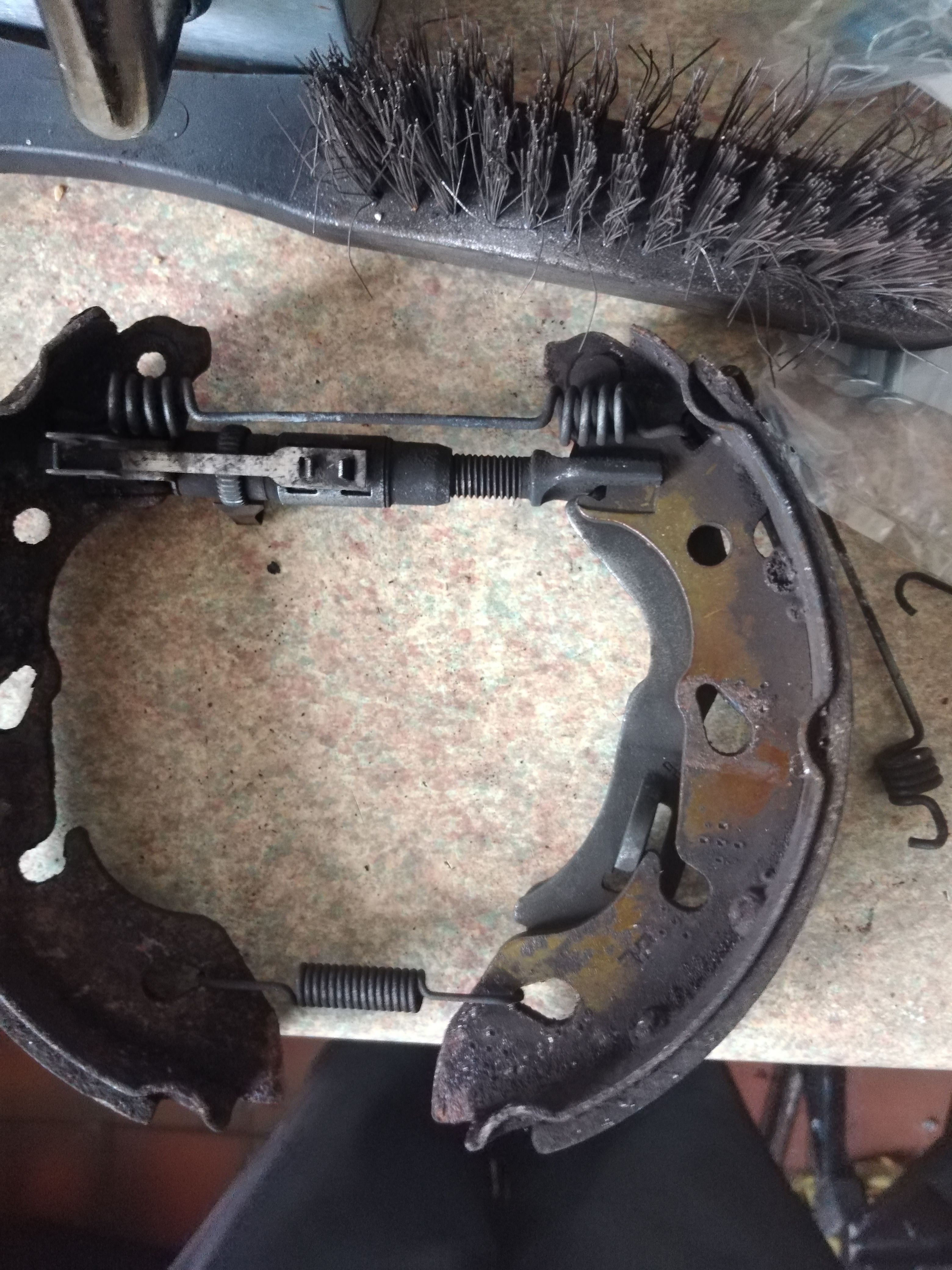

I am not sure what you are asking
I have already posted how the springs and adjusters fit
And how to test the ajuster
And how to test the bimetallic strip
The drawing from elearn you were sent shows the Adjuster upside down. Drawing and photo in post two are correct way round to how my was originally,
The Bosch system is completely different
Thank you for the videos the problem is clear now my adjuster is knackered.
Can anyone confirm that 77362444 is the correct part number for the adjuster?

The other link I posted from the fiat parts lookup lists it for the panda among many other models. Apparently Peugeot Citroen and other companies use the same one
