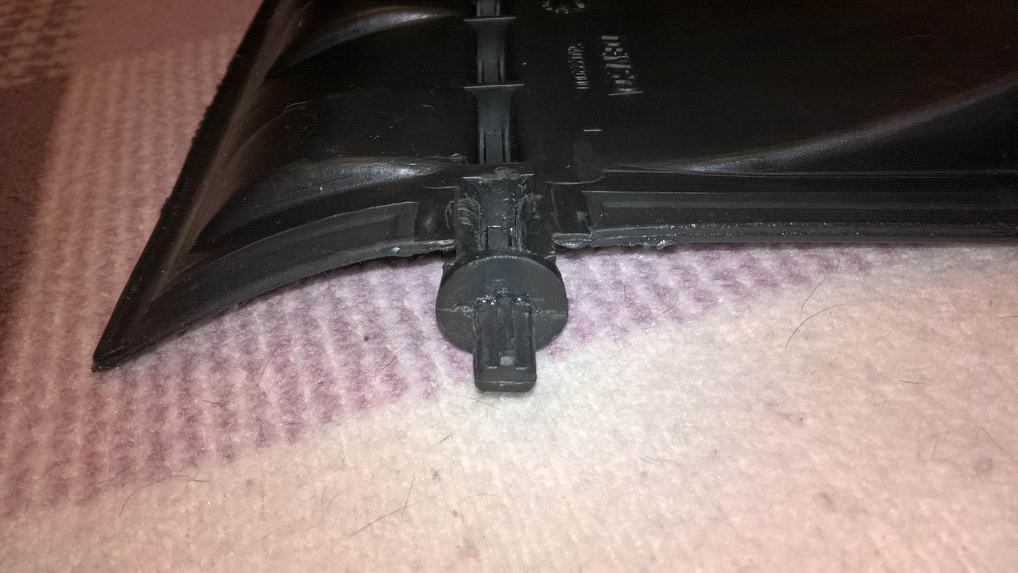

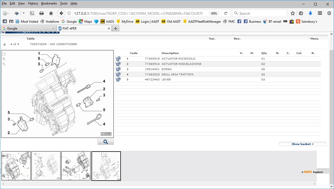

I have the dreaded broken actuator door problem - I have stripped the heater unit out. Doors off dash out etc. And the heater unit is on the bench. My problem is I cannot source a replacement. Fiat dealer has told me my part number is 735305615. Today I found a donor vehicle that is the same 08 reg, climate control (same) but 1.4 sport. Mine is 1.2 Lounge Pop. I checked with a dealer and he said the part number in this vehicle is 735372654.
The dealer also said they changed things heater wise in 2008 ( I assume cause the original ones all have the same fault)
Is there anyone who can suggest how inter changeable the units are or do I need an exact DNA match.
