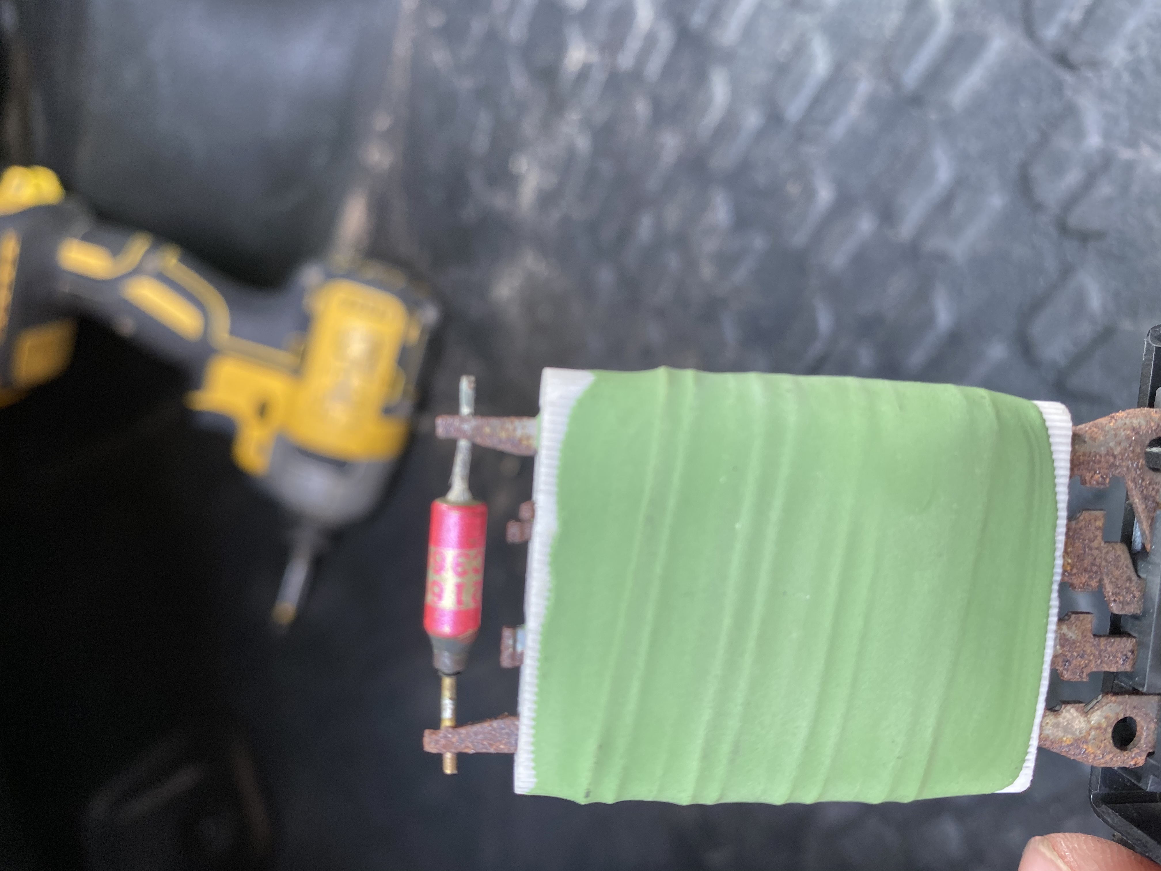

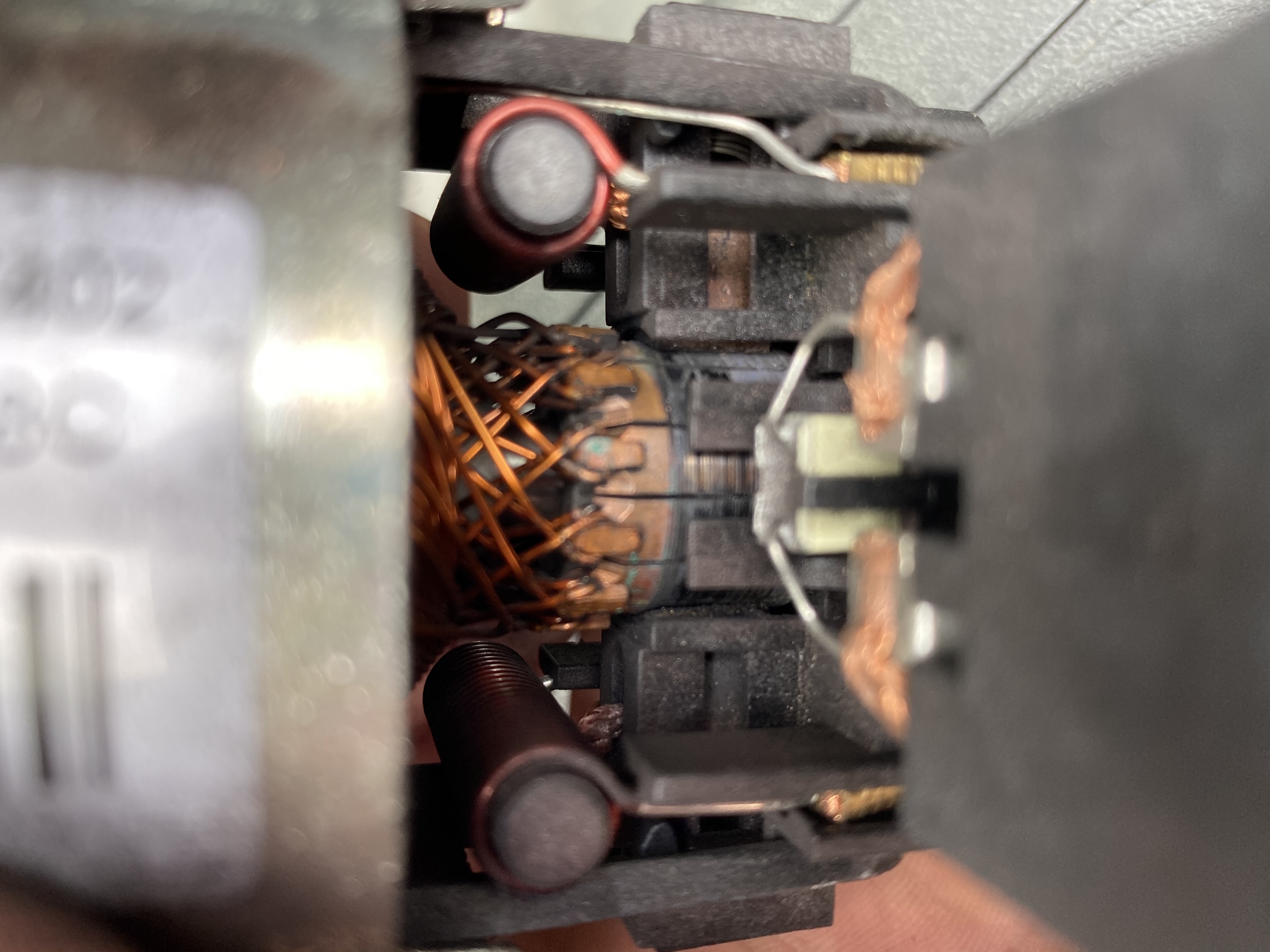

Okay so took out resistor pack under glove box in the air duct and does this look gone I’m going to order new part checked motor and brushes look okay have attached pictures so I suppose replace resistor first then motor second?

Favourite filure is the wiring at the plug for resistor .. give it a wiggle.. see if you get any power
I have removed fan unit and give fan 12volts of battery.. thats the simple test really.. but a 12v meter is also good
3.6.9 and 12 volts to the fan terminals if resistor circuit is good ;)

On several VWs i owned regularly the resistors were shot. Replacing them with more heat resistant types usually solved the problem.
The fan itself usually runs slower while it is stinking before really giving up.

Well just dropped motor and cleaned commutator and now works perfectly
