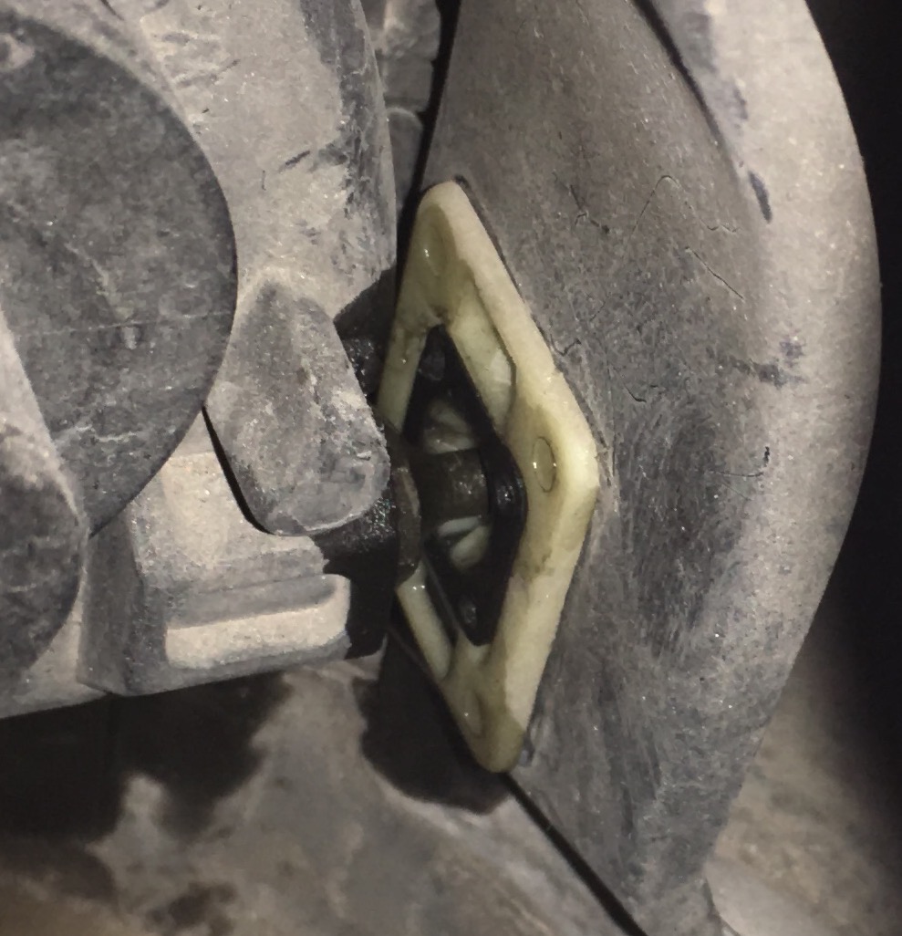

F Fiatbravo182 New member Joined Dec 23, 2017 Messages 3 Points 1 Dec 23, 2017 #1 Hello. How I can pull out this metallic ball end from the car? Thanks Attachments IMG_0127.JPG 198.5 KB · Views: 186

OP OP F Fiatbravo182 New member Joined Dec 23, 2017 Messages 3 Points 1 Dec 25, 2017 #3 Hello, thanks for your answer, it seems i can't pull it out i tried with all my strength i'm afraid i might break it..

N Neverth Established member Joined Jan 18, 2012 Messages 665 Points 201 Dec 26, 2017 #4 I just bang the headlight with my hand on the indicator until it pops off. The impact usually pops it off easier than just pulling it.

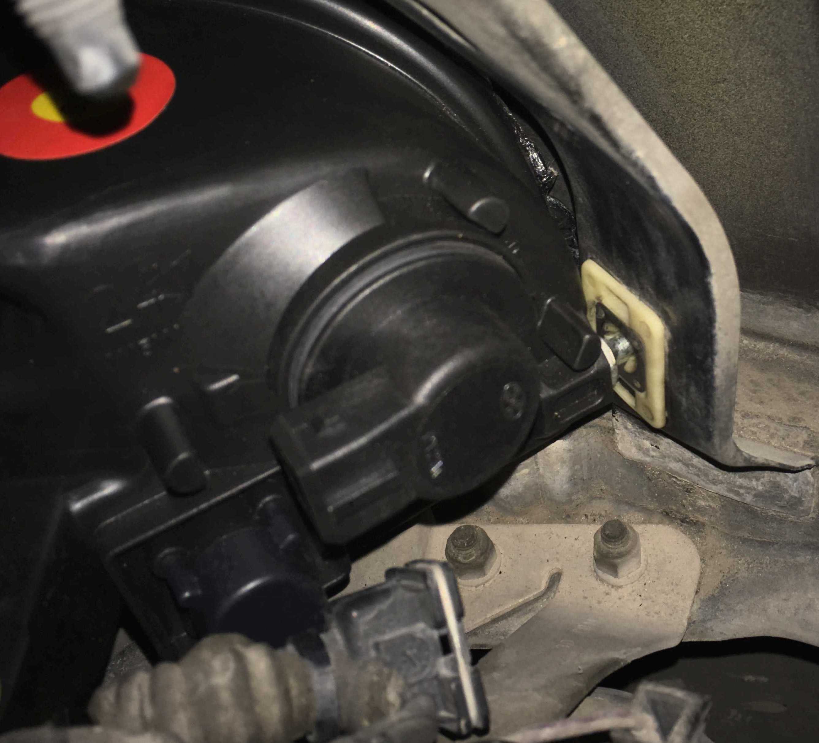

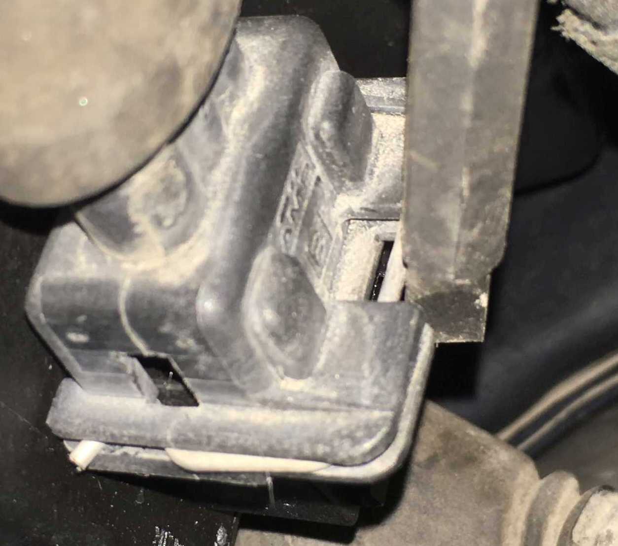

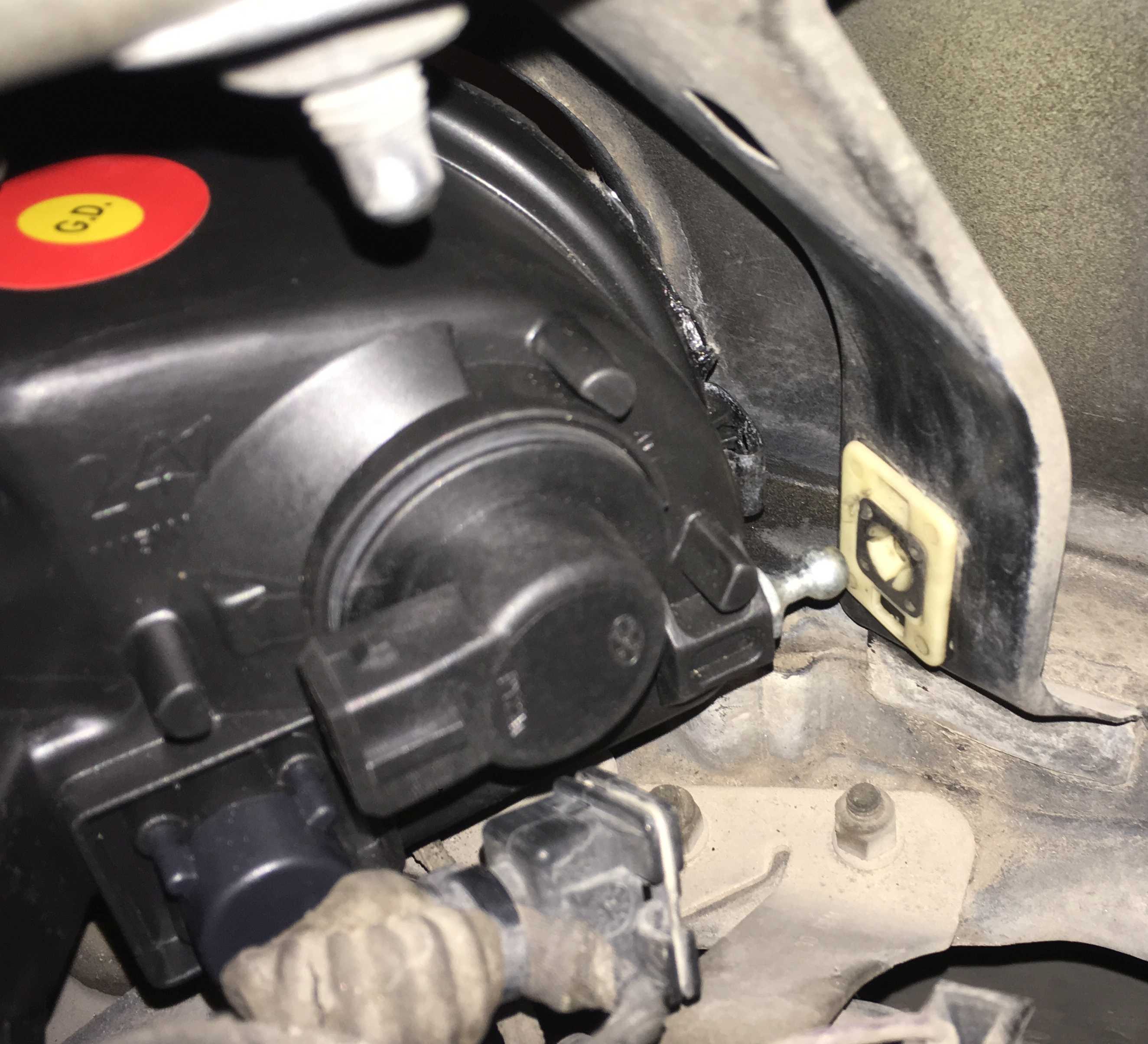

OP OP F Fiatbravo182 New member Joined Dec 23, 2017 Messages 3 Points 1 Dec 26, 2017 #5 A few mm space for impact but after a few tries i heard a sharp snap sound, and the unit was removed. Thank you both.. Attachments IMG_0168.JPG 331.8 KB · Views: 127 IMG_0171.JPG 247.9 KB · Views: 128 IMG_0172.JPG 86.7 KB · Views: 165
