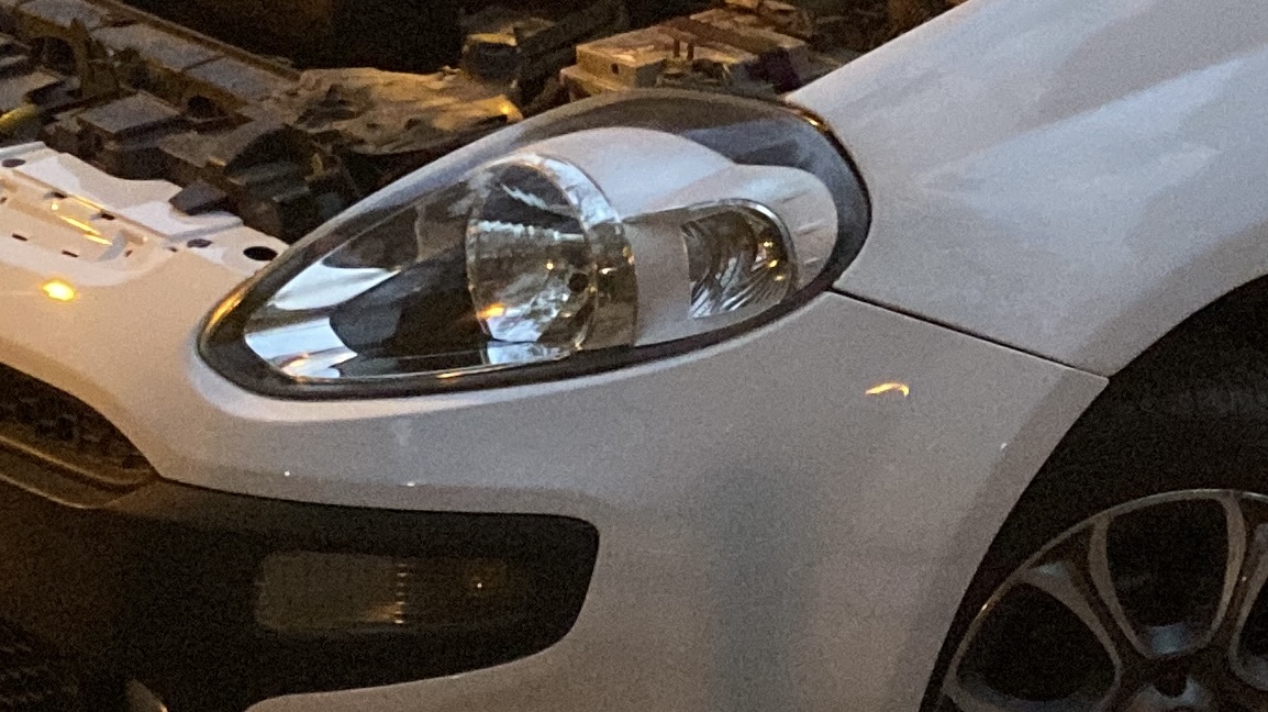

Hi guys. I just switched my headlighs after a small incident. After changing I have a problem with headlight switch. If I switch it on 0 headlights are on, if I switch it on they stay off, if I switch it on position lights they work. Anyone knows how to solve this problem? Thanks in advance

Yes it’s the 3 position switch. Everything worked well until changing headlamps, I don’t think it’s the switch itself
I’ve had this type of headlight before and I switched to this
I’d suggest that the wiring between the two headlamps differs and your option is to either fit the headlight with the right wiring or reconfigure the wiring plug in the new headlight.
