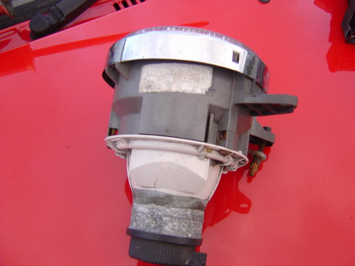

As said previously the BMW has a simmilar elipsoid headlight that has three screws between the grey and white part of the light that you loosten & turn to change the LH to RH setting. I'm supprised the Barchetta lights aren't the same.
