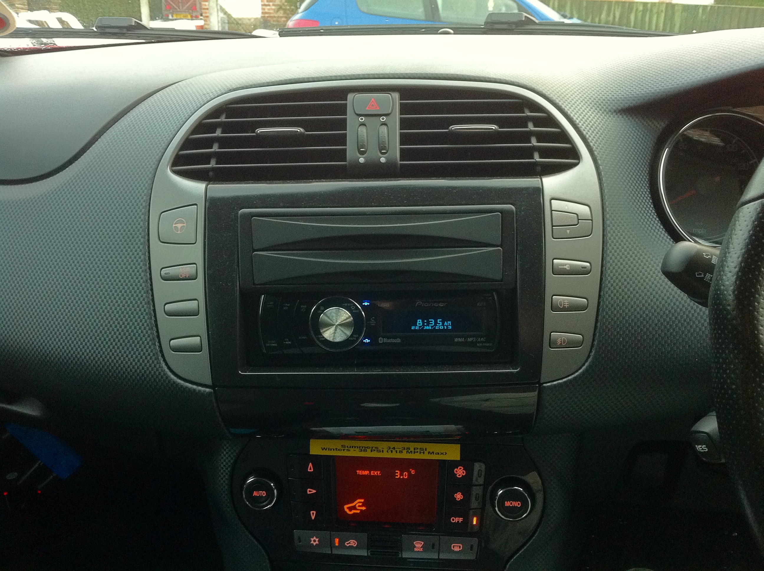

I've removed my origional head unit, and the B&M ECU (leaving me a nice discreet place to stow my iPod Classic).
I've a top end Pioneer headunit fitted, all steering wheel controls work with the exception of the Microsoft and Phone buttons which is understandable :)
Not looked back since doing it.

Pic as requested

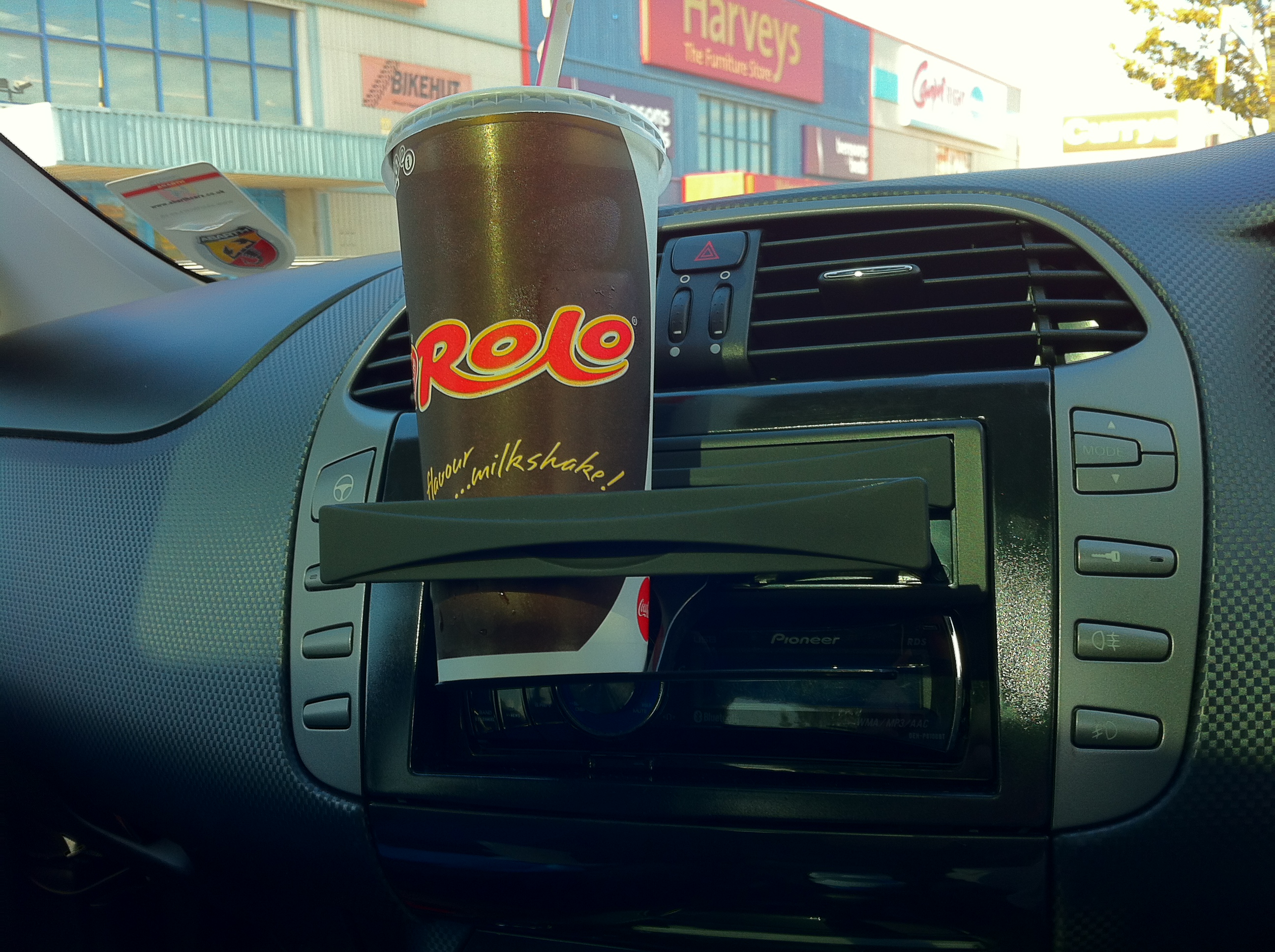

Any my Bigger and Better Cup Holder :D
