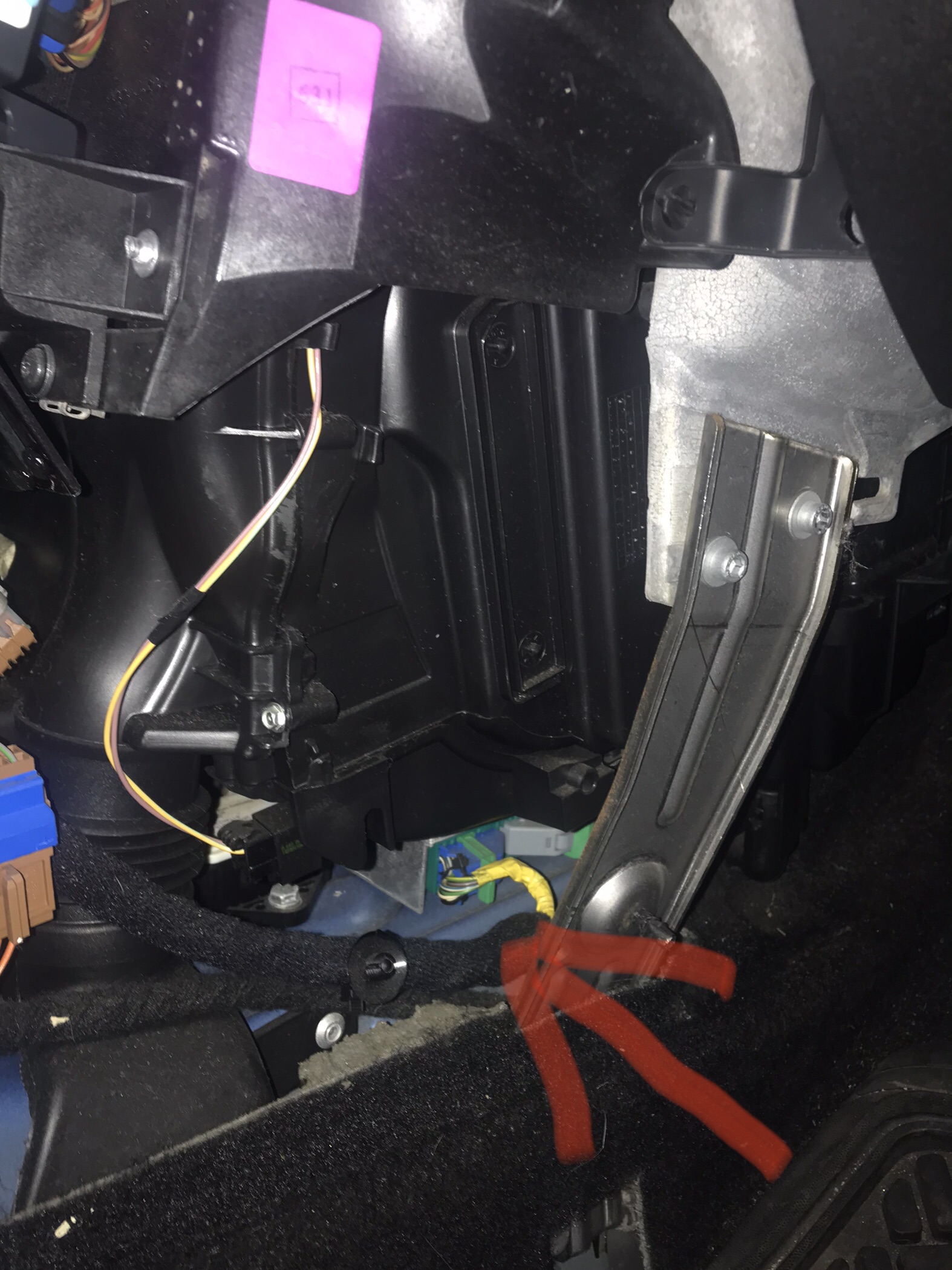

Just happened to mine. Exactly the same issue. Airbag control unit fried.
Located under the air condition unit above tunnel next to footwell.
Thanks for your reply. Yes that read out looks exactly the same as mine. Did you have to remove the whole centre console to get to the air condition control unit? I did that once before for another issue and I remember it being a bit of a nightmare and taking quite a long time :eek:
Did you repair yours or take it to a garage for repair?
Garage diagnosed the problem. But yes unfortunately you have to remove the plastic console to get to the connector and bolts as it’s attached to the top of the transmission tunnel. Bitch to get to. I’ll keep you posted as mine is in progress. Happened yesterday. Can’t get a ne one so lucky I found one at a breakers yard.
Garage diagnosed the problem. But yes unfortunately you have to remove the plastic console to get to the connector and bolts as it’s attached to the top of the transmission tunnel. Bitch to get foto.
Yeah what a pain. Are you going to fix yours yourself? As this is such a pain to get to I am half tempted to take it to a garage, but have no idea how much something like this would cost.

Takes longer to remove the console. As it’s a big pain in the ( * ) to get to under the heater unit. After the plastics are removed it’s is easy to replace provided you disconnect the battery first and wait 15 minutes before you disconnect it. Then remove 3 bolts that holds it to the car body. Replace is reversal. 30 minute job.
