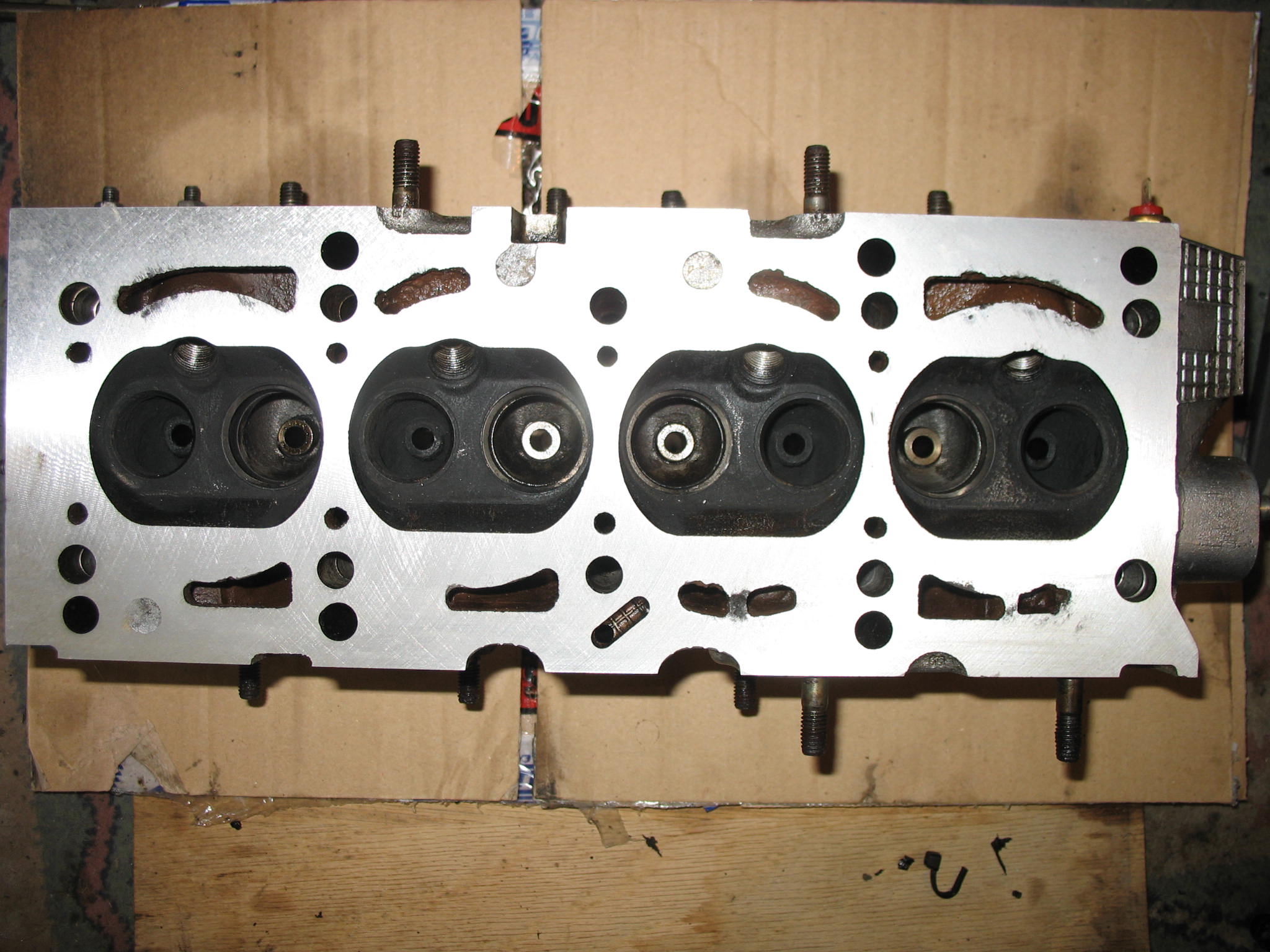

1. Yes, it can be skimmed up to some point.
As you can see thera are some marks, two above intake valve cyl 2 and 3, two below exh valve cyl. 1 and 4.
Cyl 1 mark on my head is gone by now ( second skimming ).
2. I can arrange your head to be skimmed ( 0.3-0.5 of mm ) by the same place and same 40years CNC experience guy who done mine, but no crack test or presure test facility unfortunately.
