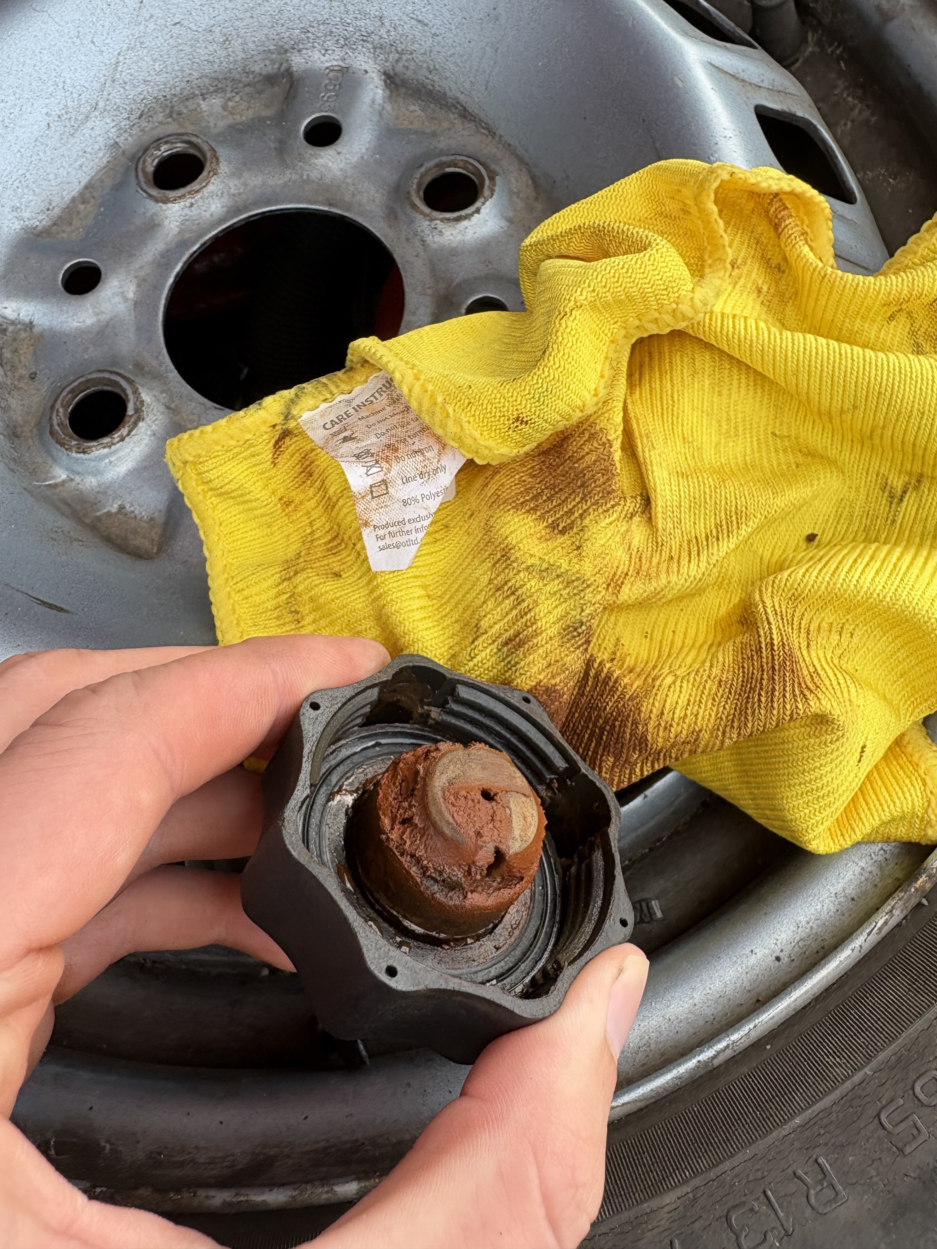

Hi all, I have a feeling that my head gasket has just blown. Car suddenly got very hot, I pulled over and saw that some brown water had sprayed around the vicinity of the radiator cap. The rad is empty, with brown sludge on the cap. Can’t see a sign of a leak anywhere else.
I’ve recently replaced all hoses, radiator, water pump, and thermostat to address a constant loss of water, and since the pump (last thing I did) it’s functioned fine without any obvious leaks. This happened at 60mph with no signs of overheating. Coolant was changed recently.
It has been taking slightly longer to start recently, just a few seconds, so may have been leaking coolant into the cylinders. Is this likely a head gasket?
I can’t see any mayo on the dipstick or the oil cap, just this sludge in the radiator.
I’m stood next to it waiting for assistance, and can hear a glug coming from the radiator every few seconds.
Does sound like it.
Has any rad seal type additive been used?
When coolant changed was all air bled from system?
If the brown sludge is not additive then it could be a long time build up of muck that was blocking the radiator and now has cooked the head gasket.:(

No rad sealant used. Bled it all through when I changed coolant and checked it regularly over the following days to ensure it was fully topped off. Radiator is brand new, as is water pump, hoses, thermostat, so not likely to be old sludge. I’ve been driving it everyday for a few weeks since changing the rad with no issues, including a 7 hour trip each way to Devon.
There doesn't need to be "mayo" on dipstick or in oil cap for head gasket issue.
If coolant has been going down for some time hence the need for all the parts you have changed , there is a very good chance at some point the coolant was so low it couldn't circulate around the engine, at that point it will rapidly overheat and blow the gasket/warp the cylinder head etc.
There are several tests that can be done to show a faulty head gasket issue, from filling the coolant to the brim starting the engine holding revs around 2000 then letting it idle and checking for gas bubbles coming up sometimes smelling of combustion, another test is a tool that sniffs that gas and changes the colour of chrystals due to combustion gas present, another test is a leak test done with more garage equipment which takes longer but is more comprehensive and can show which cylinder the fault lies in etc.

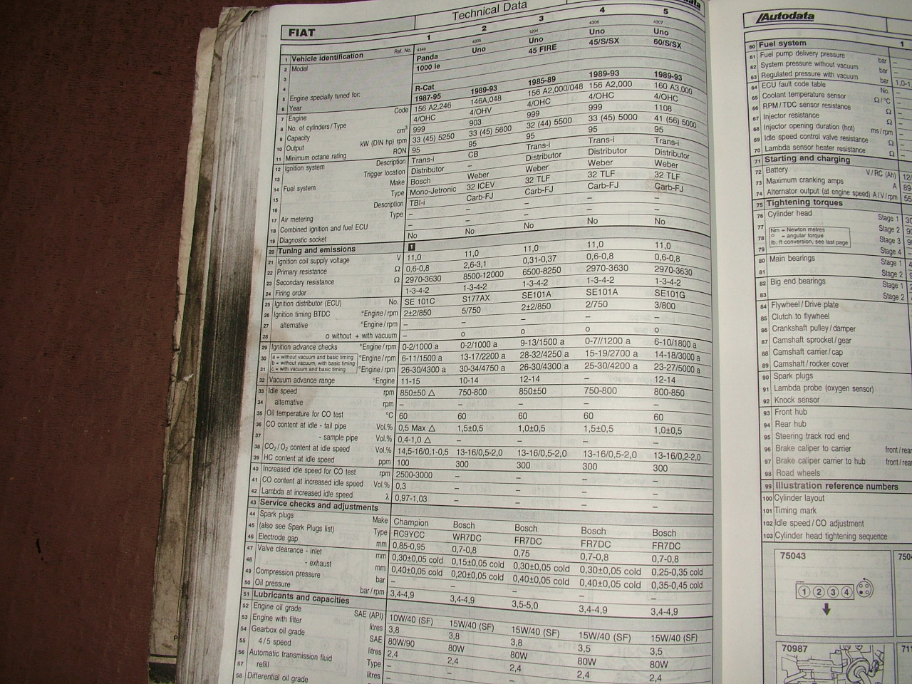

The Engine Series Number should look like one of these so you can check data.

From the looks of this, you tighten the head bolts to 30Nm, then 90 degrees, then another 90 degrees. Annoyingly, my torque wrench starts at 60Nm.
These books are usually fairly accurate as used by the trade, but a good idea to check a different source of information to confirm.
