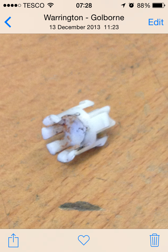

Yes ! It broke at a particularly dangerous time . I have contacted VOSA and they are investigating the part and say that fiat may have to recall the bravo with this clip , the Vosa engineer was horrified
If VOSA really are investigating this (and not just telling you a story e.g. to get you off the line) , presumably the Stilo will be affected too? Lets see what happens.
Update: Fiat are to assess my vehicle and redesign the clutch to master cylinder linkage
For reference the part being reported is this plastic clip found on the master cylinder in which connects to the ball joint on the pedal.
