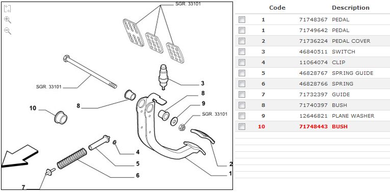

According to the Fiat parts catalogue, some Bravos have the 2 part plastic clip as in the diagram below. Part #5 is a rectangular plastic clip and part #6 is a plastic cup that fits inside the clip. The part numbers for parts 5 and 6 are the same as for the Stilo and are available seperately from a dealer.
There's a long thread about it in Stilo section of the forum here: https://www.fiatforum.com/stilo/14491-clutch-pedal-click-clunk-squeak.html
There's a photograph of the clip and cup in post #68 of that thread.
[/ATTACH]

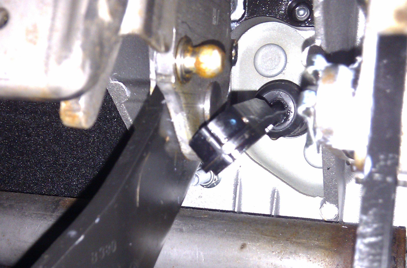

Here are some pictures of the white clip which dosen't look broken on the picture. The other picture the clip goes into the black plastic thing then connects to the ball joint.
Its an 07 bravo 1.9 multijet dynamic 120bhp. hydraulic clutch. Im looking everywhere for the info. if anybody can help or have an idea I would realy appreciate it, Thanks.:confused:
Yours is obviously not the same as the diagram I posted above.
The diagram below shows the alternative Bravo set up. Doesn't show the white clip seperately though. Perhaps the dealer is right and it's only available with the master cylinder.
The other diagram below is from the eLEARN workshop manual. Doesn't say anything about a removable clip.
Does your white clip fit in the black plastic part securely?
Yes the white clip fits securely in the plastic thing but when i then put it onto the ball joint the white clip is loose and worn. Ive tried all ways to put the clip back on but it won't hold I need a new clip. Everything else is working fine on the clutch. I have also asked a random owner if i can look at there car 1.9 mulitjet exactly the same white clip, Heres a picture of what it looks like working properly.[/ATTACH]

Tkaye, did you also notice the fluid? It looks to be dripping out of your master cylinder in this picture. You can see it pooled up around the bottom of the rubber boot.
I do not like that setup at all. If it was made from good quality components I think it would be up to the task, but all that looks really cheap.
A propper rose joint like this with a bolt going through would have been better.
It looks like its leaking but it is actually grease. There is no liquid below. yea i agree with you it would of been alot better with a bolt going through. I was thinking of doing somthing myself bodge job but Im going to see if i can find the clips form the breakers yards first. If i can't then ill just have to give it to fiat and pay up. just for a little clip.:(
