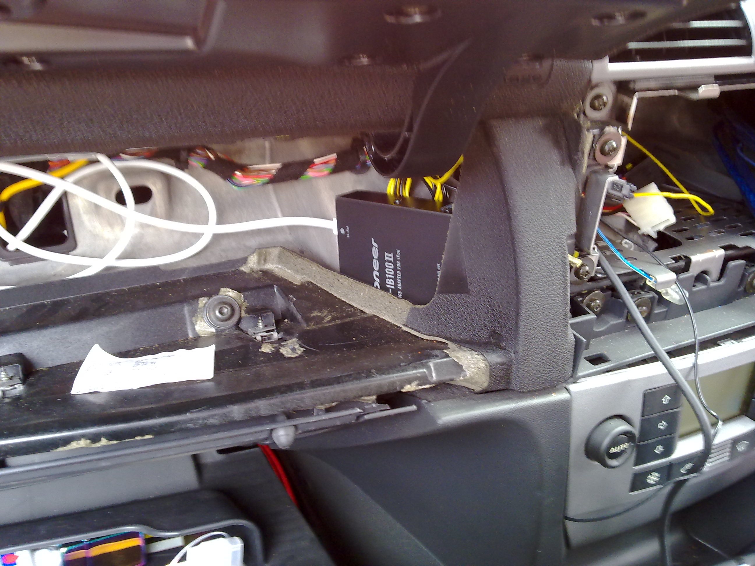

Perfect Stu, Thanks.
As its for your iPod where does the cable exit your dash, the part that connects to your iPod?
I'd like to fit a 3.5mm jack and some phono's neatly somewhere so I can plug whatever I want into it, any suggestions where and how I could do this?
I keep the pod in the gllove box. If you look at the ceiling of it there is an access piece that pulls open. You can just put the wire through there and close it back up.
Or drill a hole through the upper glove box bit and fabricate a dock into the flocked bitl Thats what i plan to do eventually with a hardwired 12v charging station. I want spare Phone batteries, ipods for each genre i listen to etc in there.
Mount it in the upper glove box. There is loads of room behind there to have it flush mounted in the tray.
