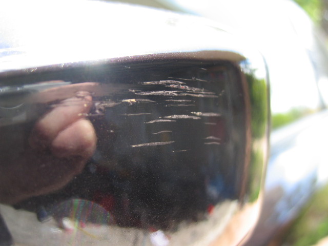

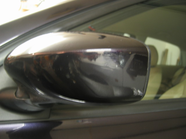

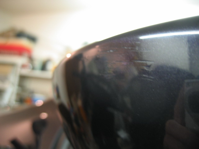

In contrast, I've attached a photo of my Stilo's left mirror as I got it, I touched it up quickly a few months ago, and the other photos are taken just a couple of minutes ago. Lighting conditions are not the same, but I think the scratches are less noticable (I had to be careful with the angles to highlight them). Dark metallic purple must be the very worst colour to work with
If I'd spent a bit longer (over several days) to properly fill-in the scratches with touch-up paint (they were quite deep, fingernail-snagging) then it would look better, but in the meantime I'm happy enough. My feeling is that it took about fifteen minutes to get this result, versus probably four hours split over two days to remove/prepare/repaint/re-clear the mirror shell - and that can still be done later if there is further damage while in my care
