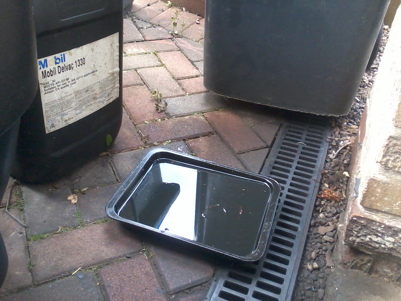

Heading down to Crofts 'nostalgia day' today, thought it would be a good excuse to roll Grumbleweed off the drive for a bit of a run out. Reversed him back and spotted the 'drip' tray I put under the gearbox:
.....rolled him back down, took the Pug.:(
Really need to get the good gearbox back on.
2 weeks. It doesn't look like a simple fix either. Not a single leak, just seems to be oozing gently from everywhere on the gearbox, seam at the bellhousing, speedo cable, inner cv boot bearings & flanges. Think because the box has been lying unused for over a decade anywhere there's supposed to be a seal has just dried out & deteriorated. The old Y10 box is all cleaned up & painted now, just need to get my backside into gear & get it back in. Remarkably the only bit that seemed to be showing wear when it came out was the clutch release bearing. Otherwise it seems pretty tight.

Just the box. All done, mega mileage box back in situ with a fresh coat of black paint and the new clutch I put in with the stupid crunchy leaky box and wow! No crunchy, no leaky (so far), no noisy. I should never have taken it out. (well, cluch release bearing was rumbling but should have put it back in anyway))
Looking at the box that came out it looks like the majority of the leakage was the gasket round the middle so to cure it the box has to open right up:(
Changed the troublesome top radiator hose for new too so hopefully that's the coolant leak sorted too.
OK, much shouting & threatening later (honestly, how hard can it be to get the 3 bolts off & on again on the O/S driveshaft inner gaitor!!!) & some bodgery with the speedo drive (rebuilding the oil seal with silicon) it's looking like no more leaks! Finally!

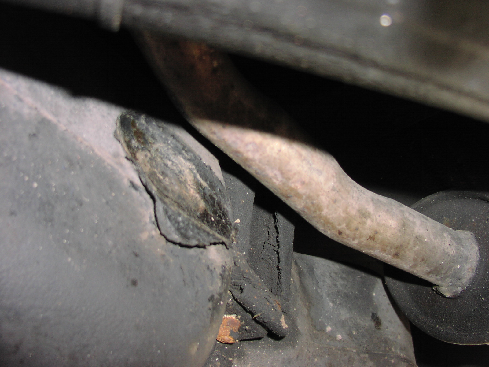

You know when you go under the car to investigate that knock that's been there all winter... Well, I'd figured out that an exhaust rubber had given up the ghost so bought one last week and finally got round to grovelling under Grumbleweed today to sort it out and realised actually two rubbers had let go, leaving my exhaust supported by just the outer one at the rear.
...and the fuel tank:eek:
..Fortunately got to it before it melted right through but that could have been interesting. Exhaust's supported back off it now but I think it's twisted round at the centre joint a bit so I'll have to take it apart again at some point and straighten it all up.
