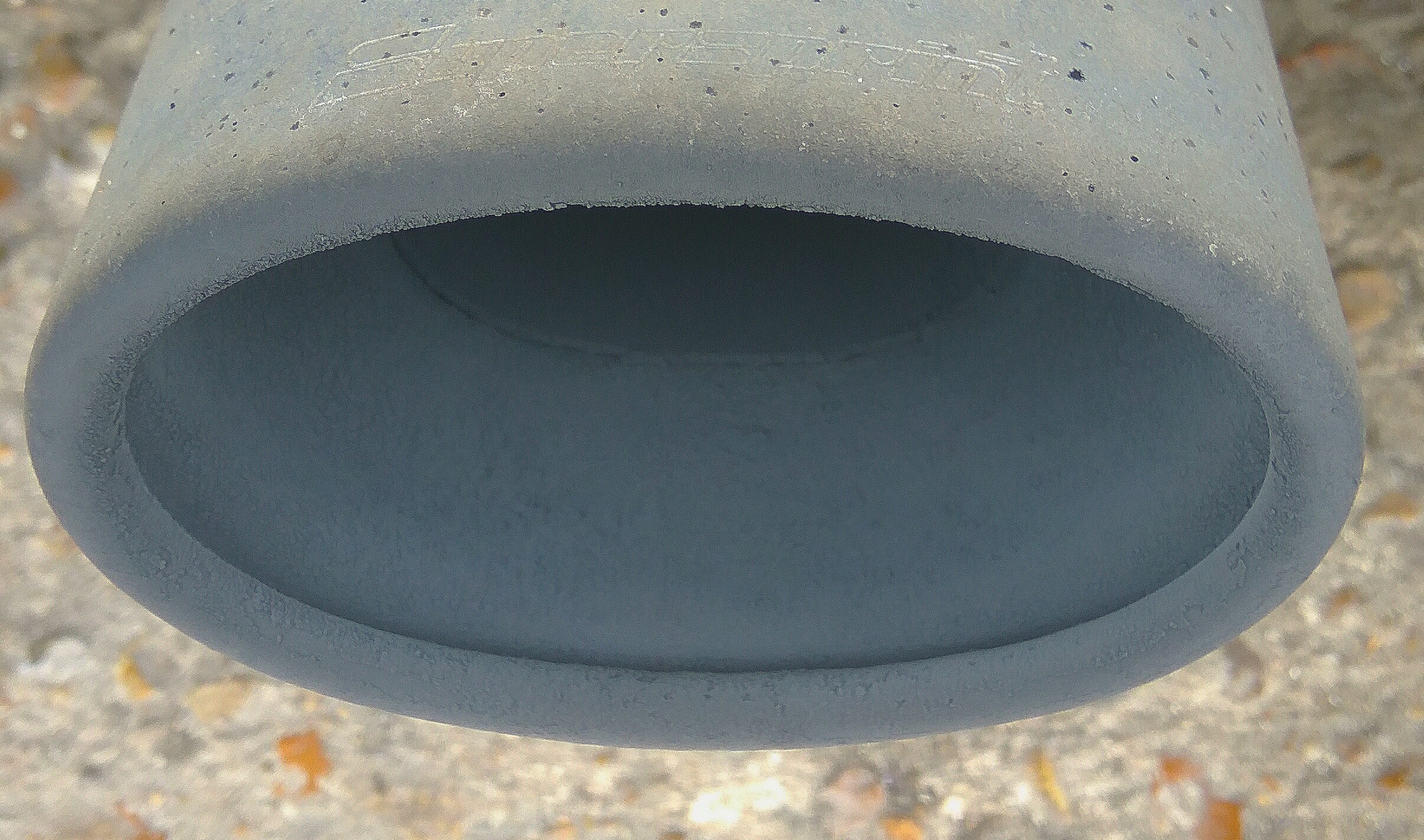

What is the symptoms of grey smoke out of my exhaust at round 3,000rpm? My is 1.9JTD 172000 miles. I have checked my oil is no water in, turbo is fine I have heard white, blue and black smoke but never knew the grey was exist.
Yes it's diesel, when is mild warm till about 3,000rpm or less, but nothing when the engine is fully warm. That's great nothing to worry for now.
Older diesels tend to be prone to doing this especially once a bit of wear is present which might mean there's less compression. Modern diesels tend to keep the glow plugs "lit" for quite a while after start up which, amongst other "benefits", reduces Diesel knock and this smoke problem.
Here's some quite entertaining and extreme video of diesels cold starting:
Notice how many of them make white smoke due to incomplete combustion because the inside surfaces of the engine - cylinder walls, combustion chamber, etc are cold and the fuel, so precisely vapourised, by the injector condenses out on them into a liquid and the liquid fuel will not burn so readily as the vapour. Notice too the black smoke which is due to the injector pump overfueling (injecting too much fuel for the air being admitted) This happens because the system detects that demands are being made to increase revs even though the revs aren't actually increasing so it just starts to over inject. Diesels, pretty much - there are a few exceptions - completely fill their cylinders with air on every intake stroke and regulate revs/power by altering how much fuel is injected into that air. If the revs don't rise it just keeps on injecting more fuel so you get black smoke! The reverse is also true in that often if a vehicle is making black smoke on acceleration you'll find it's got a clogged air filter stopping enough air getting in! (Often an indication that the vehicle has been poorly maintained)
