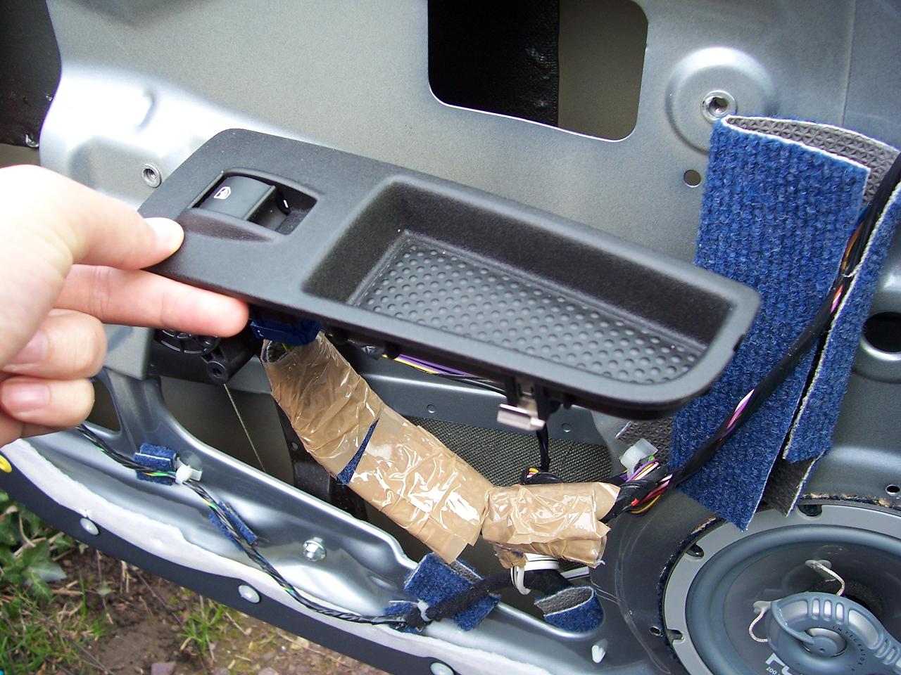

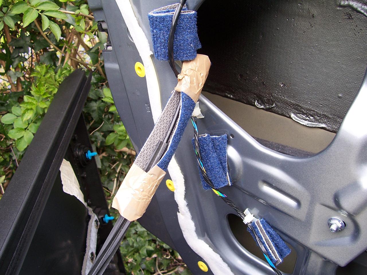

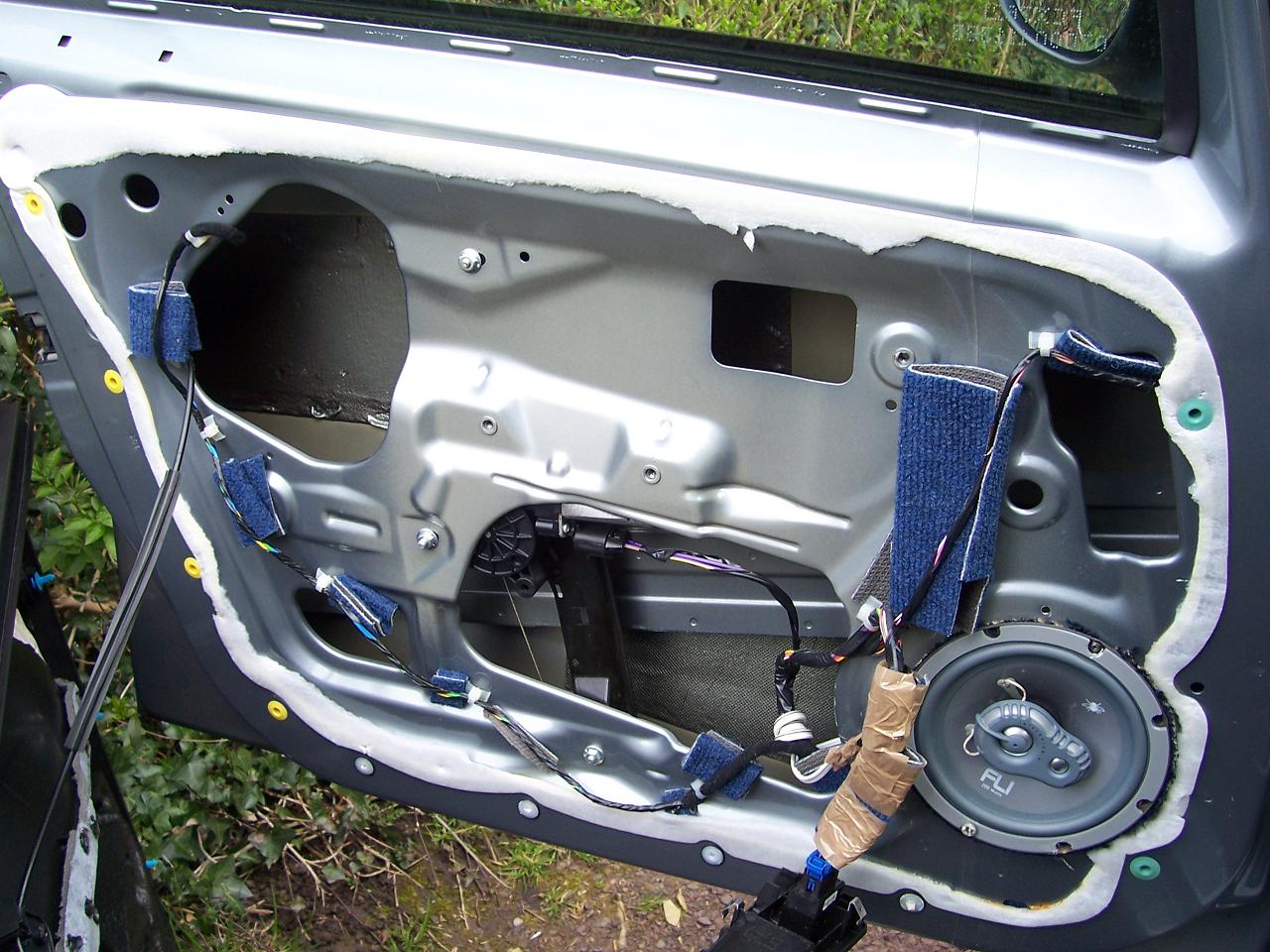

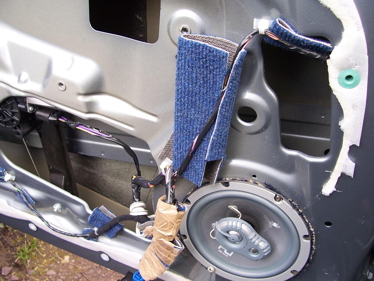

This solution will stop the speaker vibration that has driven you mad since day one of GP ownership.
Doors cards vibrating seems to be a problem with EVERYONES grande punto
1. COMPLETELY tear away the white plastic liner, it makes the nosie WORSE
2. put CARPET underneath every space where the cables look as though they could touch the metal door frame. The cables are the cause of the VIBRATION
3. Make a SPEAKER SURROUND out of thick carpet to deaden the vibration on the door frame as much as possible
4. MAKE SURE you do the big fat cable that runs just underneath and to the side of the speaker hole (you need to remove speaker to get to it), this one is the main culprit...

It may look shabby, but the results are unbelieveable:)
You really can crank up your bass and have the windows down, (should you be that sort of person) without the embarressment of them being able to hear the cables vibrating...
