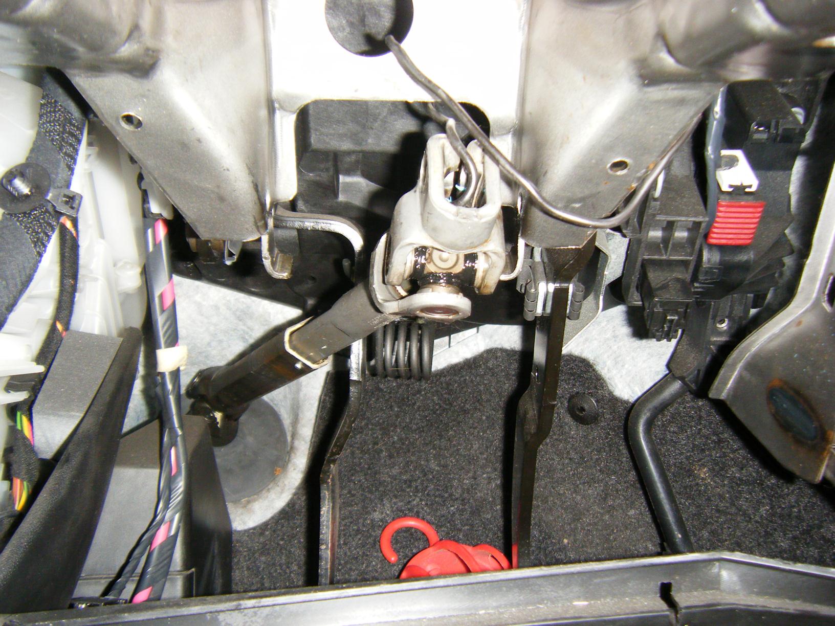

There is one more 13 mm bolt to go. This connects the column shaft to the steering rack. I chose to disconnect it at the rear of the steering column. Wriggle the now loose steering column down and twist up to the right. Reach around the back behind the centre shaft and you will feel a spigot and nut which is facing to the left. A mirror would be helpful to see exactly what you are dealing with. You can get a socket on to this using a swivel ratchet. I wouldn’t say this was easy but you only need to break it loose and spin the bolt out by hand. Once done slide the universal joint off the spigot and manoeuvre the column motor unit out.
I used a bit of wire to tire the steering joint and shaft in position for re-fitting.

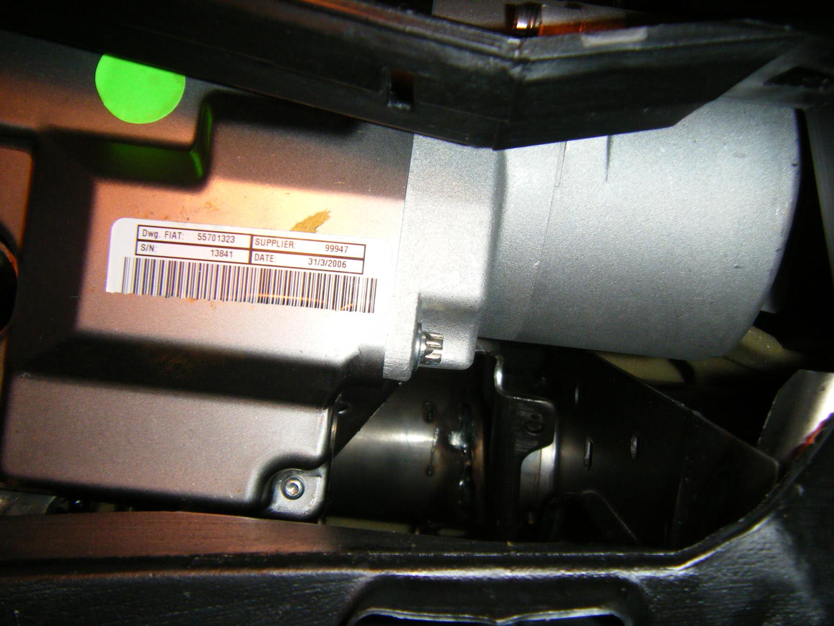

Although the more athletic may be able to get the part number off the base of steering column motor unit whilst in situ, it is a lot easier with the part out of the car.
In my case it was FIAT part number 55701323. I believe there are a number of variations so it is important to get the correct part for your Punto. A quick search on Ebay revealed three suppliers of a re-manufactured part for about £230. You can get your part reconditioned for £150 but will obviously have to wait whilst it is done.
