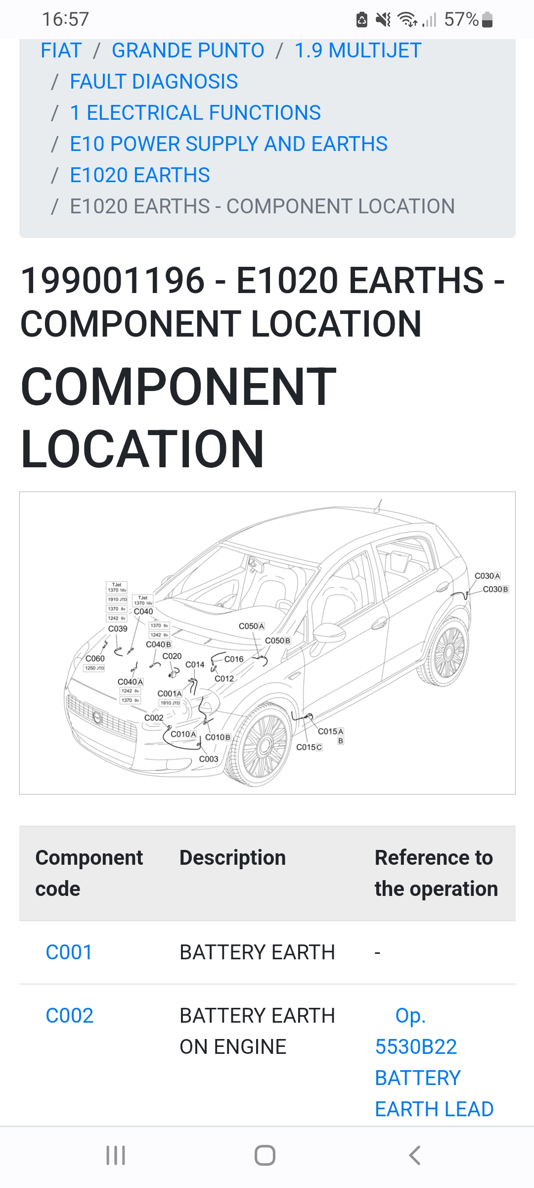

there are four that i have found in the engine bay the Green spots give their approximate location
