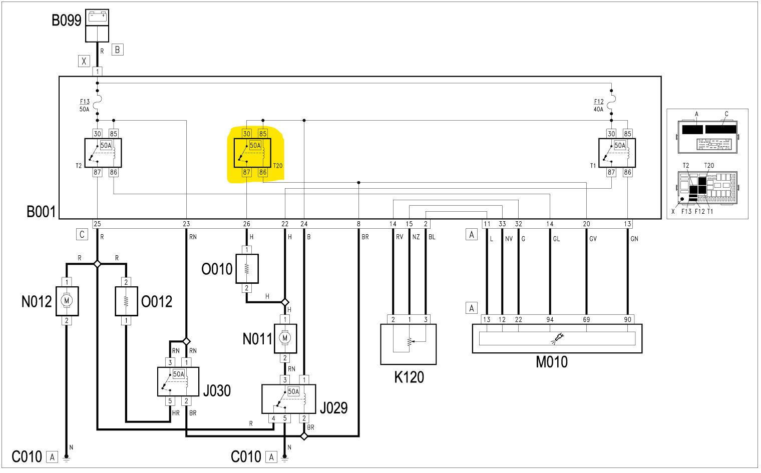

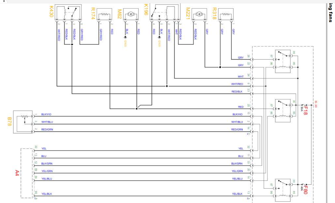

Ive tried looking for the wiring diagrams relating to this, but every diagram Ive found shows 3 relays in the engine bay fuse box. This car only has 2 relays and its not like the relays been taken out, the wiring simply doesn't exist for the third relay in the socket. He's 2 example wiring diagrams from completely different places. In this example, the relay marked "T20" doesn't exist, so diagnosing the faults a bit difficult.

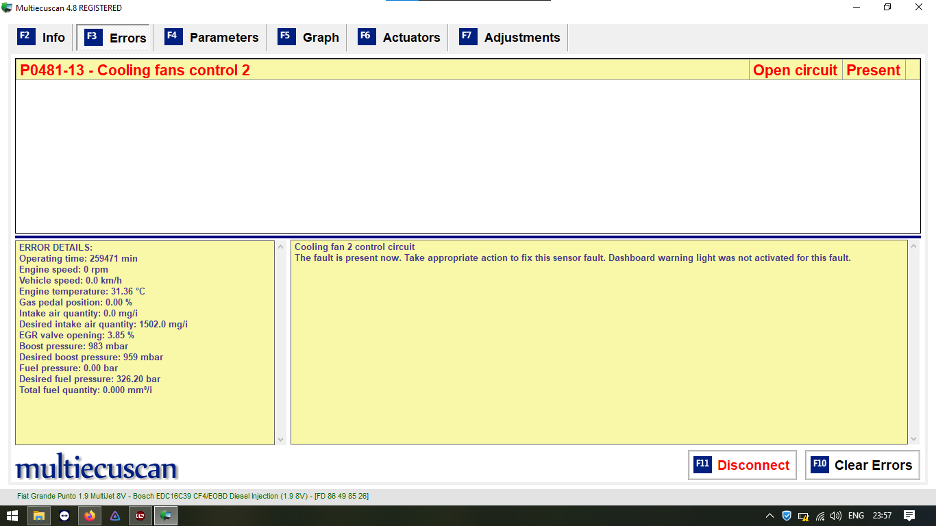

Edit: Heres the fault shown in MES. When the engines on the description changes to "Dashboard warning light WAS activated for this fault".
