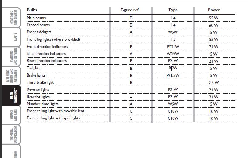

Are tail lights not normally 5watt or does that vary from car to car?
good call john my mistake :eek: bloody websites showing wrong data used to go and grab my handbook but since the evo has led's it wont show a tail bulb
anyhow scoured my hard drive and found the pdf manual your right
sorry to the op :eek:
