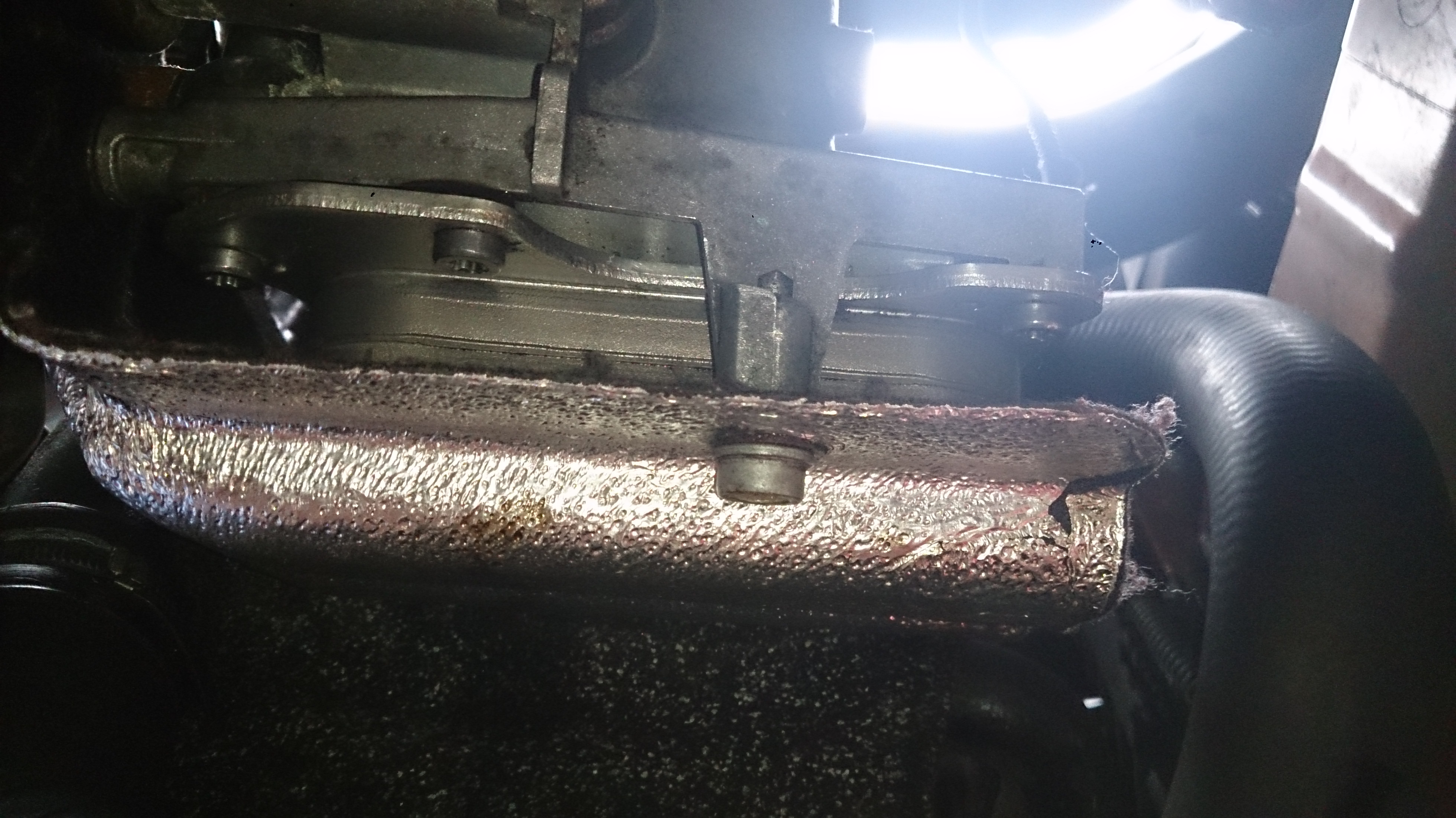

Well, I found a leak. Disregard previous reply of me looking like a spoon.
During the process of changing the oil, I noticed a few small drips of oil around the backside of the the unit where the Oil Filter is housed. I just presumed that it was residual oil from where the old one had been taken out and originally thought nothing of it.
I let the oil settle, take her for a spin up the shops, come back home and see that there are a few drops under the car, tiny, drops. Again, I think its just from where the filter was off, but I think, let me check, just incase. So I wipe it down, run the engine for a bit and what do you know? More drops.
Keep wiping it down, and drops keep coming. Although they were getting fewer and further in between, but still drops. I then take a look at the underside plate thing that screws in, and on the side under this unit, the foam thing is darker than the other side, and has a layer of what looks to be oil, sort of dried. It is not 100% definite oil as I stunk of the stuff, but it seemed like it.
I can't see where the leak is originating from, but I presume that this is my issue. Can't believe I hadn't noticed it before.
Images attached if anyone can make sense of it. Ive for the 75k service coming up/MOT so will get them to have a look at it, in the mean time, I'm stumped. On the second image its more noticeable, you can see the small build up of oil in the center-left, that drips down.

Can't quite tell from the picture but it looks as though the oil may be leaking from the oil cooler... perhaps where it mounts to the engine block... I've never had one off before, but maybe there's a worn seal in between the block and oil cooler. I can't imagine it being a huge job to take off and replace the seal, but it might be worth looking into and researching. The oil cooler and the oil filter housing are all one component I think. Let us know how you get on
Will do, and thanks.
I was working on it with my dad, and his immediate thought was exactly that. Will look into seeing if this is a job that I can do myself.
