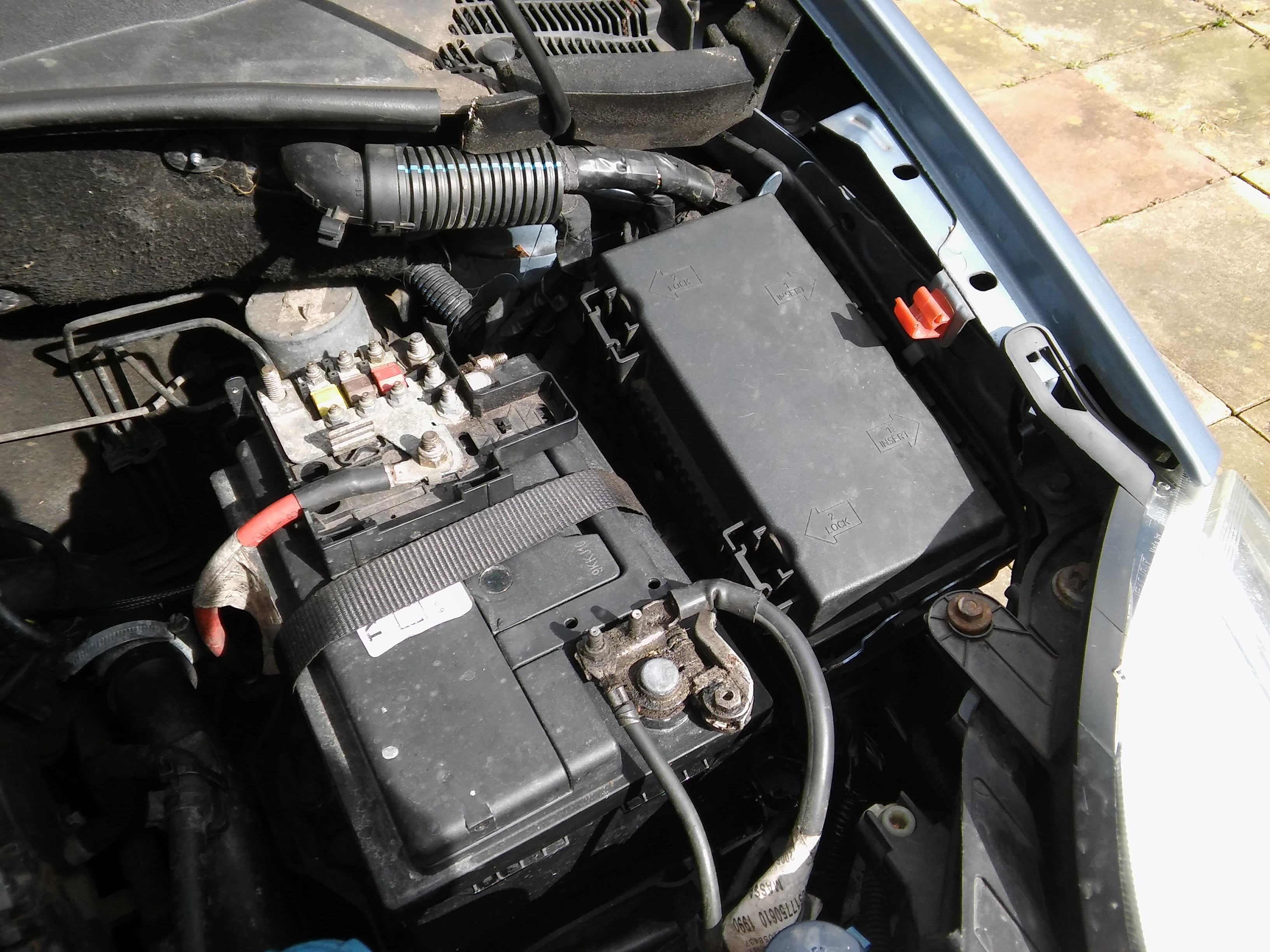

first you need to remove the battery, I do have a battery saver which you plug into another battery and into the OBD2 socket to keep memories, no point in this as there will still be live connections floating about under the area I am working in, so its a complete battery disconnection and removal
pic 001
remove fuse box cover
at the back of fuse box in a 12v positive feed, undo it with a 10mm socket

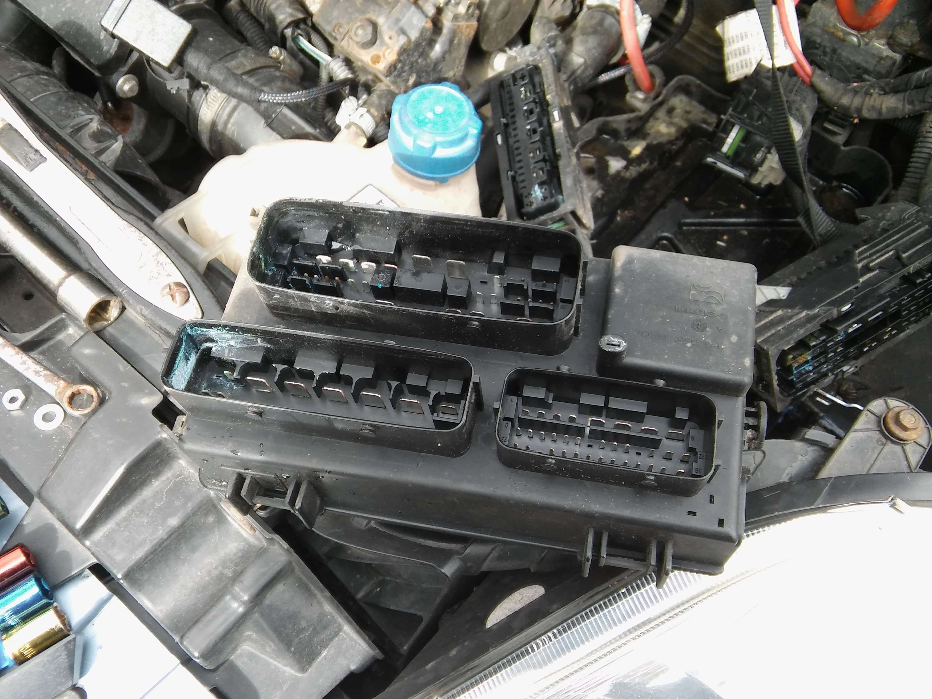

put hand underneath and pull the fuse box round so the fuses are facing the inner wing, this reveals the three large connections to the wiring
pic 002
each connector has a clip, press a tab in and move the lever, it releases it from the box, undo each one.

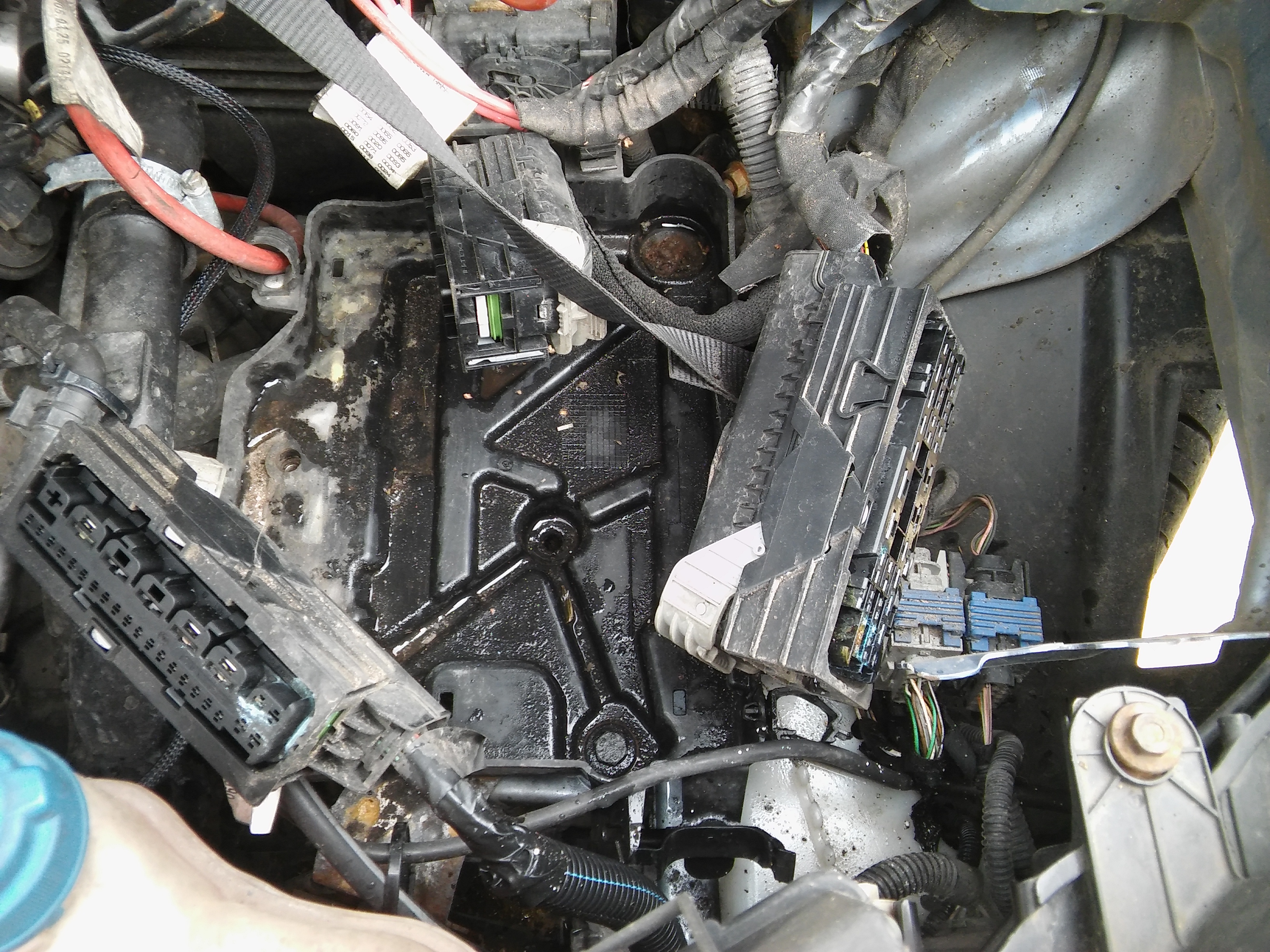

fuse box can be lifted away, this is the underside
pic 003
fuse box removed, cables etc, some of the insulation tape was missing or had come adrift in places, I put some new in before refitting, and used a heat gun to tighten the tape, also used heat to dry out the sockets because they were damp

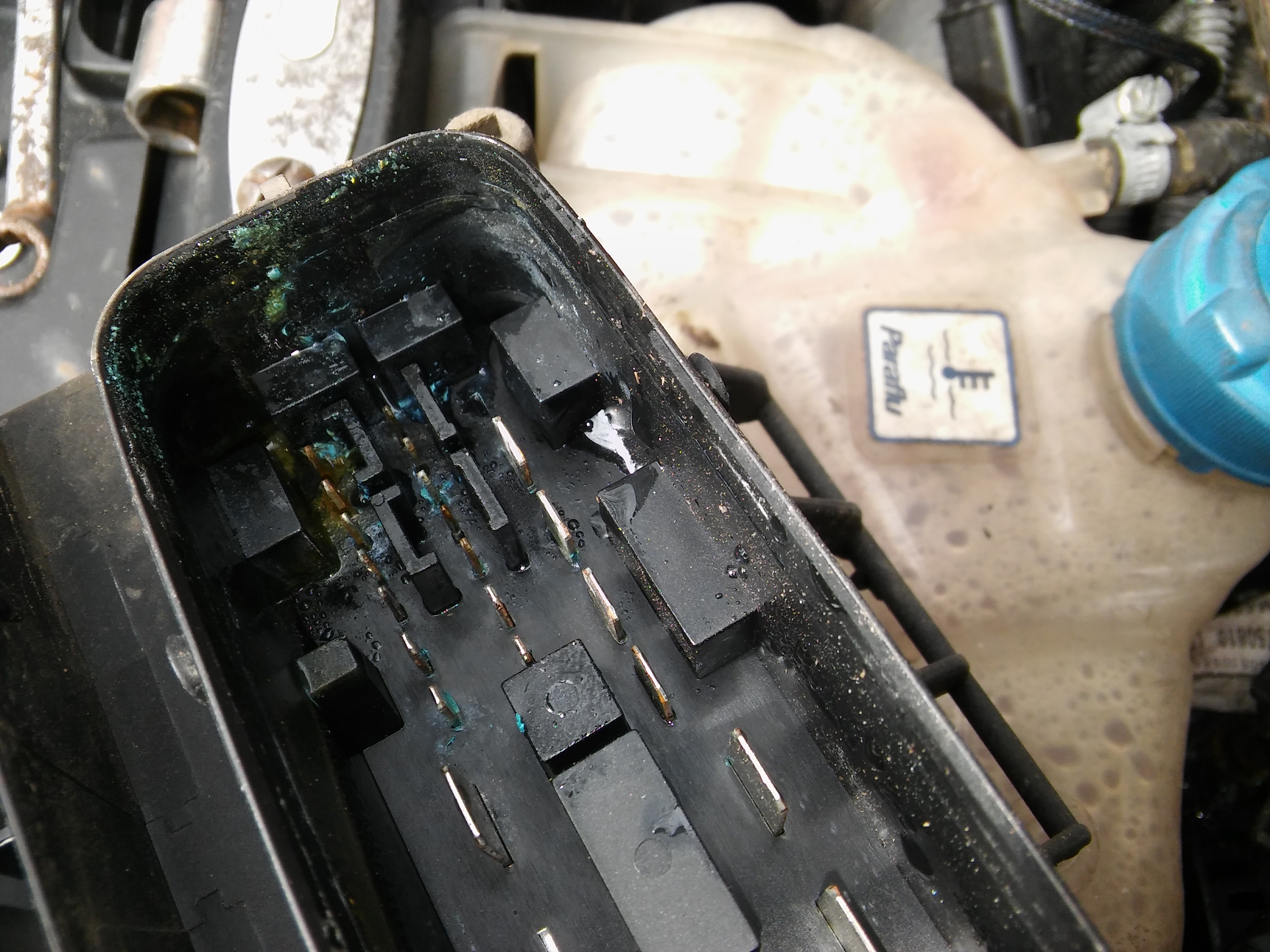

pic 004
underside of one of fuse box connections, there was dampness and corrosion of some pins, I cleaned it up with contact cleaner and a brass wire brush, and also my toothbrush. used heat to make it all nice and dry.
pic 005
after this, just put it all back together, I used some grease around the inner edge of the connectors to help keep water out [not on electrical contacts]
