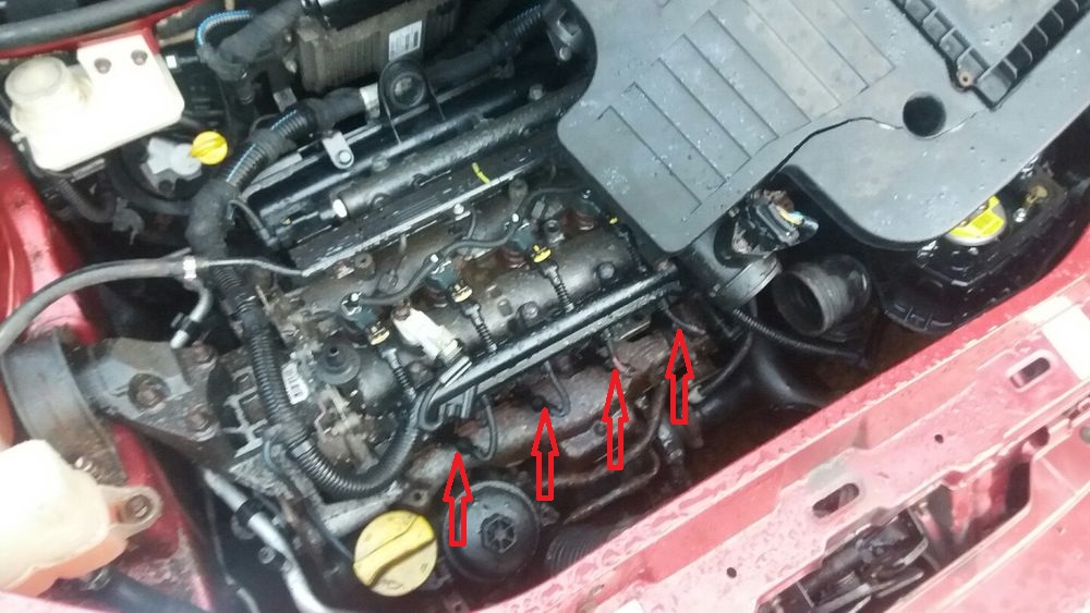

HI, any chance you can show us some pictures where the glow plugs situated, mine is at 86000miles, will need all infos as to how to DIY, many thanks.
Hi
This a picture I found on google and I have marked the glow plugs
You can only see them with the air box removed
LUIGI
