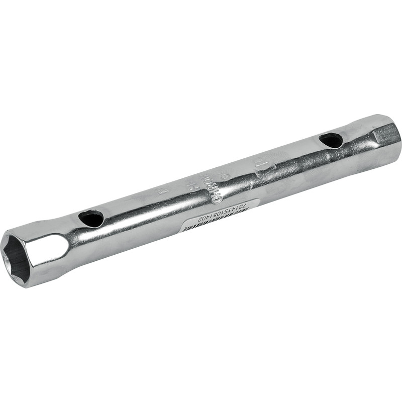

Concerns a Croma Diesel 16V 150 BHP built 2008. Got the message ”have checked glow plugs” on the dash. Started with reading the Fiat Forum about this issue. After locating the plugs on the engine I took the connection caps of with a paint stir wood (king size) as a level. Measured the resistance between coils and ground with a circuit analyser. On three coils the resistance was about 1 ohm, and one showed infinite. Checked also if it was possible to unscrew the plugs with a 9 mm spanner as on the picture, no problem at all.
