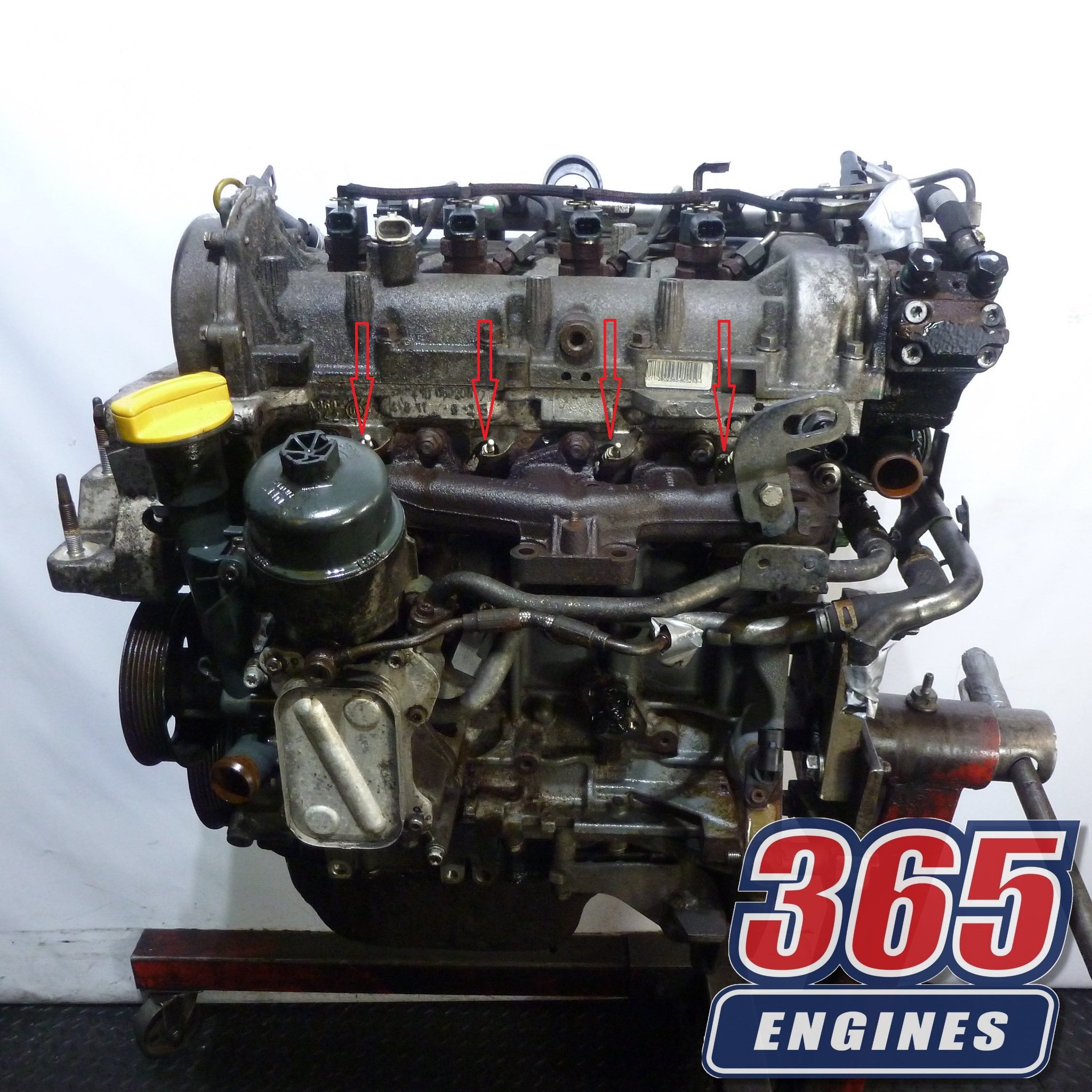

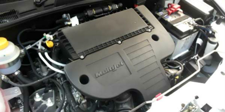

This is my engine
My glow plugs were easy to change with the air box removed[see pic]
I have heard horror stories of stripping threads but i just sprayed the plugs with WD40 on a warm engine left over night sprayed them again after warming the engine again no different to changing spark plugs

It's easy to change them on the Multijet I, but dificult with the Multijet II. I've heard stories about some guys removing them with tiny ratches/wrenches but i'm not sure if it's true... So DPF or turbo probably needs to be removed.
