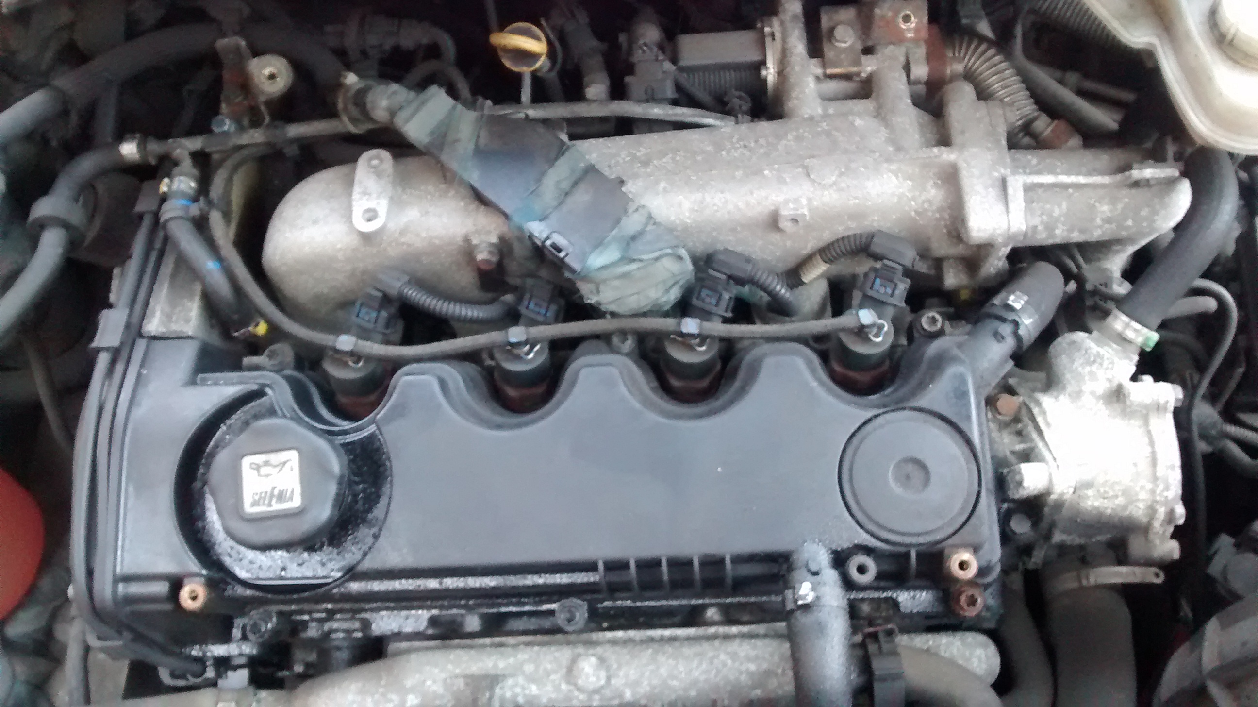

I've not been lazy, I've literally traweld the posts and web. But its driving me crazy as no pics or descriptions have enabled me to located my glow plugs.
I have a 53 (2004) 1.9jtd 105.
It would be amazing if someone had a photo or diagram on their location. I appreciate that at least 2 are hard to get to from what I've read.
Thanks in advance . lee

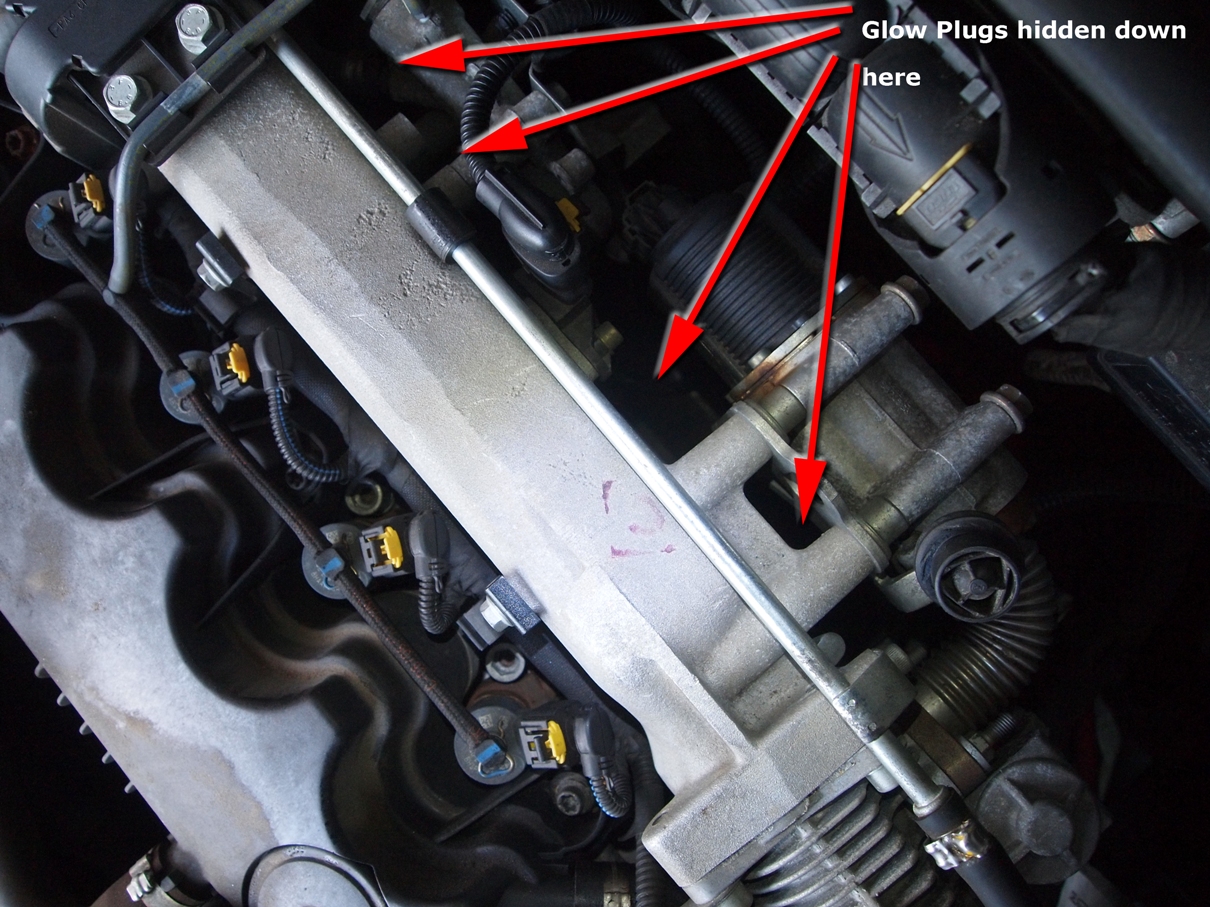

Picture below shows where they are. This is from a Punto Mjet engine. Glow plugs are in the same place as the JTD, but some other components are different.

they're in a row..,
find one you've found them all.
getting them out is a different story ..;)
Thanks for your help.
Done the glow plugs on various vehicles. And am starting to see the pattern here. They run in a line :)
And they can indeed be sods to get out.
Thanks for the input guys!!
