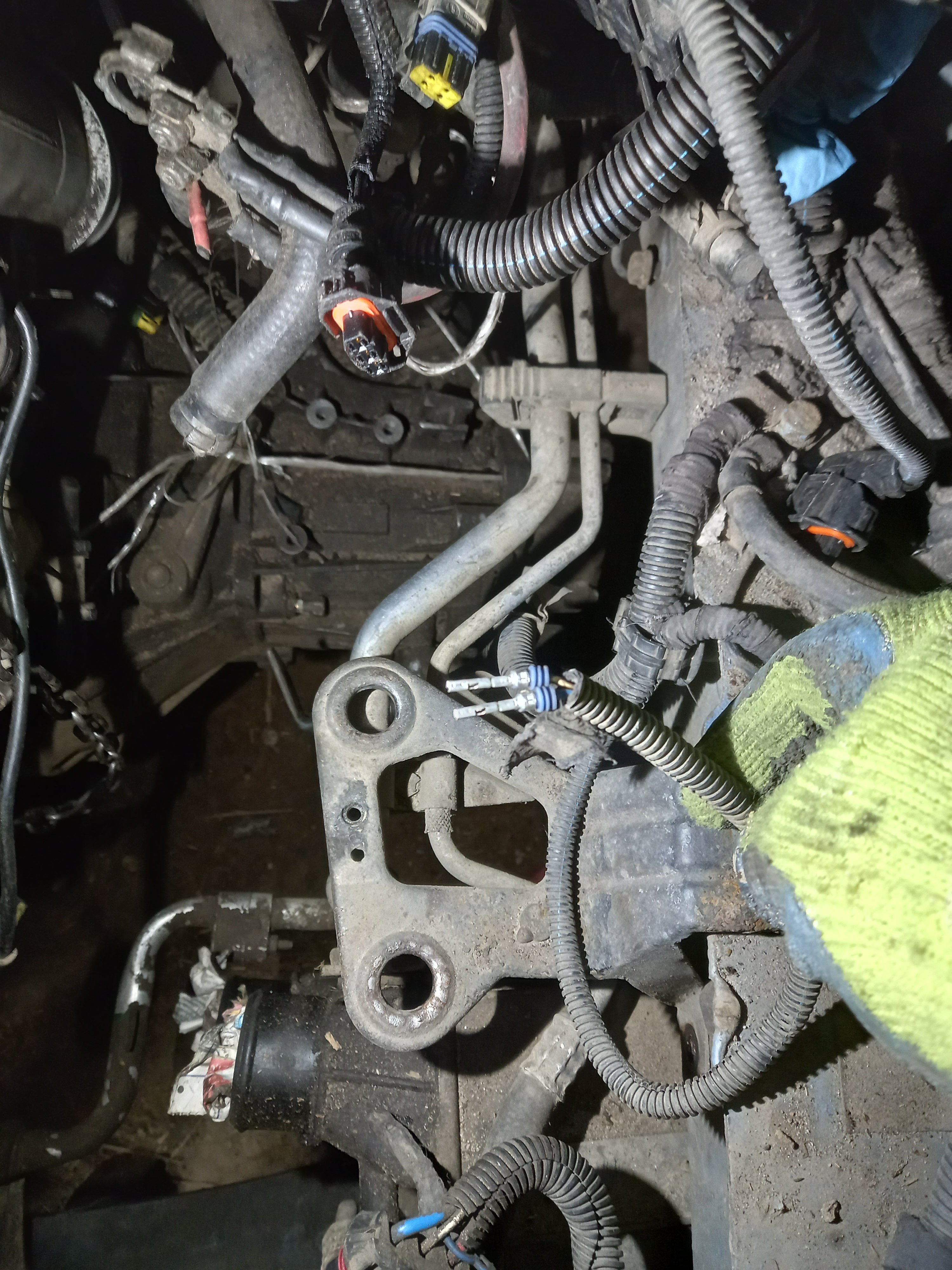

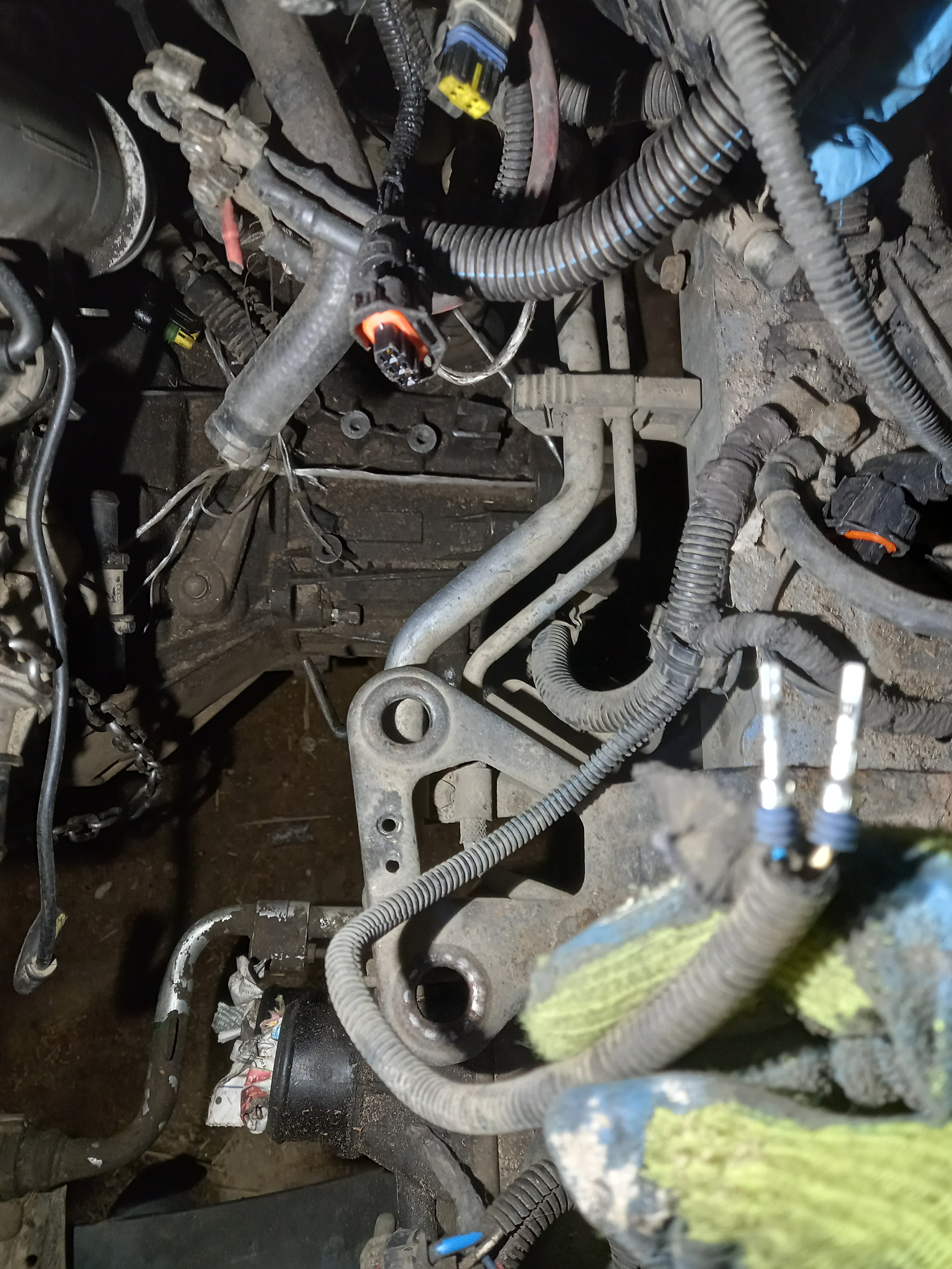

Hi I'm replacing an engine on my wife's multipla and somehow I managed to lose/brake one plug. Can someone please send me a picture of it. I'm pretty sure it's reverse light switch plug. I need to see the plug unplugged if possible as I have to buy a new one. Thanks

Difficult to be 100% , but if you put a low amperage fuse between the two wires it should be possible to confirm reverse light works without causing any damage.
By the way in the other pic there looks like a wire behind the orange plug and below the yellow ones shown in pic with it's insulation damaged or burnt, if so is there any other damage as wiring burning tends to go much further than is first apparent.:(
