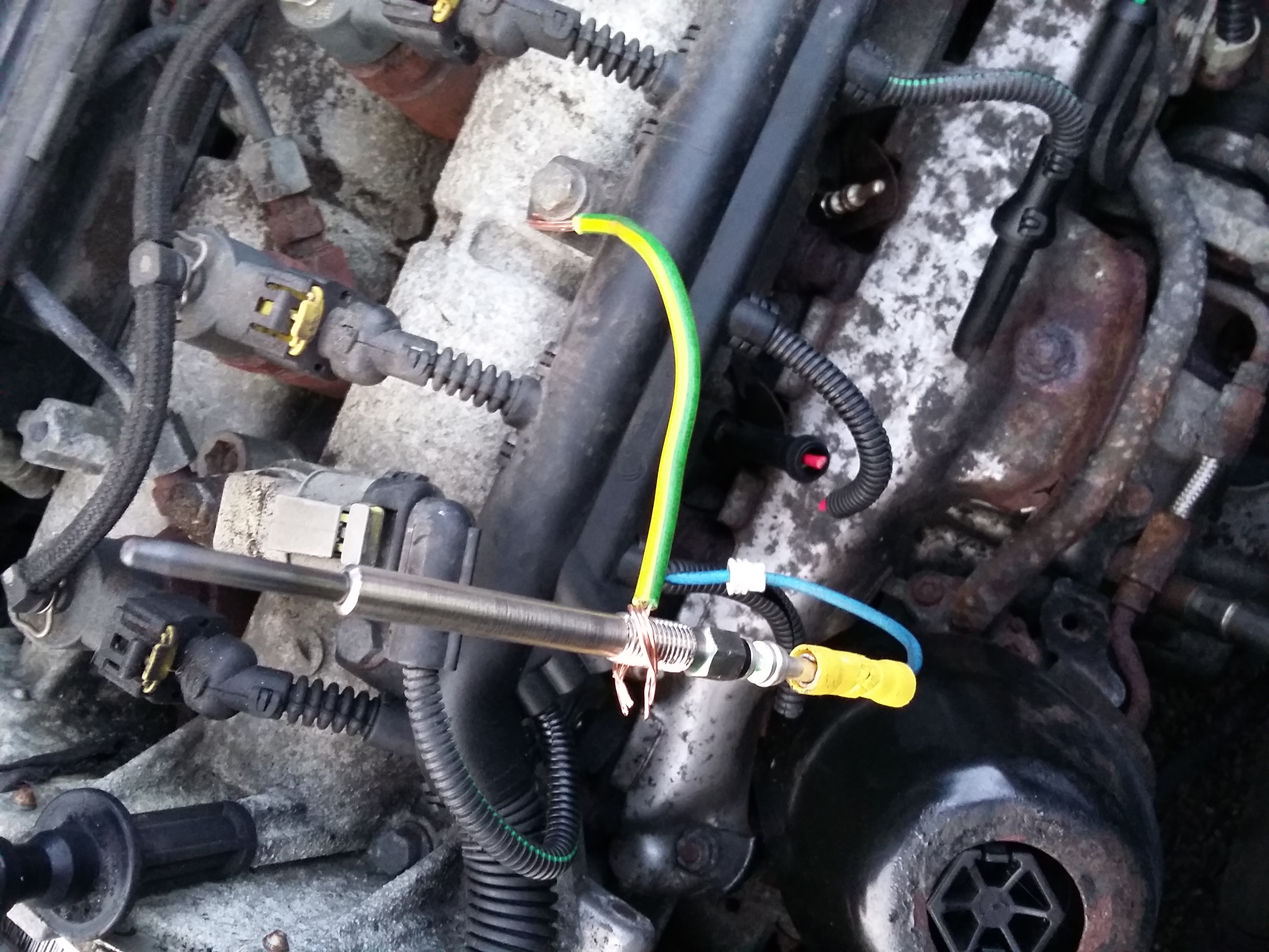

Todays basic test rig-
Short piece of cable.. fron glow plug body to engine bolt.
Good earth.
Then plug coupled to a power lead.. working along the cylinder leads.
With this I could see the plug glow cherry from thr drivers area :)
Having got power.. had the confidence to rebuild

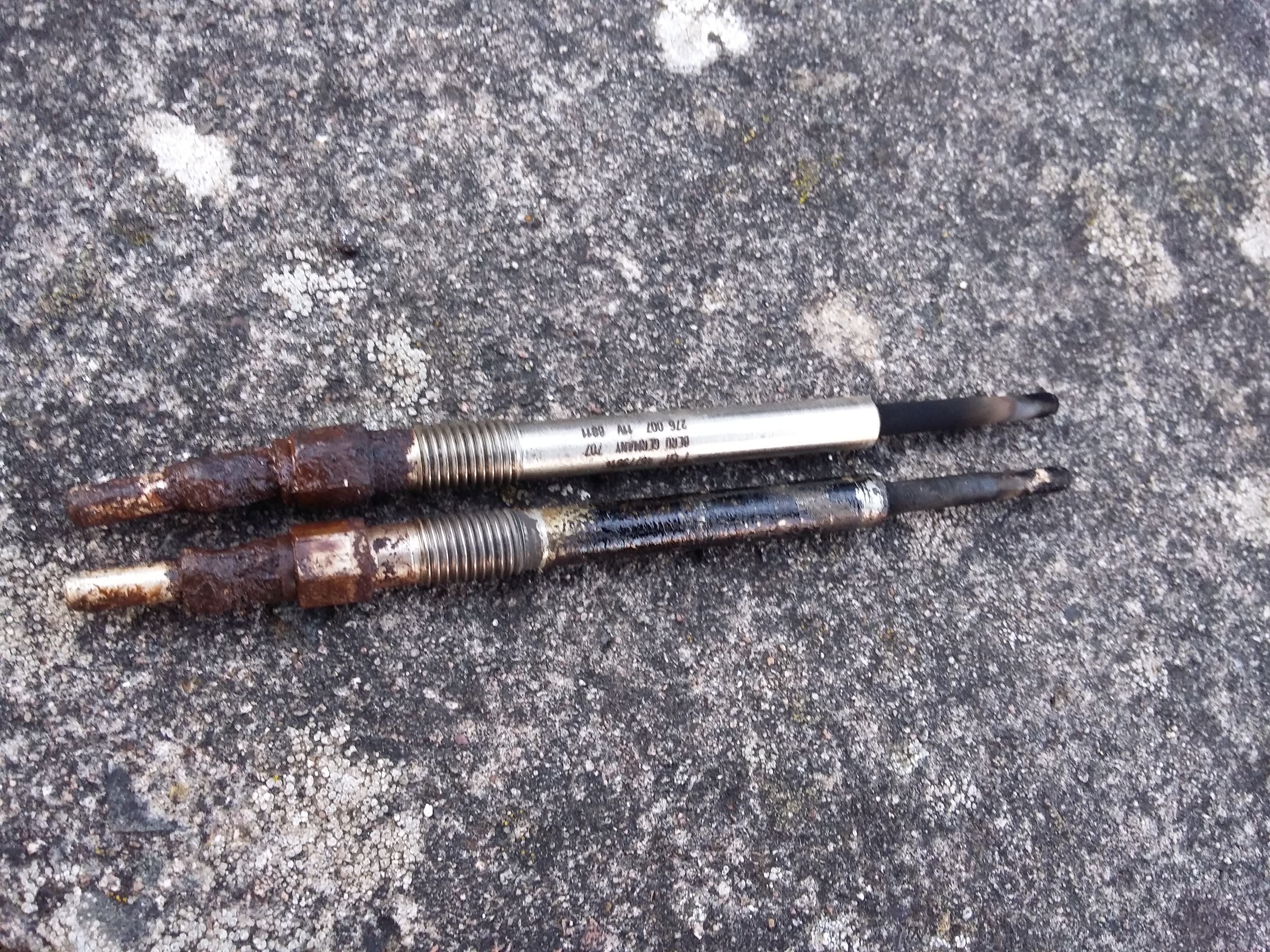

I think these BERU plugs have been in for a LONG time :(

Looks likes they have been getting wet a fair part of there lifespans

After removal :
