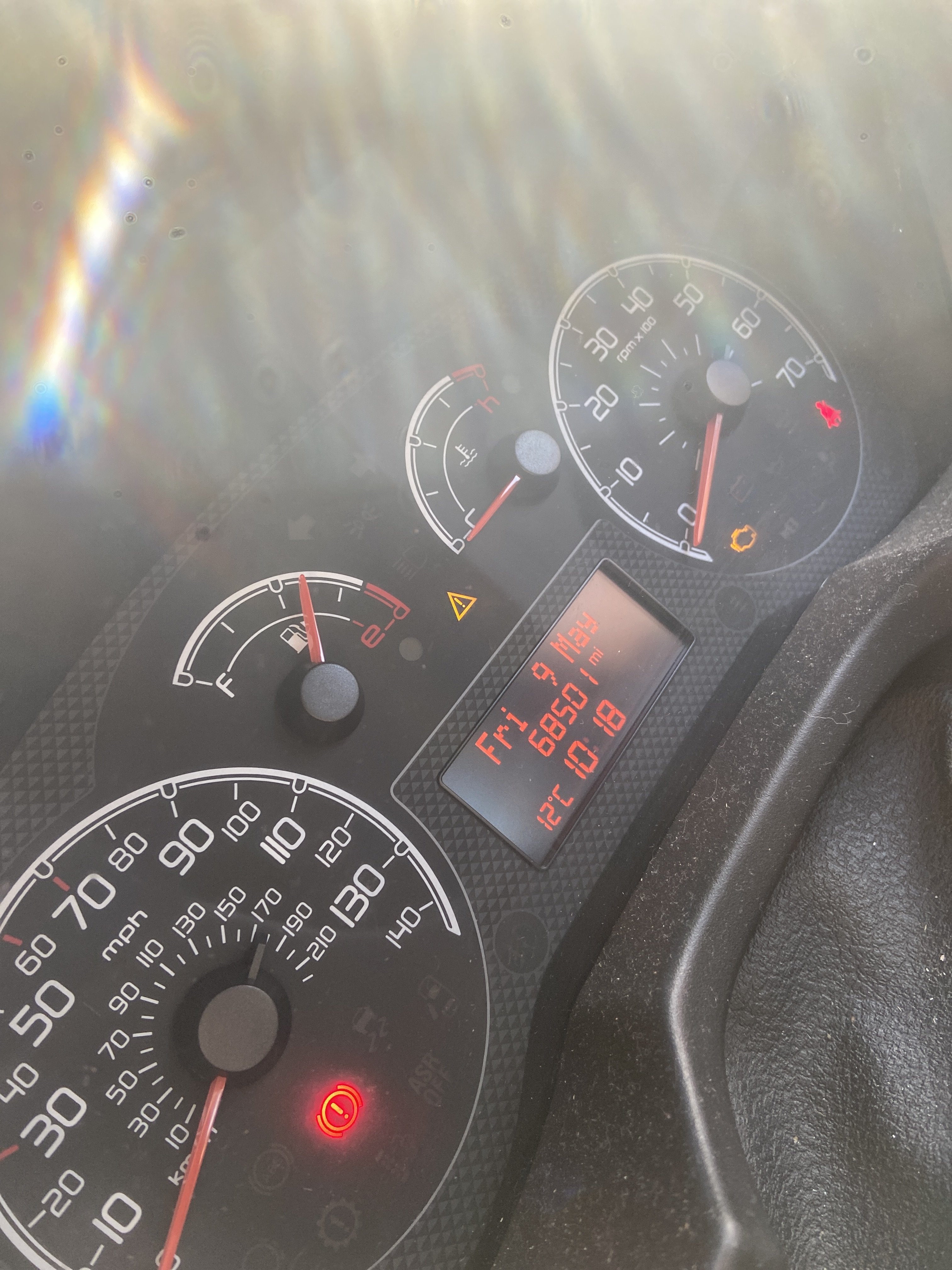

Thought it might cure me orange triangle, but alas, no šŸ™ˆ
View attachment 466453View attachment 466453Thought it might cure me orange triangle, but alas, no šŸ™ˆ
Can you read the error codes, I don't use MES like many on Forum but Maxiecu Scan tool for Fiats on Windows platform, but any good Fiat specific would help.
Looking at your LCD display reminds me at some point I need to take speedo out and see what is wrong with that as it has gone blank, it started being intermittant, but now nothing.
I see on online you can buy a new display, but not a 5 minute job and may not be the cause, so I will have to find some enthusiasm. The one on my Vauxhall works fine, but the spares Doblo one doesn't work either so I can't rob that one, although in fairness it has repaid the £280 I bought it for many times over in parts donation.
It reminded me of back in the 1970s I worked for a Wartburg Dealership and the boss took one back in part exchange that wasn't good enough to retail. Over a period of time the stores manager used to get the workshop to remove parts so he could resell them. At the time a brand new Wartburg was selling for well under £1000, the Stores manager sold the parts for over £2000!:)
I haven’t got any codes mate sadly (I know, imagine yourself with no codes on your car and yet your still worried lol)
I’ve used my mates snap-on code reader, fully up-to-date software n that but comes up with nothing.
It did once say check DRLs which my van doesn’t have lol.
If I could scream over text you’d all be deaf by now
Strange Snap On didn't report anything when you have the yellow triangle etc.
