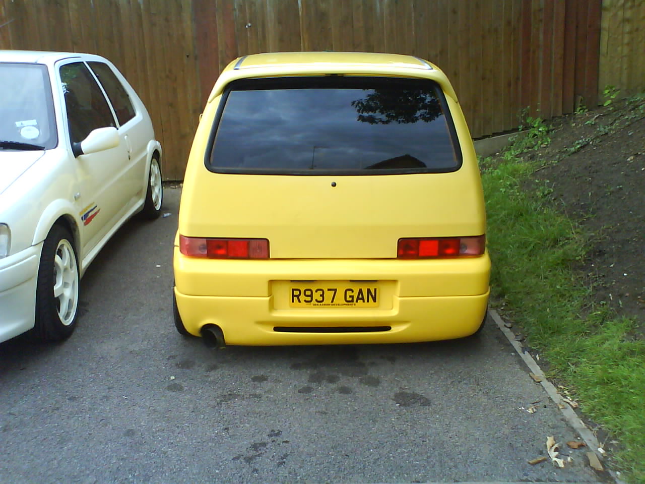

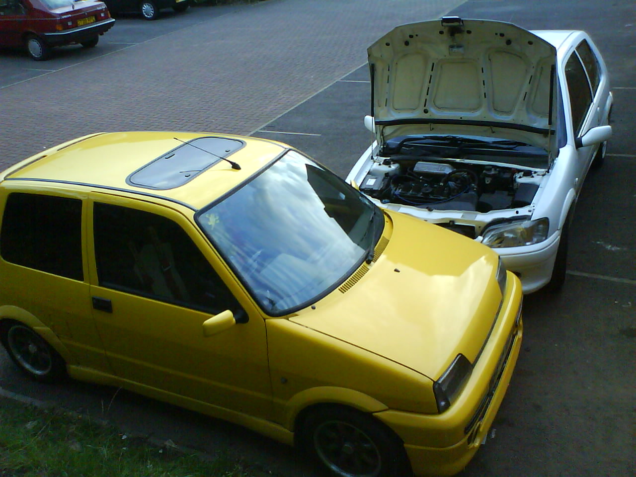

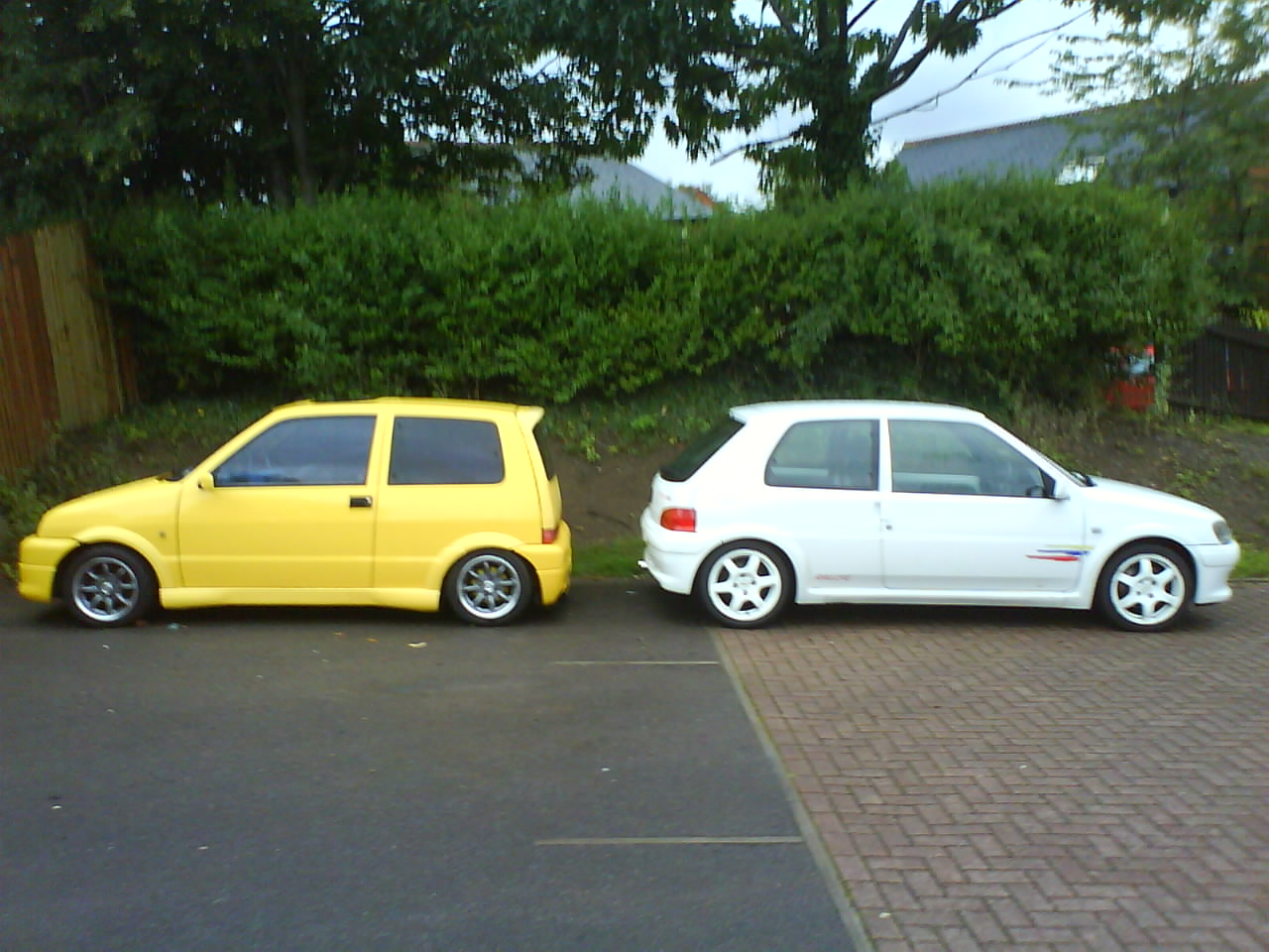

Well its been a while, Rallye's moved in, cinq has been sulking ever since, heck they wouldnt even speak for a while (awww a story thread :D)
sporting standard rear lights again now :)
Actually looks cool i think :eek: :D
But the rallye was there for the cinq when it needed it :D
And after a day of tinkering with the cinq... and some jump leads :D
it started first time :slayer: been dead how long now too? :D
Battery light unhappy at first but went out afterwards :)
Now just to sort this damn oil warning light out.... :eek:
Future of cinq still cloudy, and unknown in the crystal ball etc, but will play itself out in the coming weeks no doubt :)
