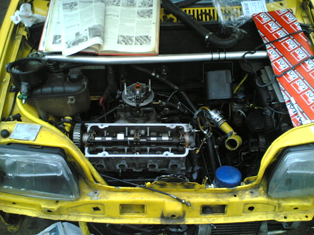

So yeah, yesterday.. Breather filter off...
Mmmm oil breather looks healthy...
As does the breather hose :yuck:... guess that'd be the HG gone then :nerner:

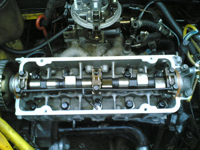

And well camcover off, after that point i was working in dark so no pics :(

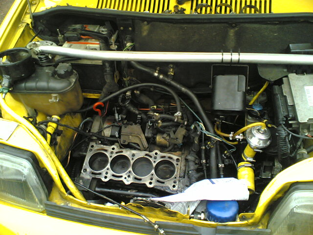

Todays update:

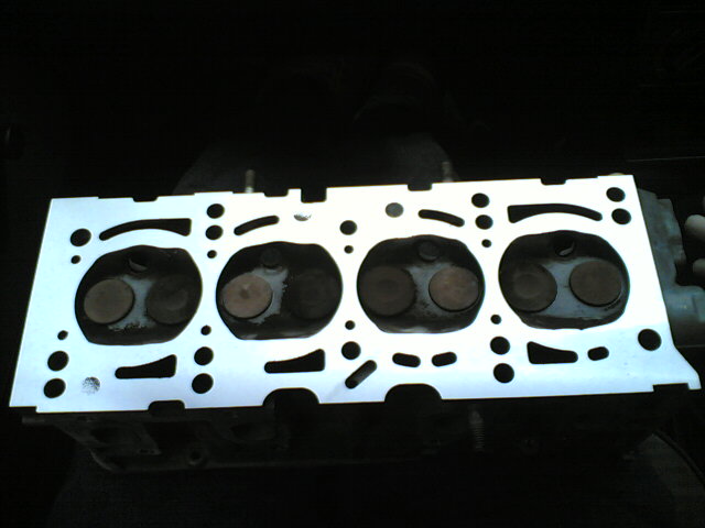

Head off and off to machine shop...
apparently its been flowed, had valve seats worked and other bits done (y) yay :D got no paperwork for that but sorted! :D
Had to have 4 thousandsth of a inch taken off... was assured was nothing... which was nice :)
so back from machine shop :D
and pistons all fine too... which was also very nice :D lol
