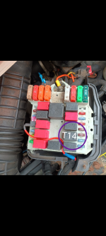

You might find that the vehicle is switching earth, and not the +12V. Suggest you use a multimeter and back probe the existing headlights to determine.
See photo
You need to find the cable to the light which comes from pin 87. This is where you need your pin 85 connected to.
When high beam is on then your pin 85 on your Aux relay will be positive & your dash switch can send earth to 86 to turn Aux light on
This will make sure you can't turn on Aux lights without high beam being selected.

See photo
This is the same rule in Australia.
Cool, thank you very much👍🤩
And I can see you also have those smart fuse holders for inserting in an existing fusebox.
I just discovered those yesterday 🤣🤣🤣🥴🥴
