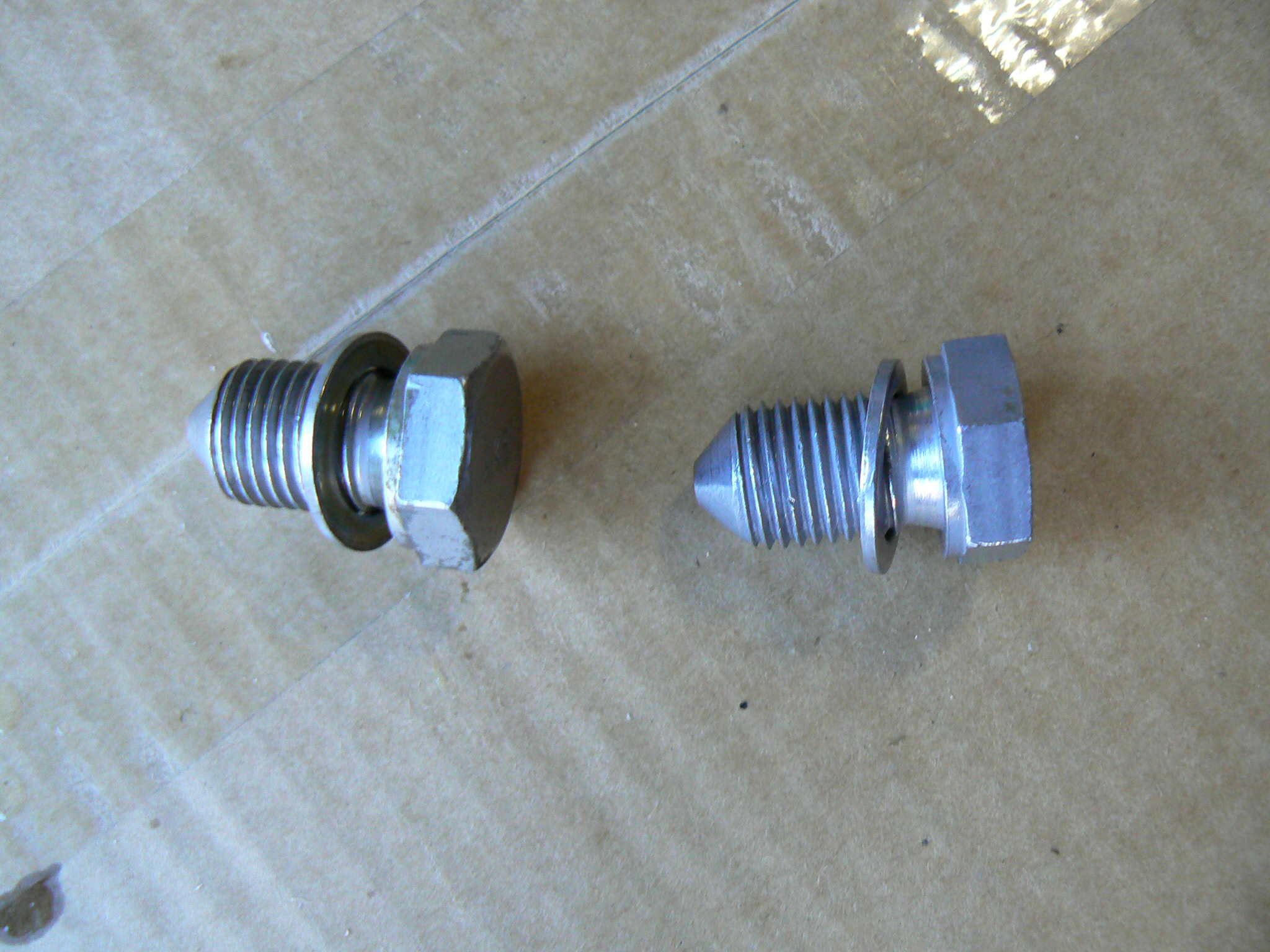

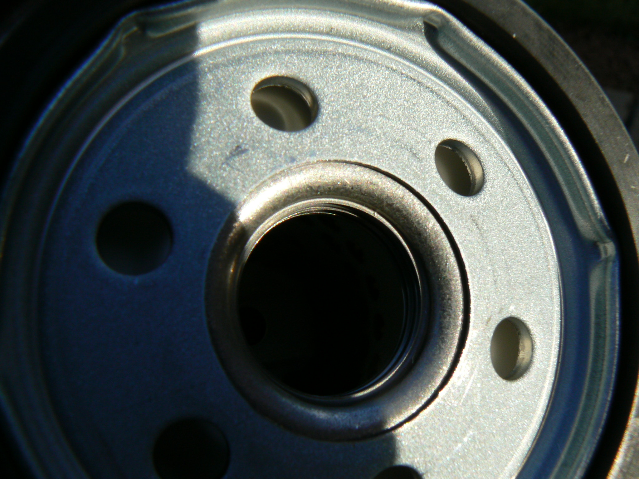

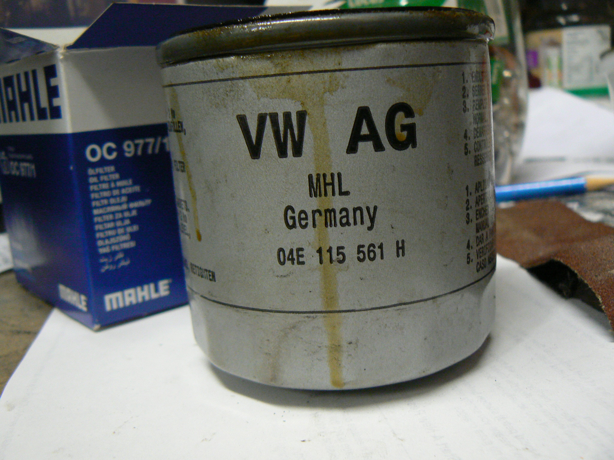

Anyway back to the engine service. I'd been stressing out about the drain plug. It's an alloy sump and I've run into problems with the thread stripping out on this type before - It then becomes a bit of a phaf to rectify - but there are some excellent repair kits now available. VAG recommend always fitting a new plug because the sealing crush washer is captive in the plug and can't be renewed separately. I bought a new genuine one from the dealer for just under £4.00 Old plug on left new on right:
Which I notice is less than some are selling for on ebay. In fact it turned out to be the same plug as used to fit the old PD engined Fabia my boy ran years ago and I've got a new spare lying on my workbench, I'll just use that next time. The dealer also confirmed the torque for it at 30nm - exactly what the Haynes manual advises. I was pleased to find the old plug unscrewed without any sign it had been previously overtightened and the new plug snugged up perfectly - good, the dealer technician would seem to have known what he/she was doing. The oil filter canister is simple to do and very accessible on the front of the engine. I noticed the new Mahle filter did not seem to have an anti drain down diaphragm:
so was glad to see that the genuine VAG filter it replaced didn't have one either. I was also able to prime the new filter with oil before fitting - doubt if the dealer tech would bother to do that. Interested to see the letters MHL on the old (VAG) filter. Could it be that it's manufactured by Mahle?

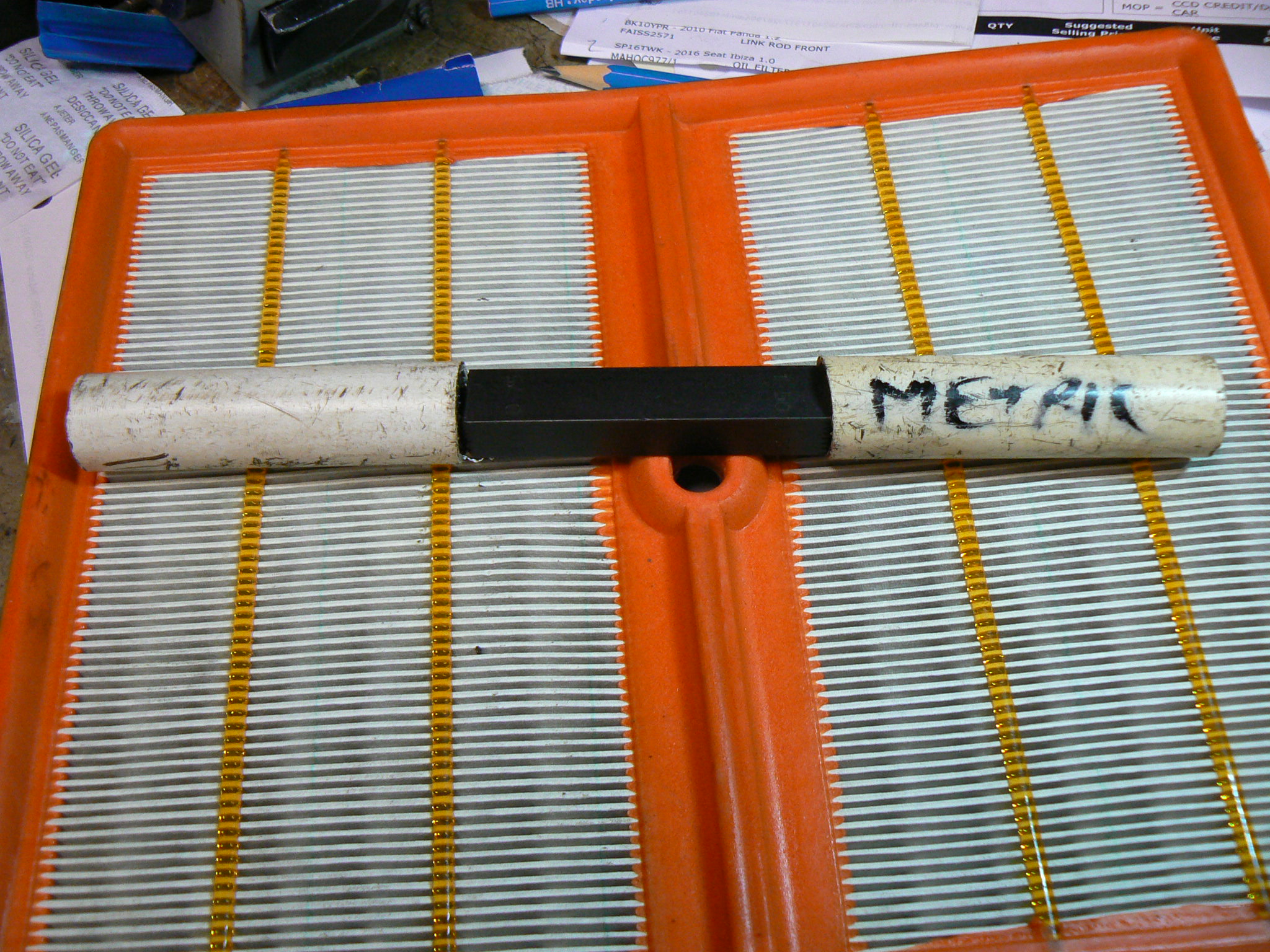

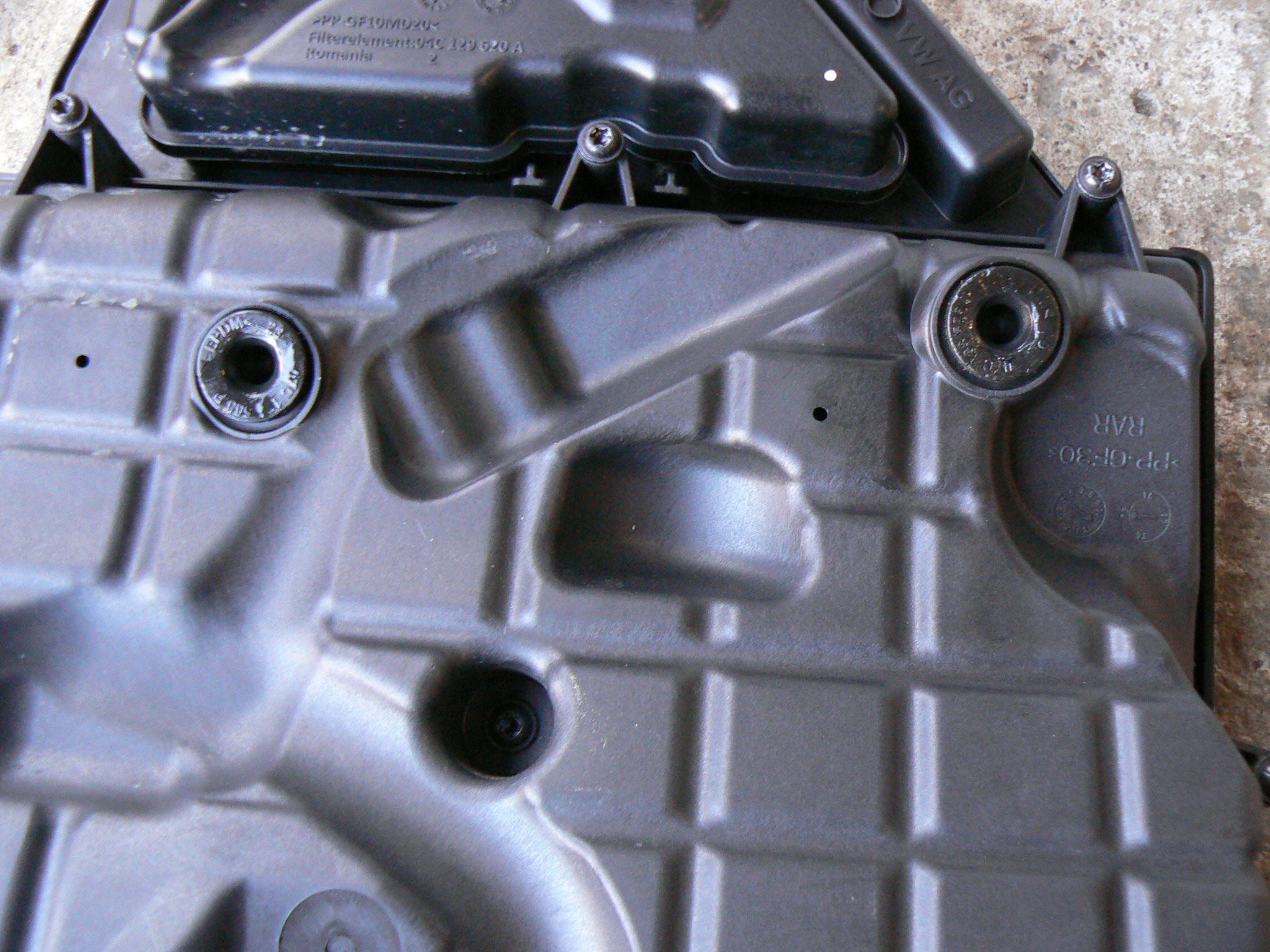

The air filter was easily changed once the casing was removed from the engine. There is one torx screw at the front of the filter to be removed, also a small breather pipe. A couple of awkward big and very springy! hose clamps on the intake and feed pipes to the turbo and one small hard nylon vacuum pipe which just unclips. Then you pull upwards - forcefully - and it comes off the two ball headed mounts on the top of the engine.

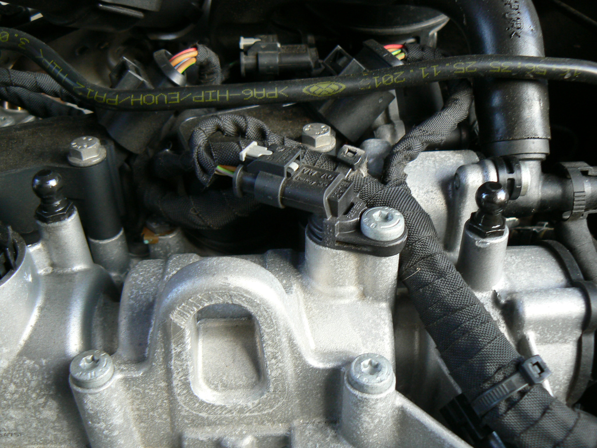

I wonder how long it will take the rubber grommets to degrade, harden up and start rattling?
Once off there are a host of small torx screws holding the top on with, the inevitable, sneaky one hiding down a hole so you don't know it's there! A small dab of silicon grease on the rubber grommets eases reassembly and, hopefully, will make removal easier next time. The second time it was serviced it came back with this scratch on the top of the filter.
It annoys me every time I open the bonnet but, unsurprisingly, complaining got me nowhere!

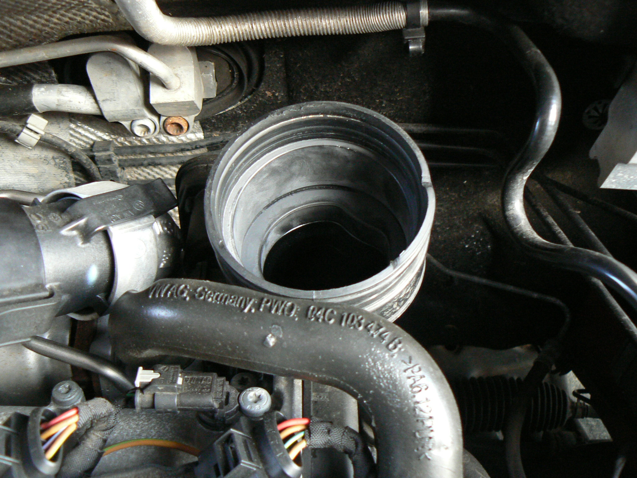

Once you've got the filter off the turbo intake is very vulnerable and needs to be shielded (with a cloth or paper towels maybe) as even quite a small bit of debris falling in here will be the kiss of death to the turbo;

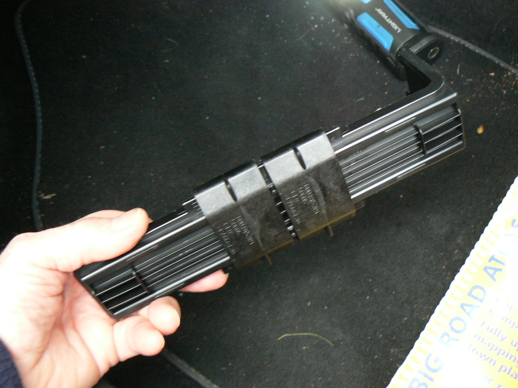

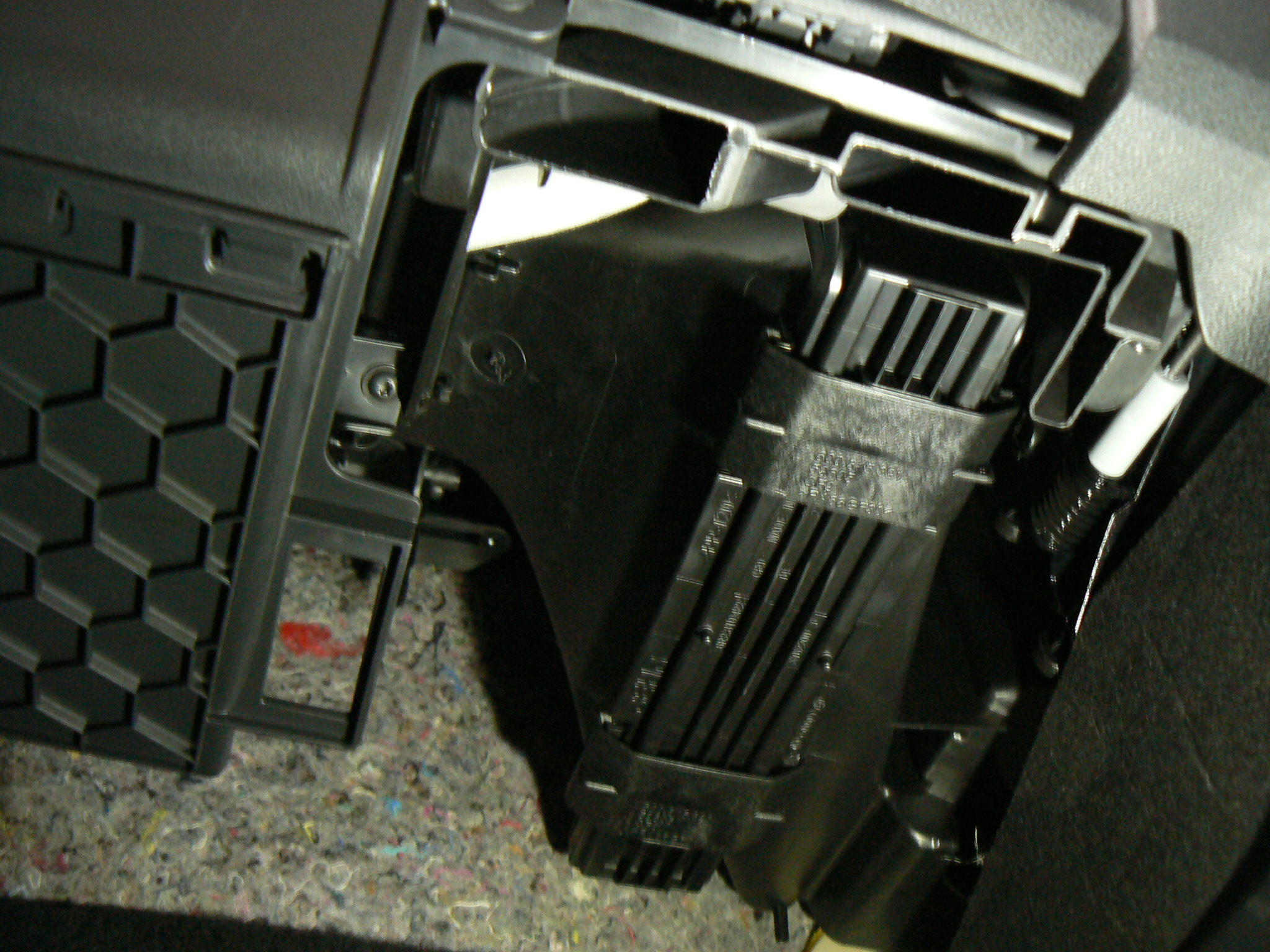

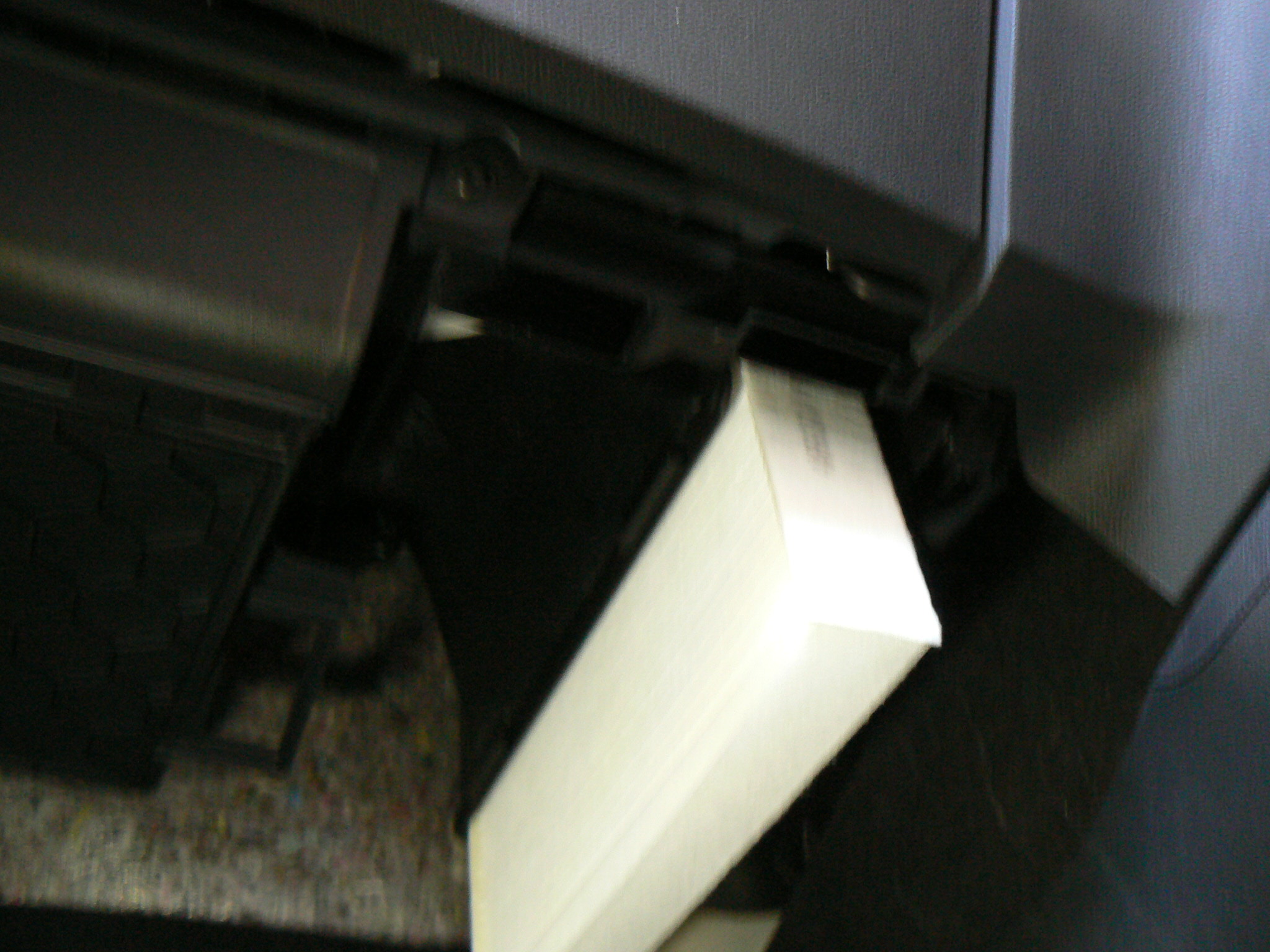

Finally the cabin filter. I really have to give Seat (VAG) full marks on this one. The filter is under the dash on the passenger side and has to be one of the easiest I've ever done. No dash/glove box parts to remove. simply look up under the dash from the passenger foot well and you'll see the cover:
Slide the retaining slider clips to the middle and withdraw the cover downwards (it virtually falls off)

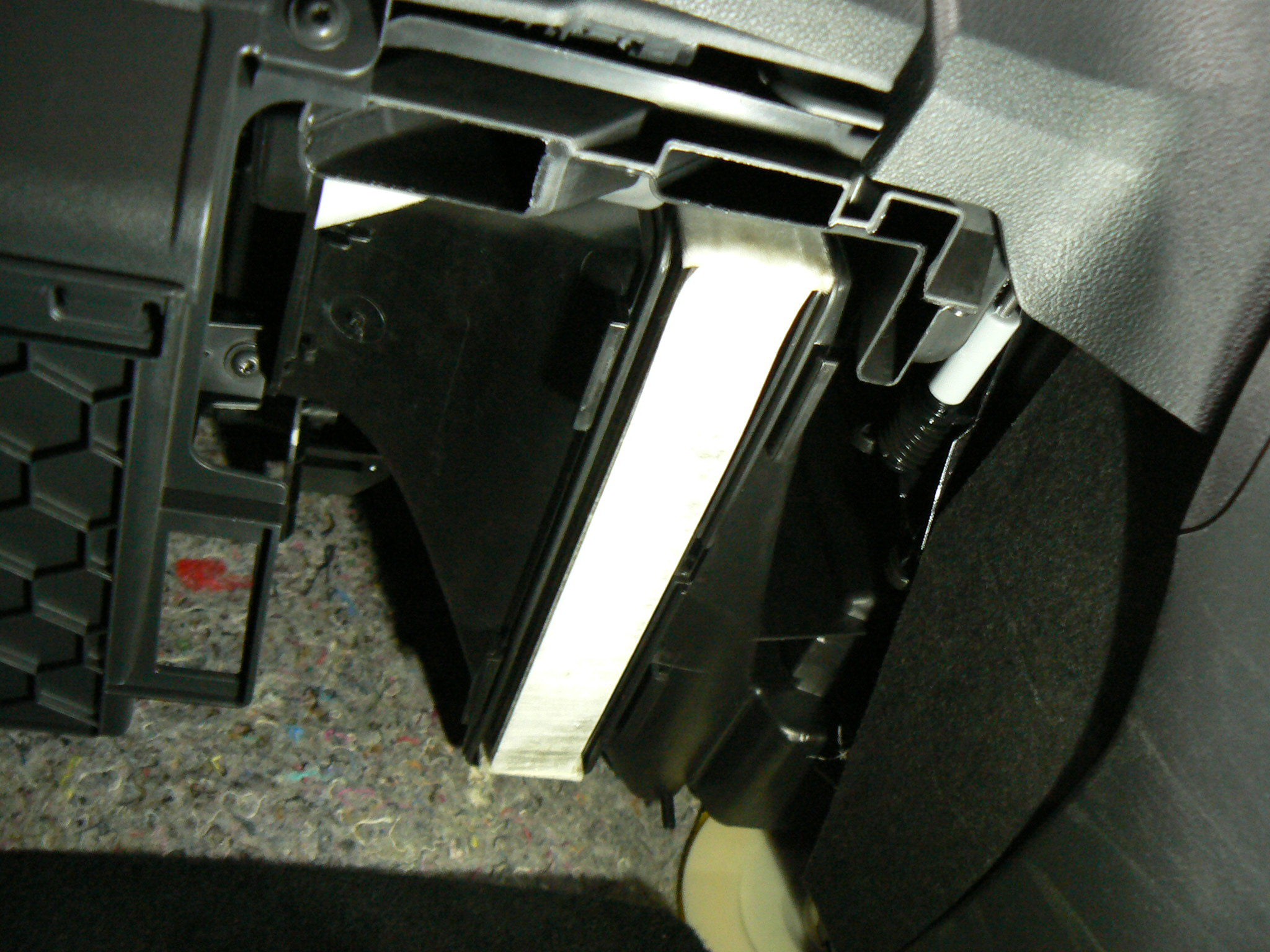

Pull the old filter out downward and push the new one in in it's place:
Once it's pushed fully home place the cover back in position and slide the clips outwards to lock in place
Took me less than 5 minutes and this was the first time. probably a 2 or 3 minute job next time.

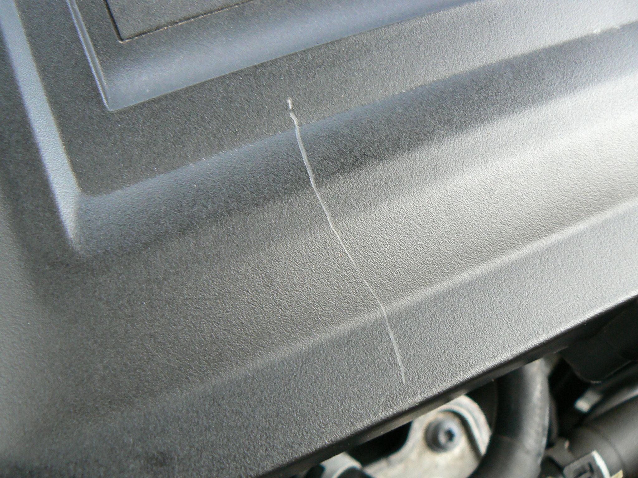

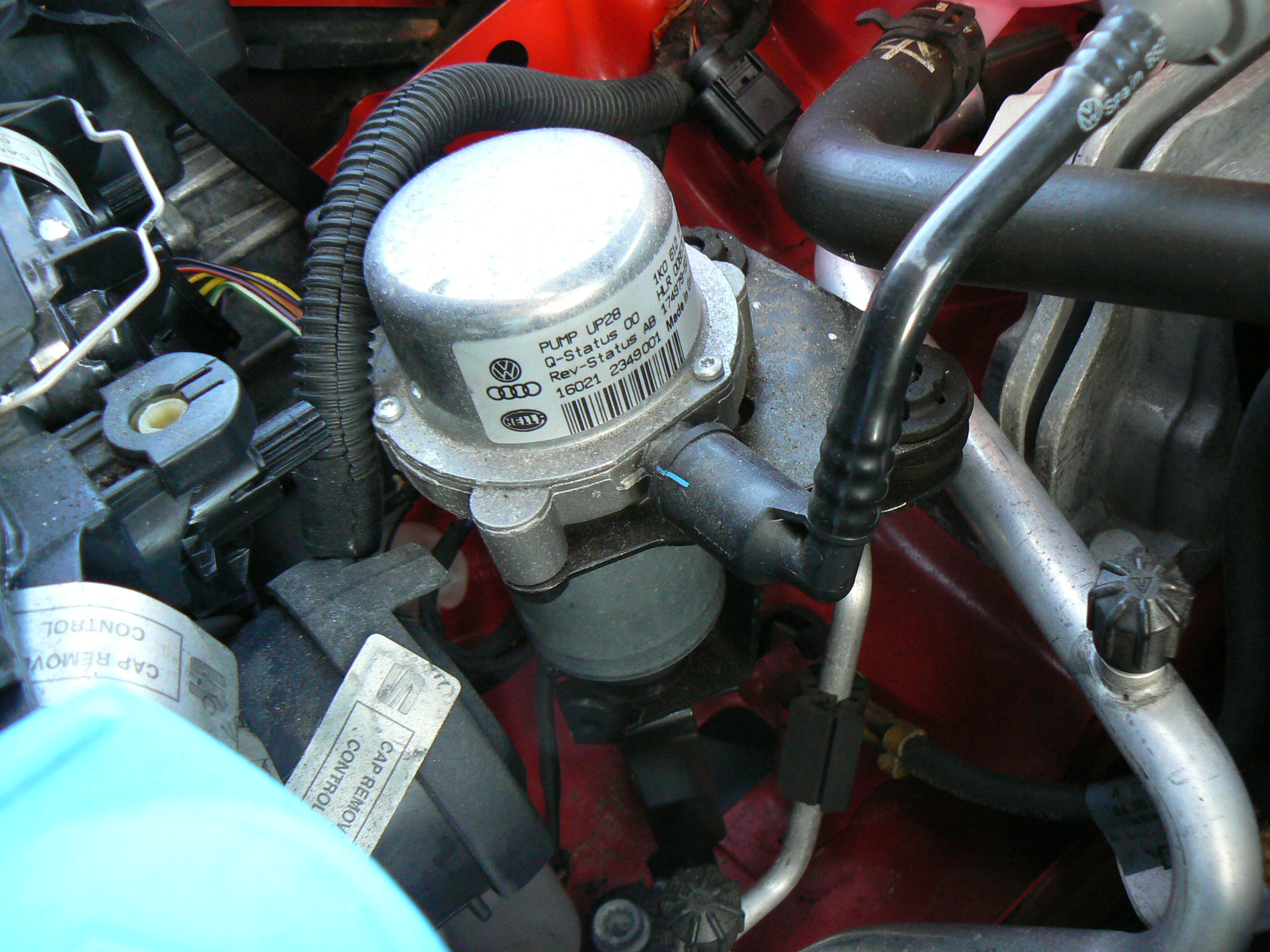

As a wee puzzler for you, guess what this is? it caused me to use the little grey cells for a few moments. Clue: the hard black nylon pipe coming out of it.
Hi Jock,
I've had some luck with using a hot-air gun to remove scratches on plastic mouldings, just heat carefully and pat/rub with a clean cloth to blend it away.
Although some modern mouldings have a thin coloured layer e.g. silver on a different colour base material - is your filter housing the same colour throughout?
I've used coarse emery cloth to reproduce the pattern on scraped bumper corners on the older Opel/Vauxhalls having heated the area with a hot air gun.

Thanks for the tip on repairing that scratch Al. I've seen videos on repairing plastic in this way but never had occasion to try it out. On reflection I think I'll just "get over it" and leave as is.
Anyone venture a guess at the Mystery Object? I'll leave it for you to think about.

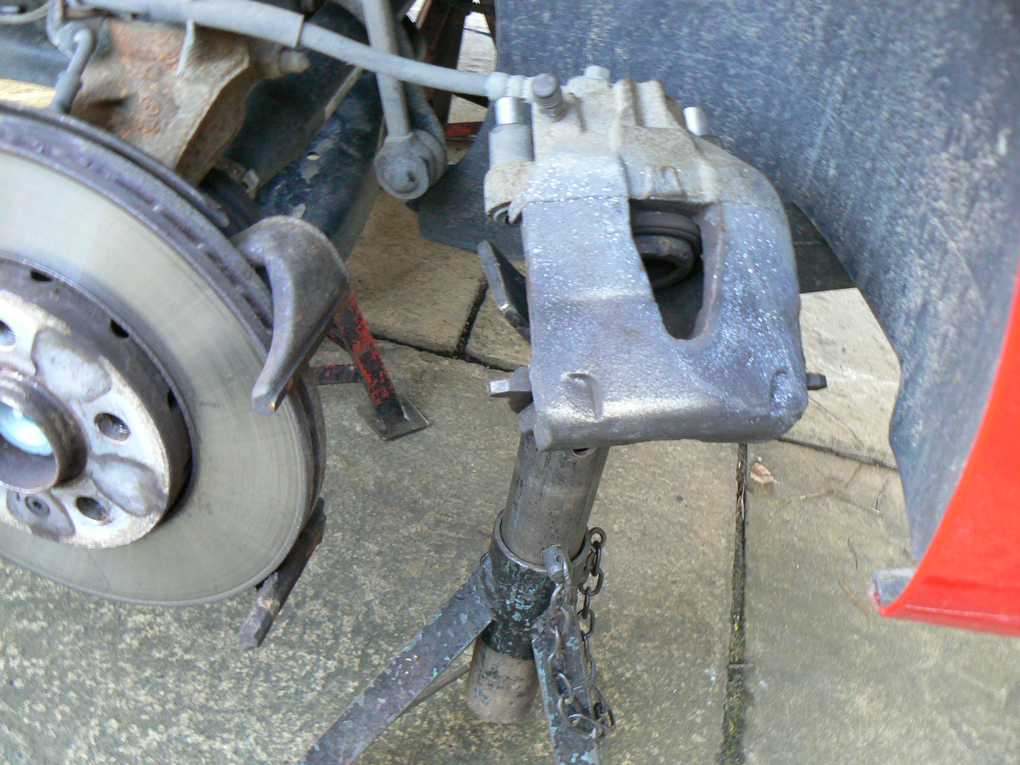

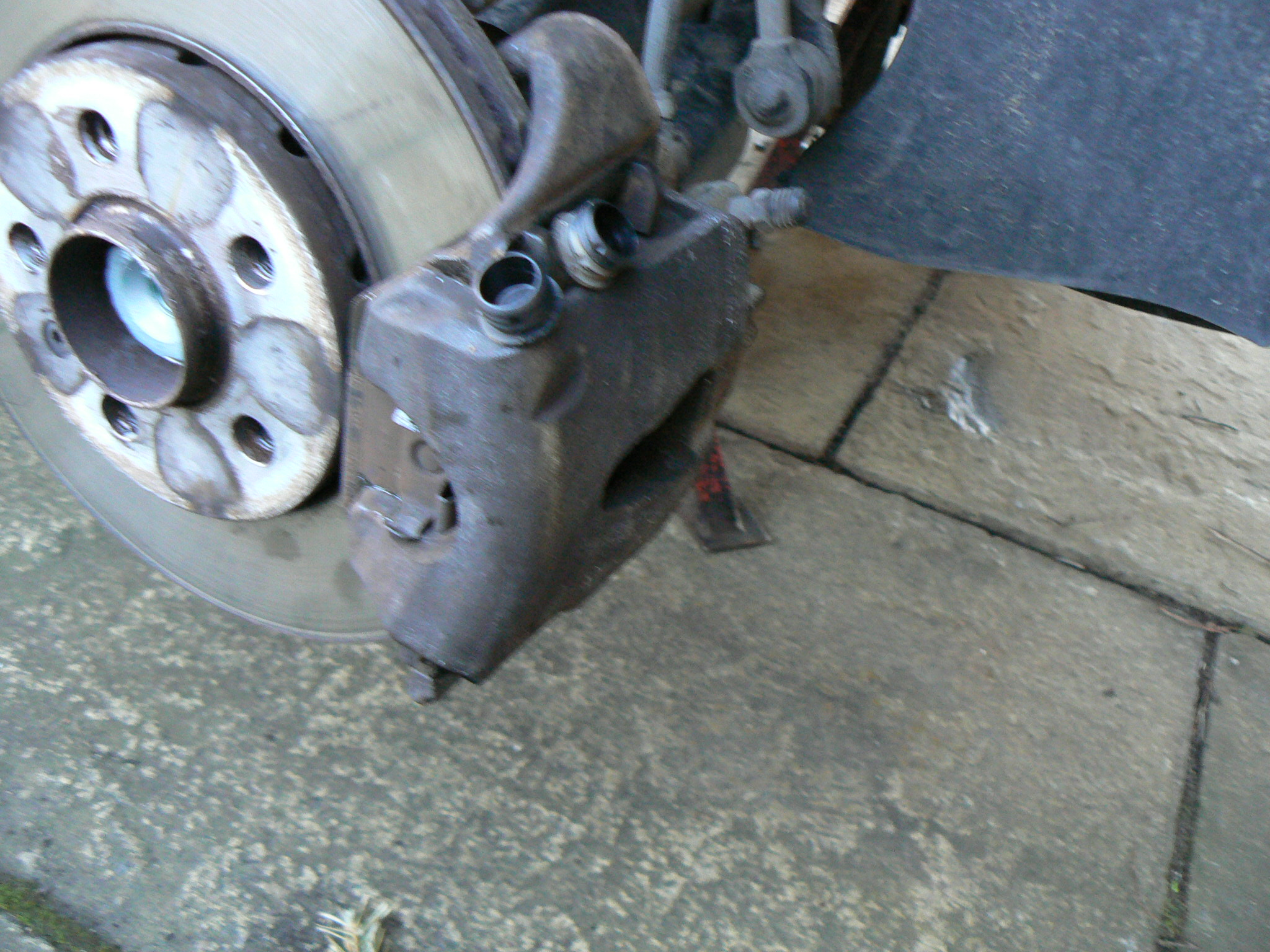

So now for the brakes. With the front end up in the air to do the oil change it was logical to just carry on and attend to the front ones first. I'd had the front wheels off before so there was no problems with that - unlike the rears, more on them later. Just as good practice I like to remove the calipers and pads then clean everything up at the yearly service. I find that this ensures less in the way of problems further down the road.

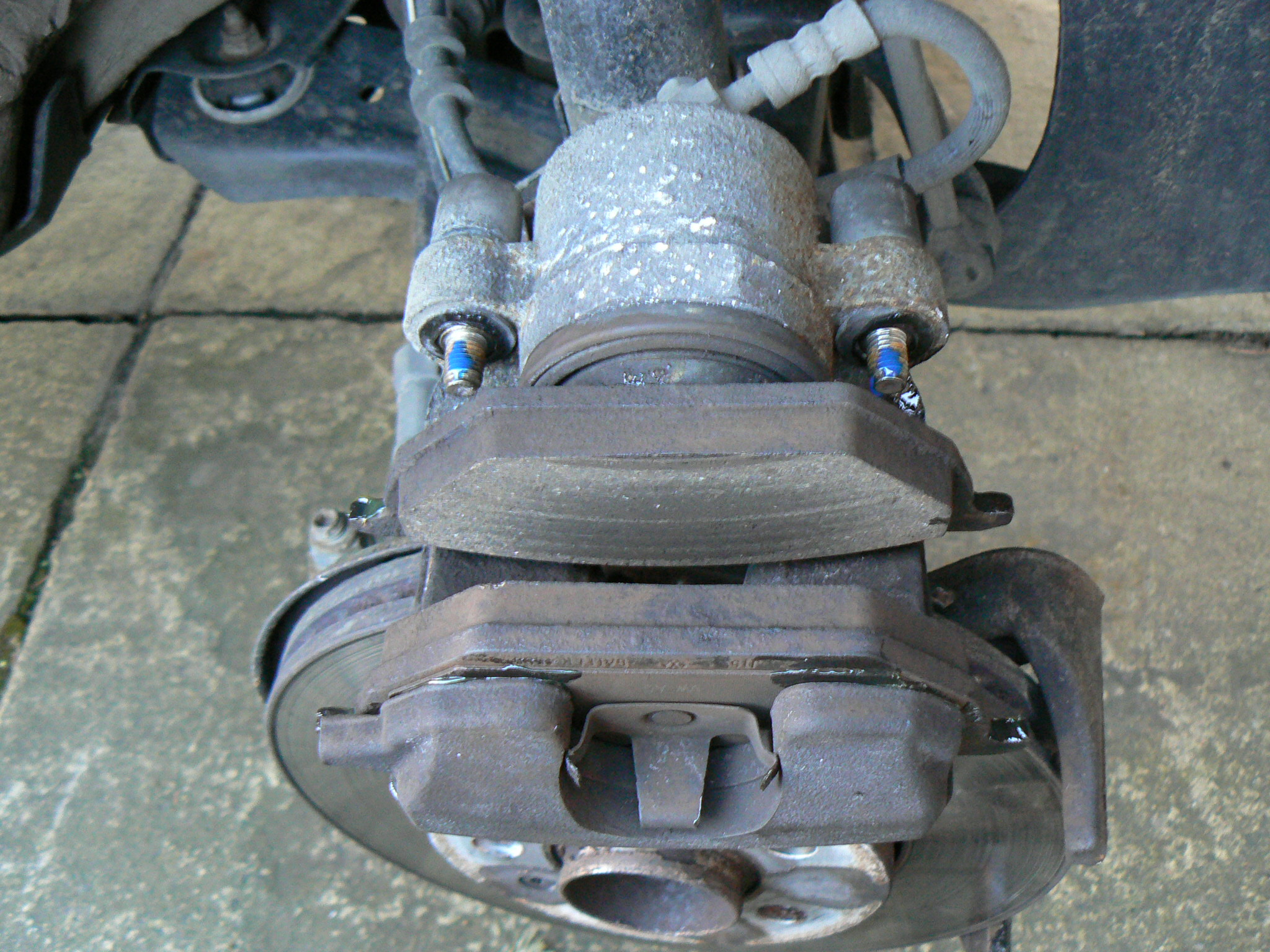

I started on the O/S and easily removed the little plastic dust caps then removed the slider pins with a hex key. They unscrewed easily and I was able to now rock the caliper to force the piston back and pads slightly away from the disc. Usually it's simply a matter of then pulling the caliper away from the disc but, although it felt free, the caliper refused to be removed. It felt like when a disc has a very pronounced wear lip on it's outer edge, but not so, this disc was in good condition (18,000 miles on the clock). Pads look only about half gone too.
Ok Jock, don't get "brutal" lets have a closer look? Oh, that's unusual, on the bottom of the caliper casting there is a little projection which is engaging the bottom of the pad carrier:
So the caliper's top edge has to be pulled forward first then it can be pulled up to allow this little "foot" to clear the carrier bar. Sneaky! So now the caliper is off and resting on a spare axle stand so that no weight/force is taken on the brake hose:

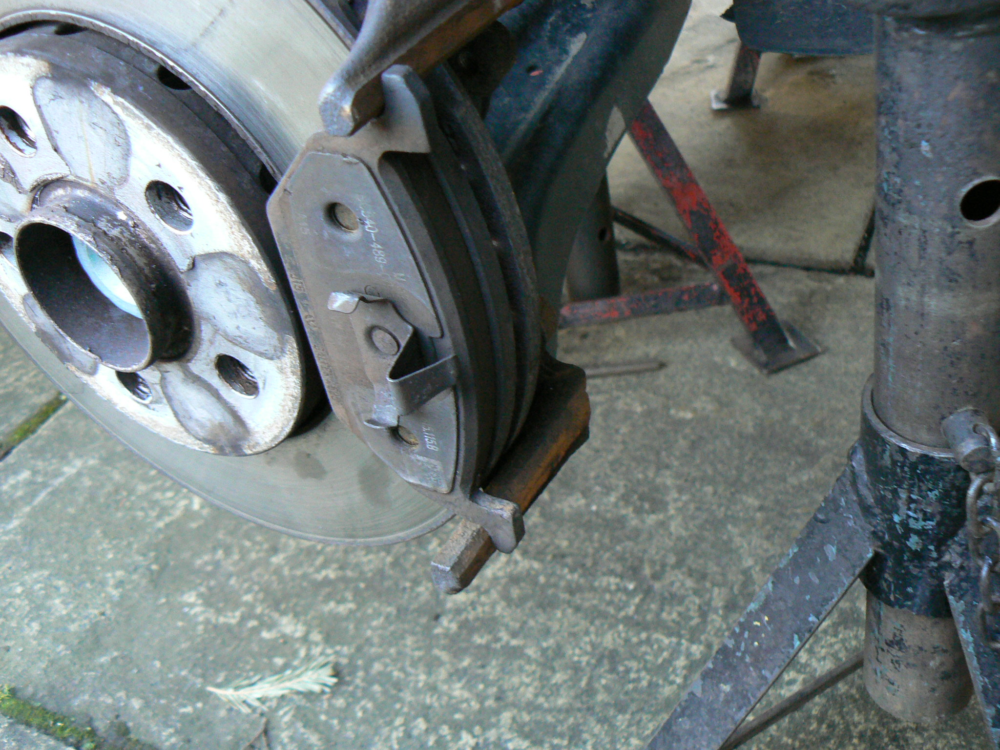

I've popped the pads back onto the discs just so you can see how the pads sit when fitted:
The caliper in this design is there to simply force the pads against the disc when you stand on the pedal. The actual braking force, when the pads grip the disc, is taken through the carrier bars the pads are resting on - at top when reversing and and bottom when going forward.

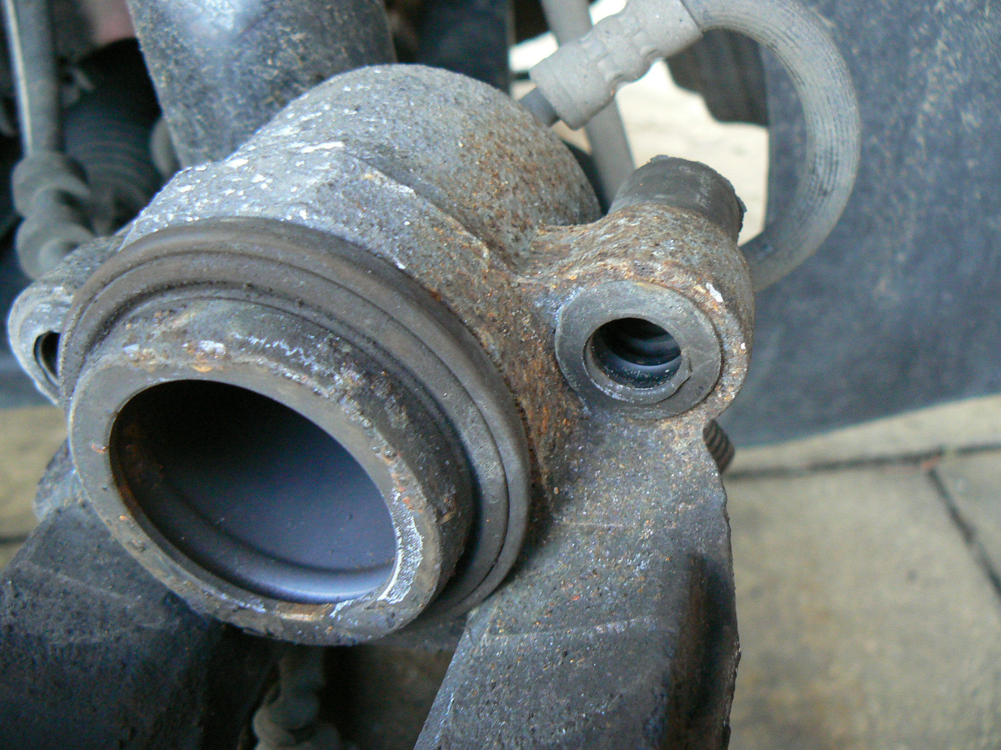

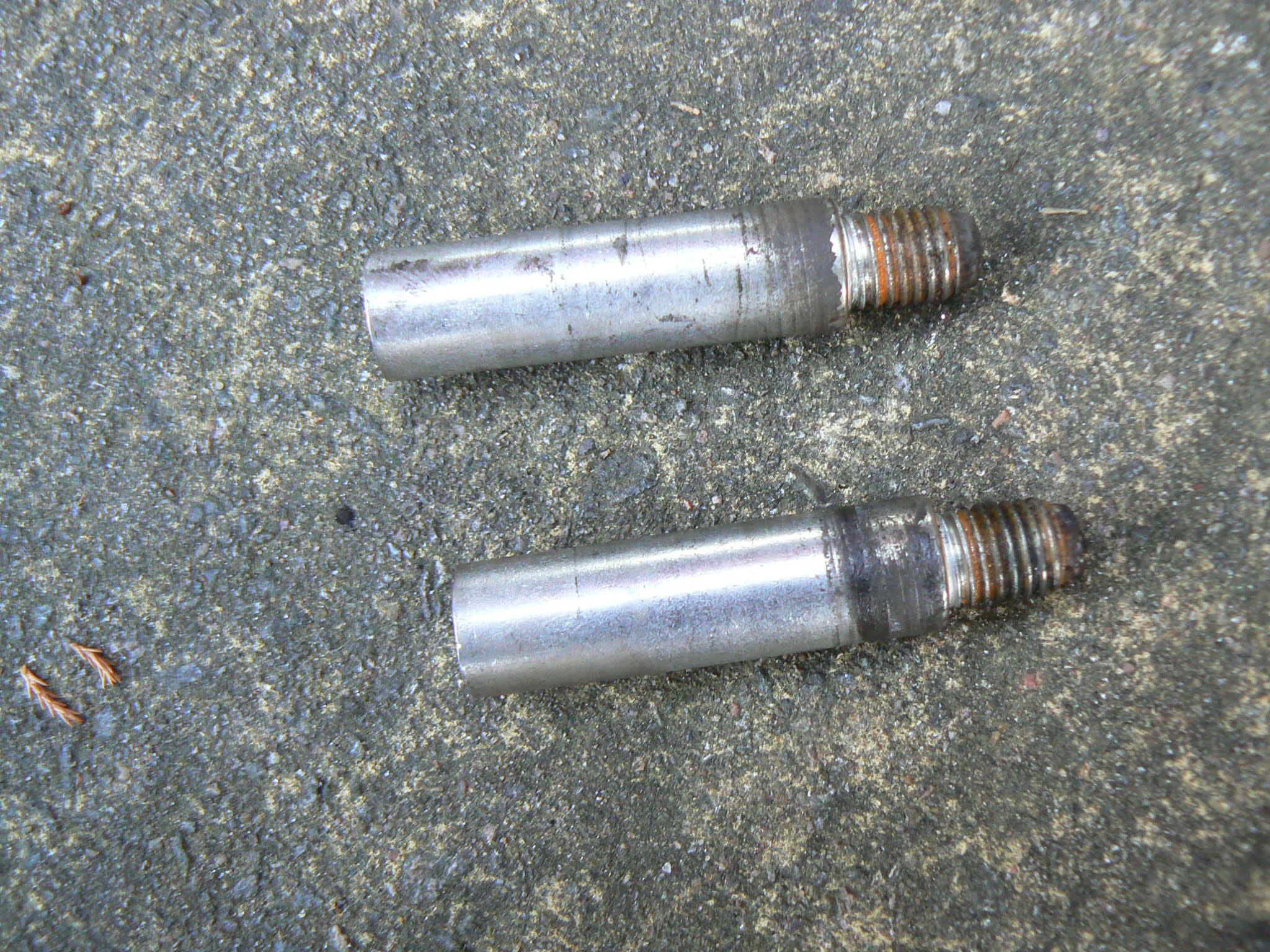

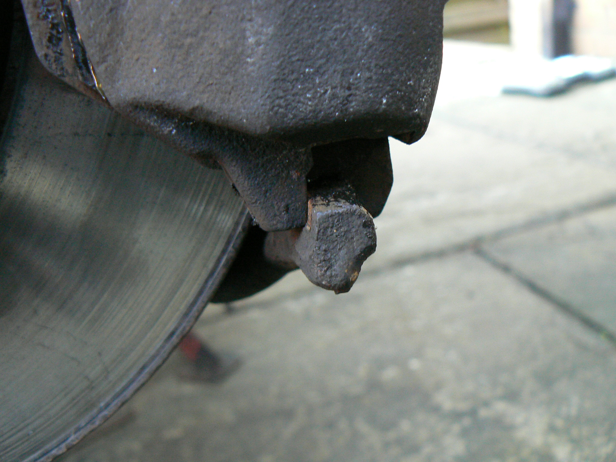

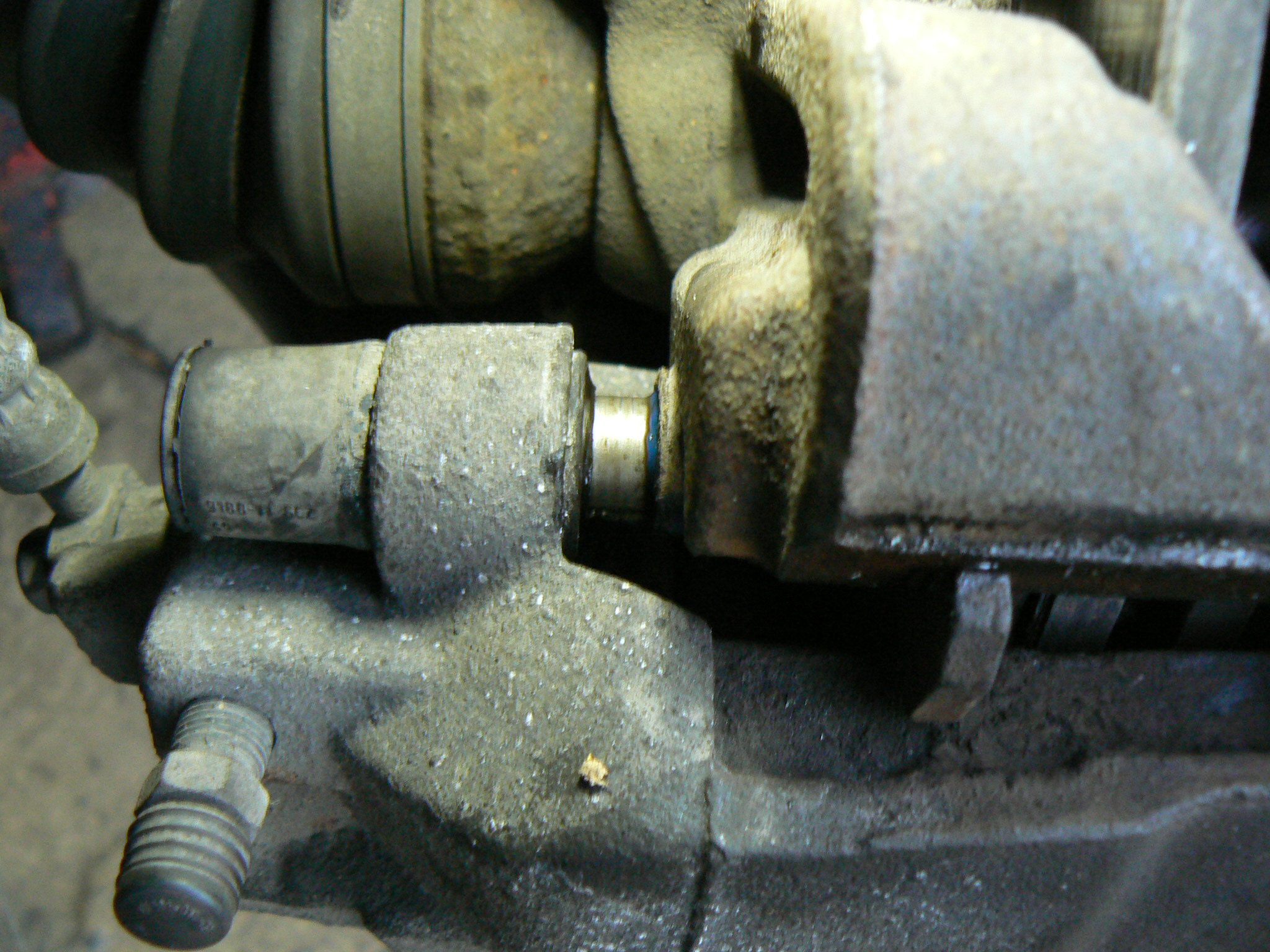

Oh deary me, The top slider pin feels a bit "stiff" to undo. Don't like the feel of that, but it comes out and doesn't look really any the worse for wear. Bottom pin? a different kettle of fish. It breaks away and turns for almost a complete revolution quite freely, as you would expect, but then quickly, over about 3/4 of a rev goes quite tight. ooooh, don't like the feel of that at all! Slaister the now exposed bit of thread with plus gas and squirt some up the hole on the other side the best I can (disc is in the way) then, in the time honoured fashion, I start winding it in and out, in and out, in and out, coming a little further out each time and squirting lots of Plus Gas over it as I go. It doesn't really get any tighter but it fights me down to just about the last turn of thread. I'm dreading what this is going to leave me with as the slider pins on this design screw straight into the hub itself - no separate caliper carrier bracket like wee Becky.
So finally the pin is out and I'm able to remove the caliper, remembering to tip it forward at the top to disengage that bottom foot. Easy when you know! At this point I was so worried about what I was going to find I forgot I'd taken the camera into the garage with me - sorry folks - Now I can get a good look at the threads in the casting where the slider pins screw into. Oh well, the top one looks really pretty good, definitely serviceable, great! The bottom one looked a bit "chewed". Wonder what the pins look like? Oh, that's interesting, both threads are copiously covered in a red thread locker. The ones on the O/S had traces but nothing like this "deluge"-?- Cleaned up with a wire brush and now I can see there's an imperfection on the start of the thread on the bottom pin! Looks like the sort of thing that might have happened when in a parts bin, dropped from a height, hit a glancing blow with a hammer or similar - you get the idea?

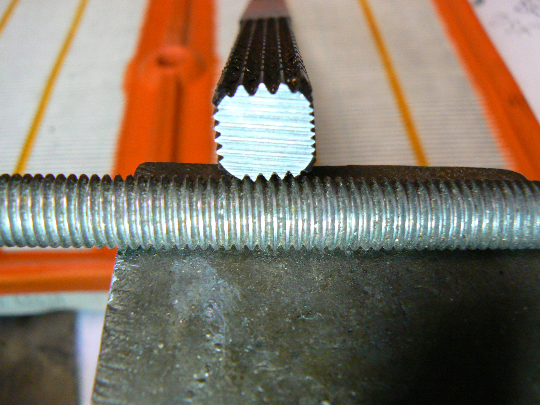

So this is what's been causing the problem. Ok, I'll just run a die down the thread and that should make it good as new seeing as it's only the very end of the thread that's damaged. Got out my big box of taps and dies, accumulated over my 50 something years of "doing" cars and guess what? don't have anything which fits! My flabber is gasted! I've never had this happen in years. A metric 8 is too small and a 10 too big! Must be a 9? Can't remember ever running into a 9 before - not one requiring attention like this anyway, mind you the hex key size for the slider pin is seldom used size too. Then I remembered I've got a thread file. That should do the job!

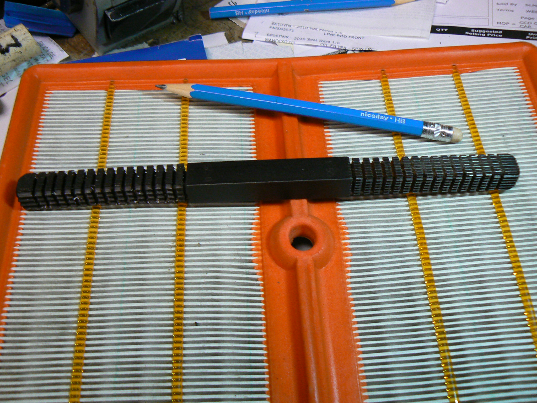

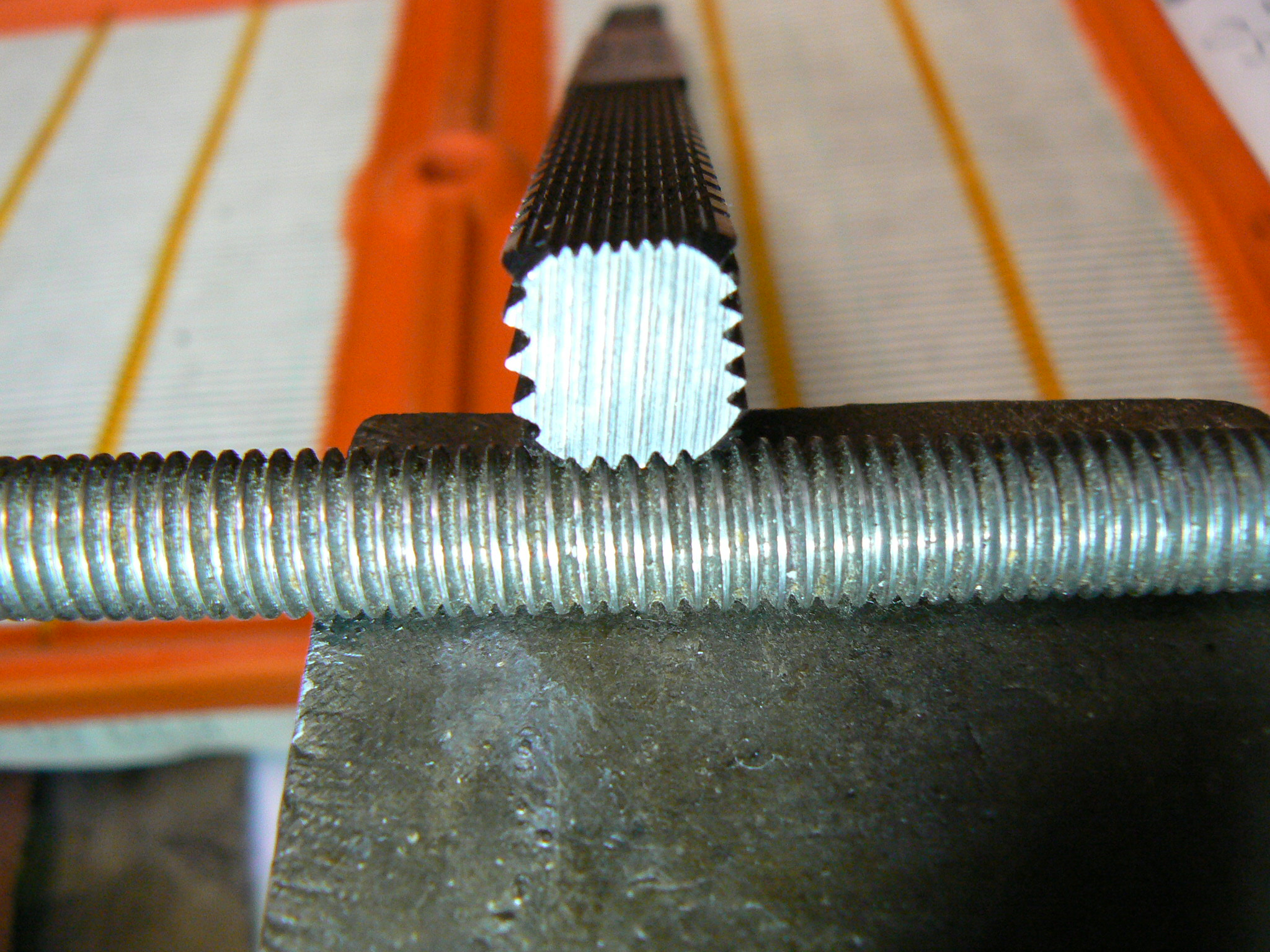

Thread file? I hear some say? Yes, a wonderful addition to any serious car menders tool box but very brittle, 'cos it's hard metal, so keep it protected when not in use or you'll find teeth get knocked off! I've got a metric and an imperial one - hardly ever use the imperial these days except on my vintage horticultural stuff. Here's the metric one with protecting bits of plastic pipe on the ends:
And here's what it looks like ready for action:
Each side - there are 8, 4 on each end - has a different thread pitch. You offer it up to the tread you are trying to repair (by the way you can't really make a thread with one of these, it's just for repairing imperfections. You need a die to actually cut a virgin thread) Keep trying the end of the file against your thread like this:
Until you find one that's a perfect fit:
In this case its a 1.25 pitch (each side of the tool has the relevant size marked on it) Then you just stroke it over the thread like any other file and the wee teeth will cut out the imperfection whilst engaging with the good parts of the thread to ensure a correct spacing.
Anyway, using this I was able to restore the damaged thread tooth to neigh on perfection. The problem then was what to do about the female threads in the hub? really need a tap to do this and I don't have one! The top one really needed little attention an so I just would the slider pin, with Plus Gas, in and out a few times and it cleaned up lovely. It was just Thread locker residue that needed cleaned out really. Sprayed with brake cleaner and it looked lovely! The bottom hole was not really so nice though with visible damage but plenty of thread still there. What to do then? I decided in the end to try lapping it with valve grinding paste and, if I wasn't happy then I'll have to buy a helicoil, or similar, kit.
So I cleaned out all the residue I could and, carefully centering the pin, with some course paste on the thread and in the hole, I started winding the pin in and out, in and out, in and out going a little deeper each time until it was winding in and out for the full depth of the thread. Cleaned it all up with brake cleaner and tried it in the hole. Doesn't feel too bad actually! took it out again and had a good look at it all. The pin looks perfect. The female thread has some damage especially over about the first 1/3 of it's depth but further into the hole it actually looks quite good. Ok then, am I happy with this? Hmm? Let's try torquing it up. Ok, that went fine, felt good, no sign of "give" in the thread. If it behaves like this on reassembly think I'll go with it.

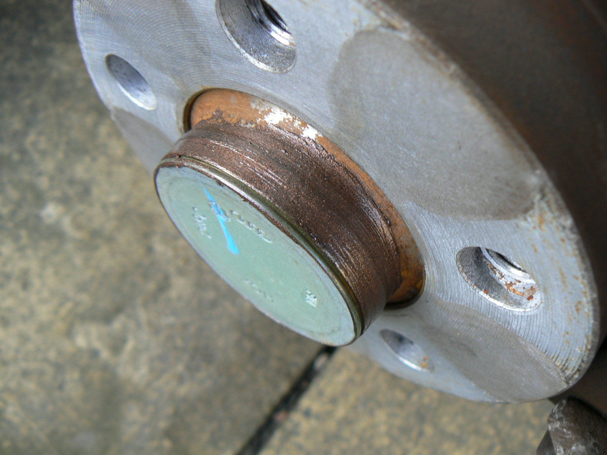

I was paying a lot of attention during the reinstalling of the slider pins and I noticed that the spring retainers on the back of the pads tend to push the caliper slightly forward making it easy to cross thread the pin in the hole! It's easily overcome by pushing hard on the front of the caliper to keep it in place as you start the pins in their holes. Now I know that I'll be taking especial care each time I have them out. So now everything is assembled with thread locker applied to the pin threads and I've got the torque wrench ready to go. Will it tighten or will it strip? Yippee! tightened up a treat with a very positive and abrupt click. not a hint of stripping.
Now assembled it can be seen why that band of corrosion forms on the slider pins:
They are exposed to the elements when installed! Put a little extra silicon grease on them just for luck.

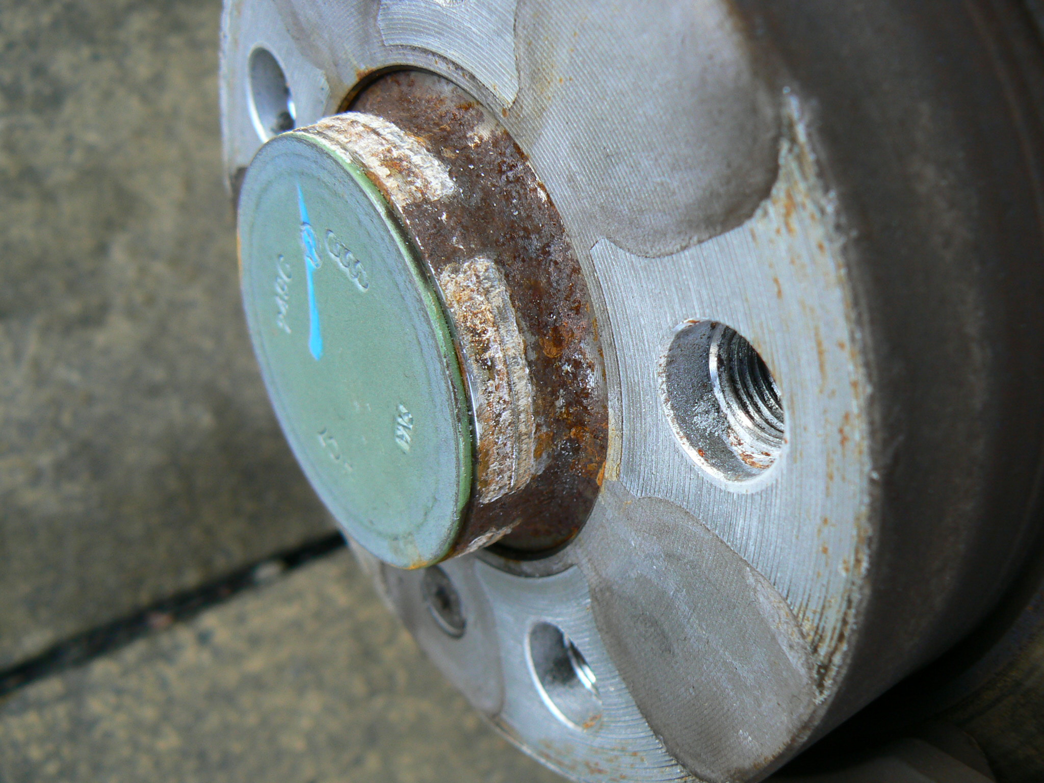

Having "done" the fronts I then moved round to the rears. Very familiar with this setup as I've run into them on many VAG vehicles. Older ones tend to suffer from "sticky" handbrakes which cause the rear brakes to not release fully. Regular maintenance is a big part of preventing that but the return is not strong on them and you can fit return springs from other models in the range on top to increase the spring force - lots on you tube if you're interested. With mine being relatively new I was not expecting any problems and things went well. The only problem I did have was that the rear wheels had obviously never been removed since she was new - what exactly do the dealers do except change oil and filters? - I ended up on my back under the back of the car, with axle stands and trolley jacks all supporting on both sides, Kicking ten shades of ***** out of the wheel rims then coming out and belting the front faces with my big rubber hammer and some padding to avoid marking the alloys, until they finally fell off. Here's what the hubs looked like:
Doesn't look too bad does it? but boy did it take some kicking! A good wire brushing and rubbing with some emery, inside the wheel too, then a light skim of anti seize and that won't happen again.
Mystery object will be revealed in the next post. Another clue though if you haven't got it yet? It's a turbo'd engine.
I'll finish this one here but the brakes were a little more interesting so I'll be back to tell you all about it soon.
That looks like one of those new-fangled electrically-powered vacuum pumps to support the brake booster if the engine does not supply sufficient vacuum under certain operating conditions.

Hi Jock,
Re:- the use of Thread Restorer Files, I'd like to suggest that the file is not used at exactly 90 degrees to the thread being cleaned up but instead is swivelled a very tiny amount so that the file teeth match the angular slope of the thread.
Iirc, there was mention of thread files a while back, possibly in the 500 (Classic) section - I posted there are also thread-files that have a cylindrical extension on each end with different thread pitches that can be used for chasing internal threads e.g inside housings, large nuts.
I still haven't found one of mine of this type to post a pic in order to better explain, nor have I found the home-made oil filter removal tool that used a section of Fiat timing belt - but I'm still searching :rolleyes:
Al.
Give the man a coconut! Well done Al, Right first time. Must admit I had to think about it for a wee while. That hard nylon? hose goes to the servo but also splits off and goes to the inlet manifold so, unlike most diesel, there must be manifold vacuum available some of the time. There are non returnvalves in both branches. I haven't had the trunking from the throttle body off yet (maybe never will?) but I'd guess there's a butterfly in there somewhere.
Hi Jock,

Absolutely Al, file in line with the helical slope of the thread or you'll slightly reduce the "thickness" of each individual thread - although probably not by enough to make any significant difference. Still, if you're an obsessive perfectionist like me?
That's interesting about the "internal" thread files. I've never seen, or heard, of one of those. Must look into it - although I've managed all these years without one so probably a bit late for this old dog to change his spots.

So there you are, Al won the coconut! The "mystery object" is indeed an electrically driven vacuum pump. Oh dear, more complication and, no doubt, expensive to replace should that become necessary. You can hear it running when the engine is first started but I'm not really aware of it subsequently. I doubt if you could hear it on the move and, although it is not noisy, I would think it would be audible sitting at traffic light stops etc and I can't say I've ever heard it, so maybe it doesn't have to run very much.

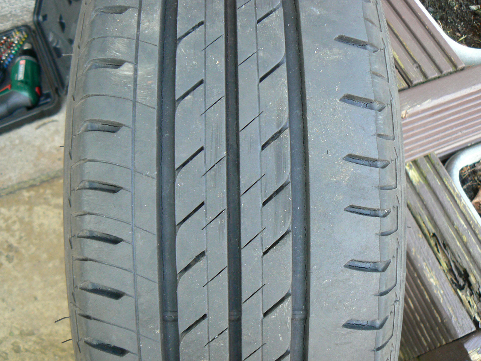

This may be a strange thing to say but I'm frustrated at how slowly those darned Bridgestone tyres are taking to wear out:
At just over 18,000 miles the tread depths on the fronts, in millimetres, are 5,5,4 (taken in each of the grooves outside to inside) identical readings on both front tyres (ie. inside edges very slightly more worn and identical depth readings). So the inside of the tread is wearing just a little more than the outside, which doesn't particularly surprise me. Most modern suspensions run a slight negative camber on the front and the natural action of the front wheels under braking is to splay out very slightly due to give in the rubber of the bushings. If you want something interesting to do when walking around city streets take a look at any front front tyres you can see the whole width of tread on. Most will be more worn on the inside. A very good reason to keep a regular check on your own vehicles tyres. Don't just glance at the outside edge - which you will see easily with it parked at the kerb - and assume the whole tread width is going to be the same. Turn your steering onto lock each way and examine the whole tread width (you don't need to go full lock, just enough so you can easily see the whole tread width). Of course if you see uneven wear AND tread lipping then you've got a problem and need to get your geometry checked - I see no lipping on mine. The rears are, unsurprisingly, wearing even more slowly. They show 5,6,6 mm. Wear is absolutely identical on both sides but the greater wear is on the outer shoulders here (opposite of the fronts) This puzzled me for a wee while - The car drives beautifully with no tendency to pull one way or the other and, when I've followed it in Becky, it seems to drive absolutely straight (ie. no sign of crabbing). As a result of taking these readings I stood well back from the car once I'd finished and it's quite obvious that the rear wheel are carrying some degree of toe in. This would account for the wear pattern and I believe is most likely exactly as it should be, however I'll be having a chat with the lads at AVW just to set my mind at ease.
At this rate of wear I doubt if I'll wear them out before they degrade to the point where I'll be changing them anyway. Already there are surface cracks appearing at the base of the tread grooves:
Also, if you do the "thumbnail test" in the tread rubber, it's as hard as old nails! Remember I'm an old tyre man having spent a number of years in my earlier life working, in a technical capacity, for Firestone. Once you know what you're looking for you can get quite a good idea of how "grippy" the tread compound is by pushing your thumb nail into the tread rubber and watching how deep an indentation it makes and how quickly it returns to it's original shape. I'm not impressed with these Bridgestone Ecopia tyres. I don't find they grip very well in the wet - it's easy to experience understeer on roundabouts when it's wet even at quite low speeds - and I find quite noticeably excessive road noise too. I guess maybe the trade off they thought acceptable to give a few extra MPG - and I get 60 mpg on longer journeys - but I'd be happier dropping a couple of mpg to gain in grip and probably loose some tyre life too I suppose.

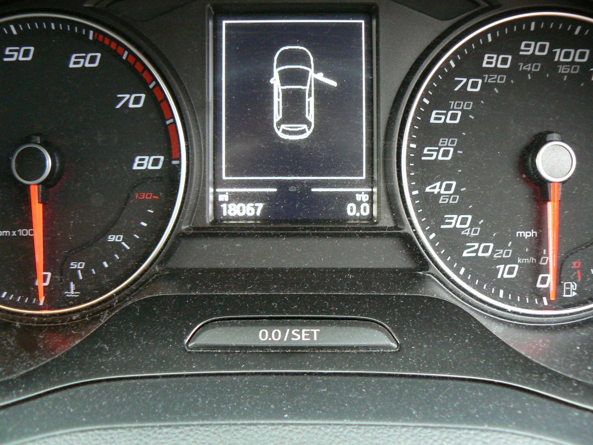

The last thing I can think of to mention is resetting the dashboard service warning. I have VCDS (diagnostic program) so could use that but I noticed the Haynes manual gives a procedure pressing the dashboard buttons. Trouble is my car is a later model so has a different dash to the book's example. Earlier cars have red illumination and my later car has white. Also the buttons between the speedo and rev counter, which are the ones involved, Well mine aren't "buttons" in the plural, but "button", singular:
The book's proceedure will, I'm sure, work on the earlier vehicles but not mine. So I searched You tube and found a procedure for a dash which looks identical but from the LEON? reasoning the electronics are very likely to be "brothers" I tried it. It works just fine. The procedure is:
1) press in that 00/set button and hold it in
2) keeping the button pressed in turn the ign on - no need to start the engine.
3) keeping the button pressed in wait till your choice of reset comes up on the little central display above the button.
4) release, press and again release the button. You're done
You have the choice between the two standard warnings of an "oil service" or an "oil and inspection service". So with the button pressed in and the ign on after a wee while the oil insp will be displayed on the mini screen. If it's the oil and insp you need to reset, as was my case, you just keep the button pressed for longer until oil insp changes to oil and insp. So up till now you will have pressed the button and kept it pressed while turn on the ign and wait for the required message to appear on the miniscreen. When the service you require appears immediately release the button which will select your choice and then press and release the button again to confirm that this is the action to be completed. Nothing else to do. You're done. If you want to double check go to the info tainment screen and punch the CAR button at the bottom of the screen you'll now see a "setup" button? touch on this and from the menu that appears scroll down (it's off the page to start with) until you see "service". Touch on this and you'll see the service intervals the car thinks it knows. If you've done it right the mileages will be big figures (can't remember actual figures but relative to a year/2 years running) and the days will show 365 etc.
Sorry Jock,
I'll have to forefeit the coconut..... :eek:
I cheated by doing a google search for the pump no. + Hella, as shown on the pump label ( I clicked on your pic then enlarged it so I could read the numbers). Couldn't resist, have never won anything in my life - what's that old saying?, oh yeah, 'nice guys finish last'. :D
