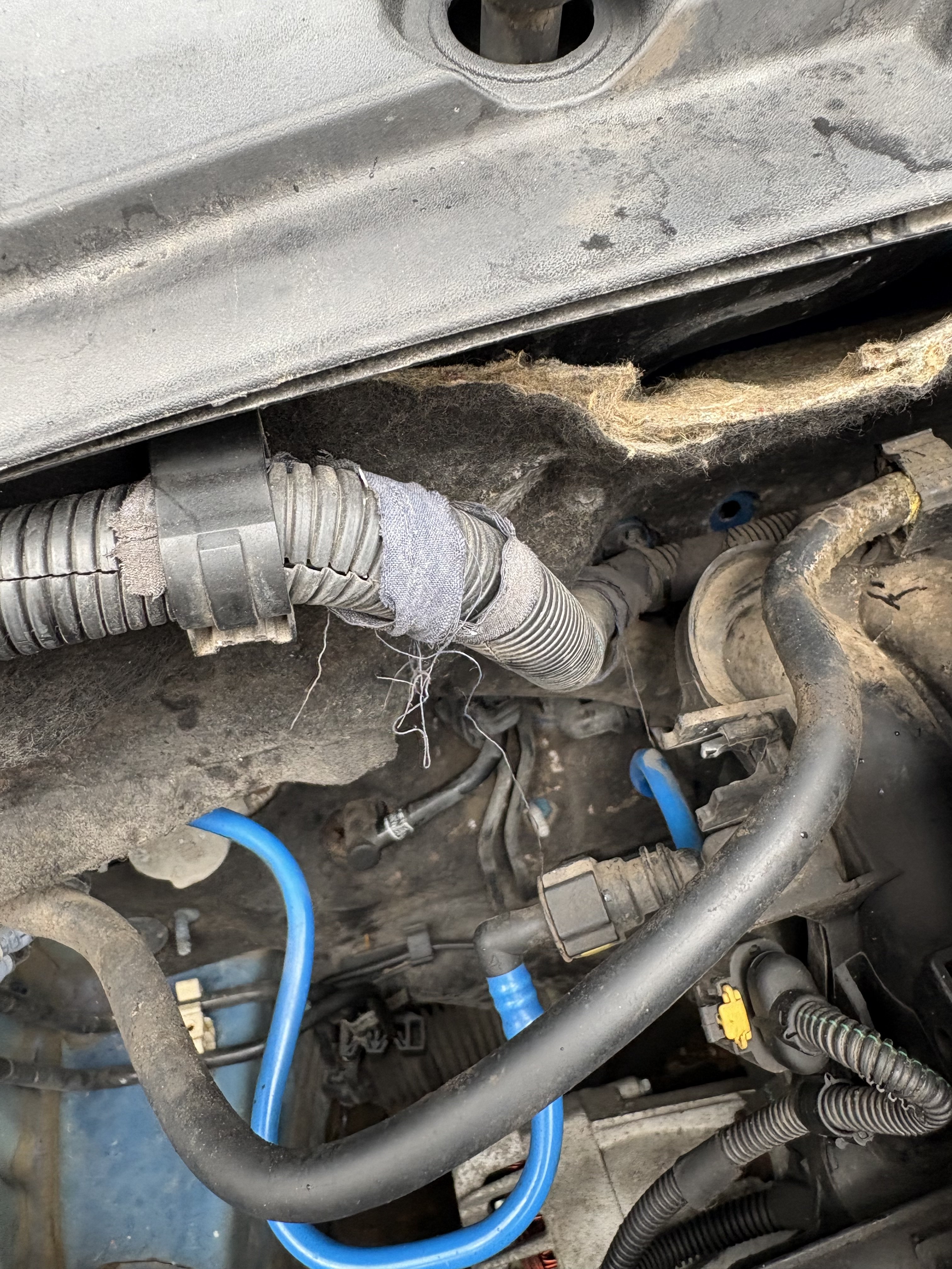

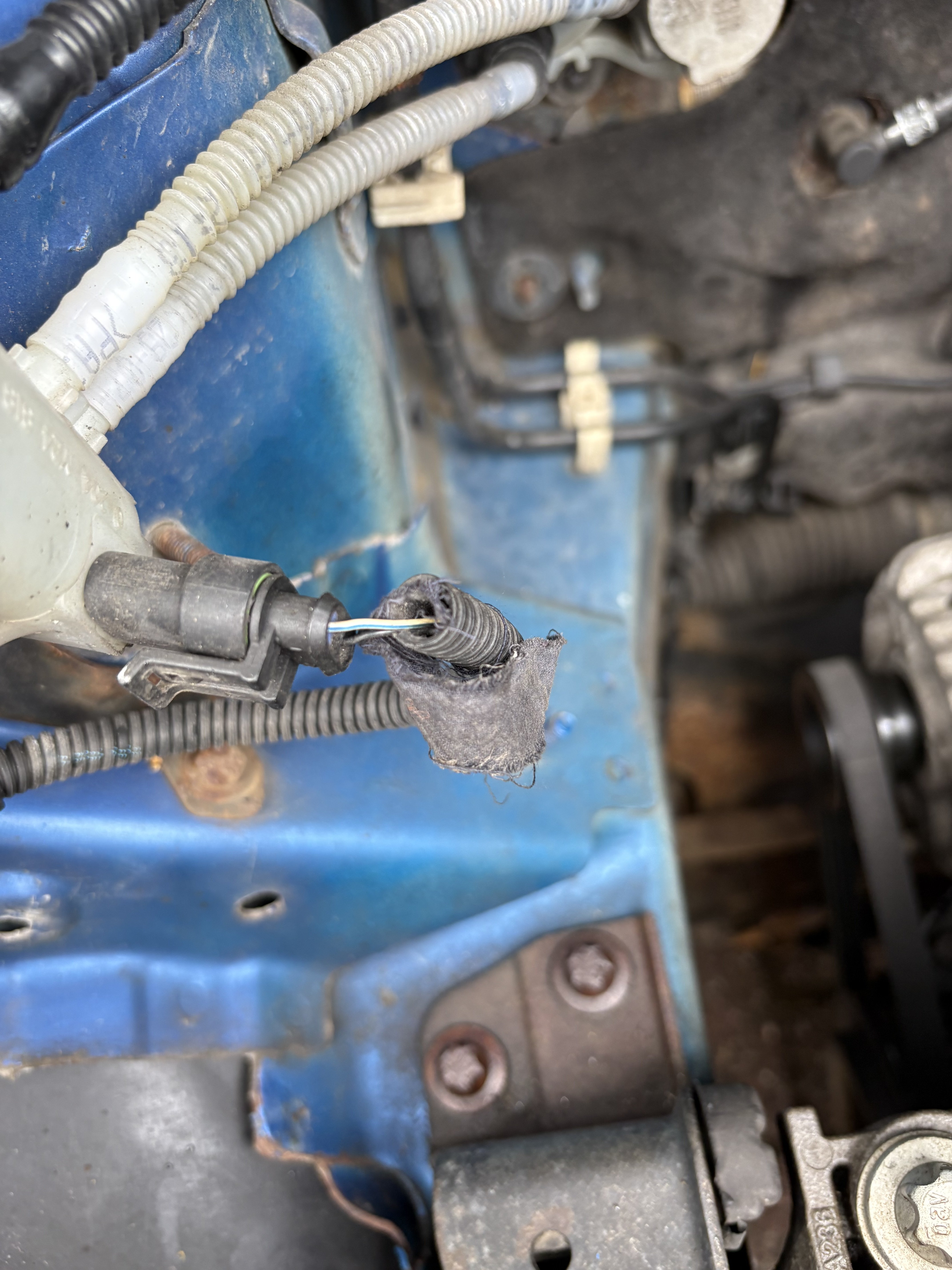

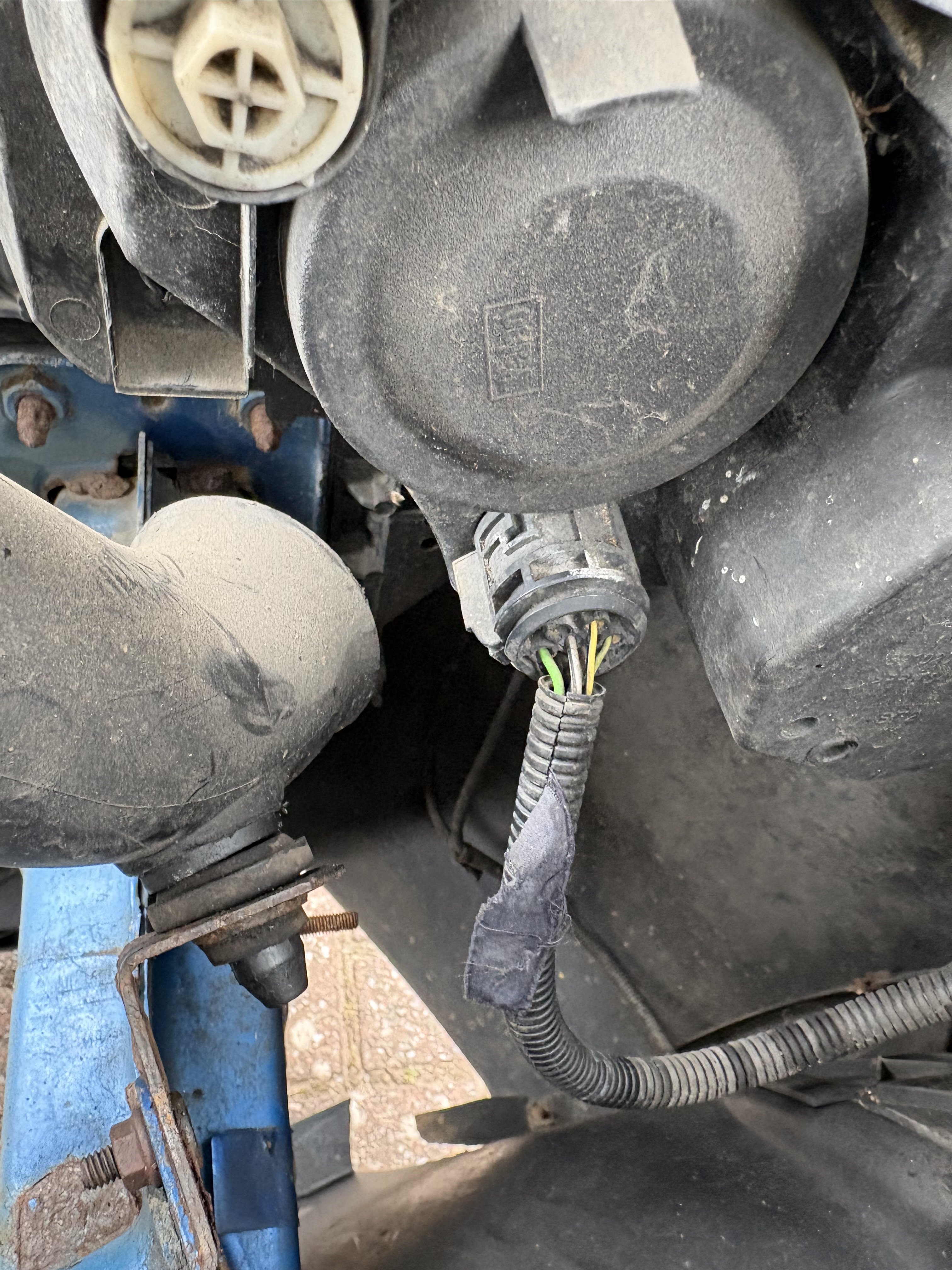

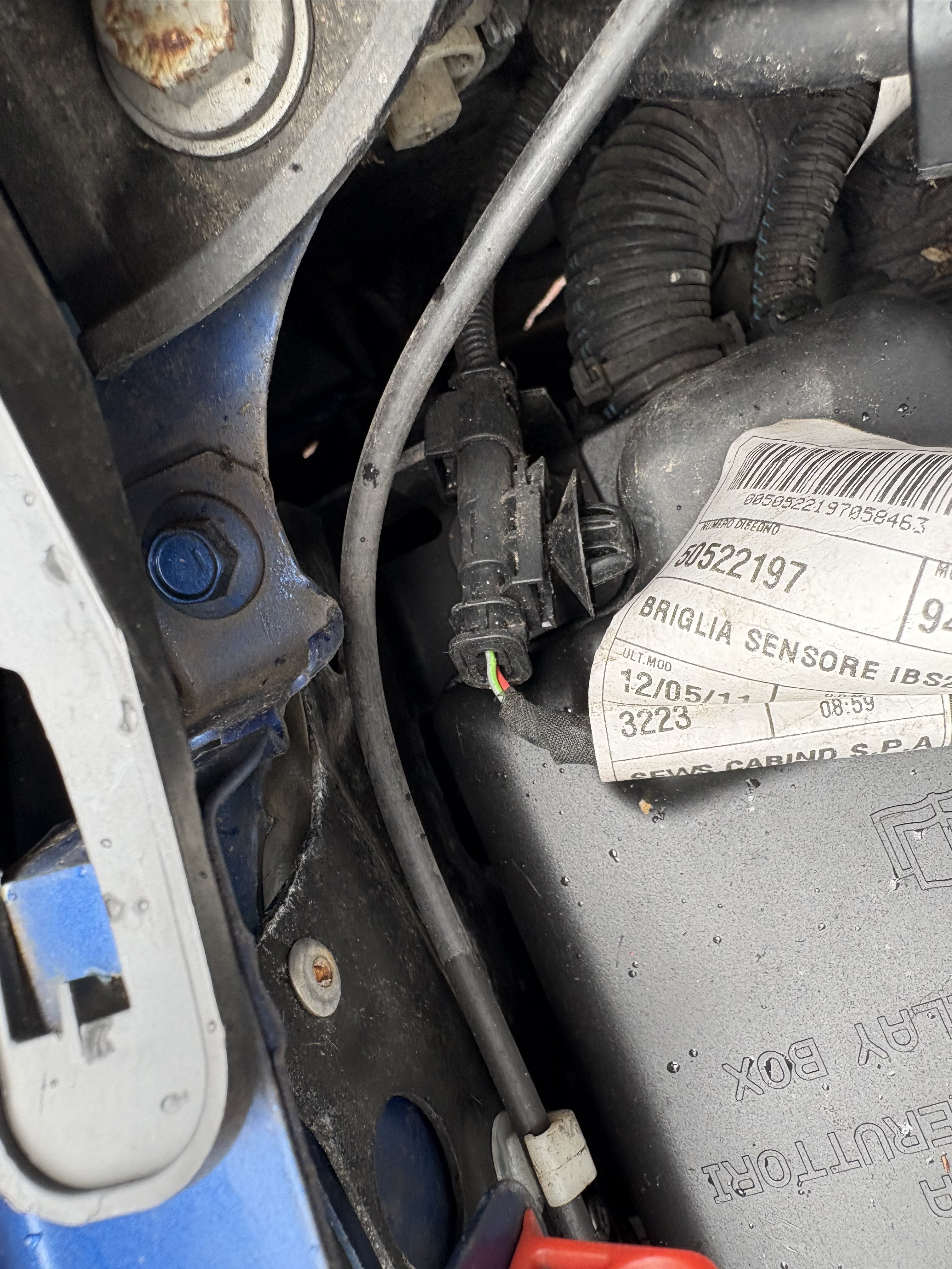

Also a bit concerned with all these uncovered wires? And recommended tapes to cover? Should this have been sorted during the service?
Look at the plastic protective tubing, conduit. There is a cut along the whole length.
This is mechanical protection only, it is not about sealing (wiring must "breathe"). Plus the split let's you repair the loom (replace one wire etc.).
By wrapping the exposed ends with electrical tape, you can make it worse, mechanically concentrate stress precisely at the exposed wires (unless you also glue the tape itself to the part (lamp housing, or whatever). Let the conduit move a bit (leave ends free like factory does).
But not too much movement (exposed wires should not hold, support the wiring harness weight), like conduit flapping around the engine bay.
Those torn cloth tape pieces are mostly cosmetic issue at this point. You can remove them or replace (doesn't matter much).

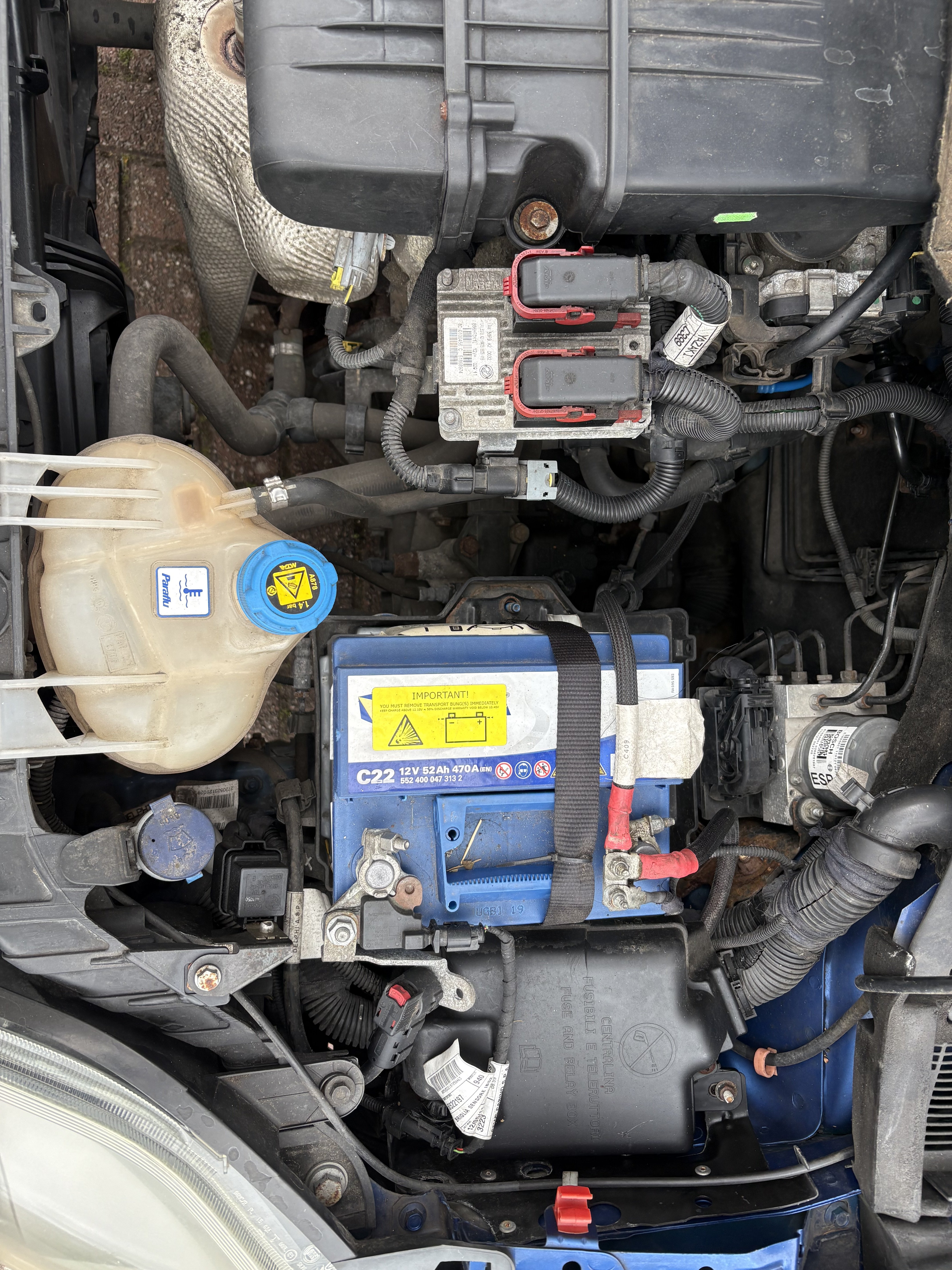

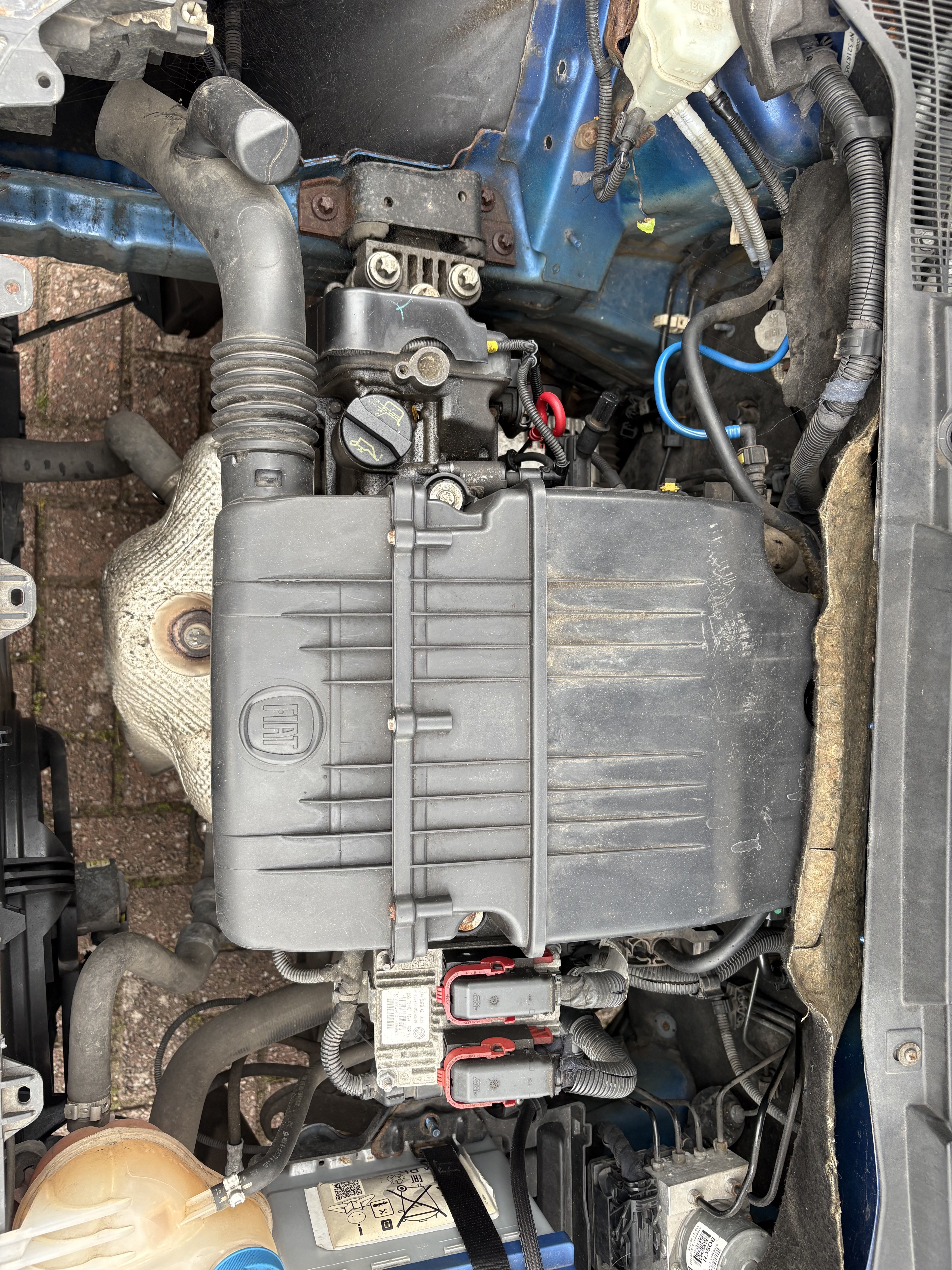

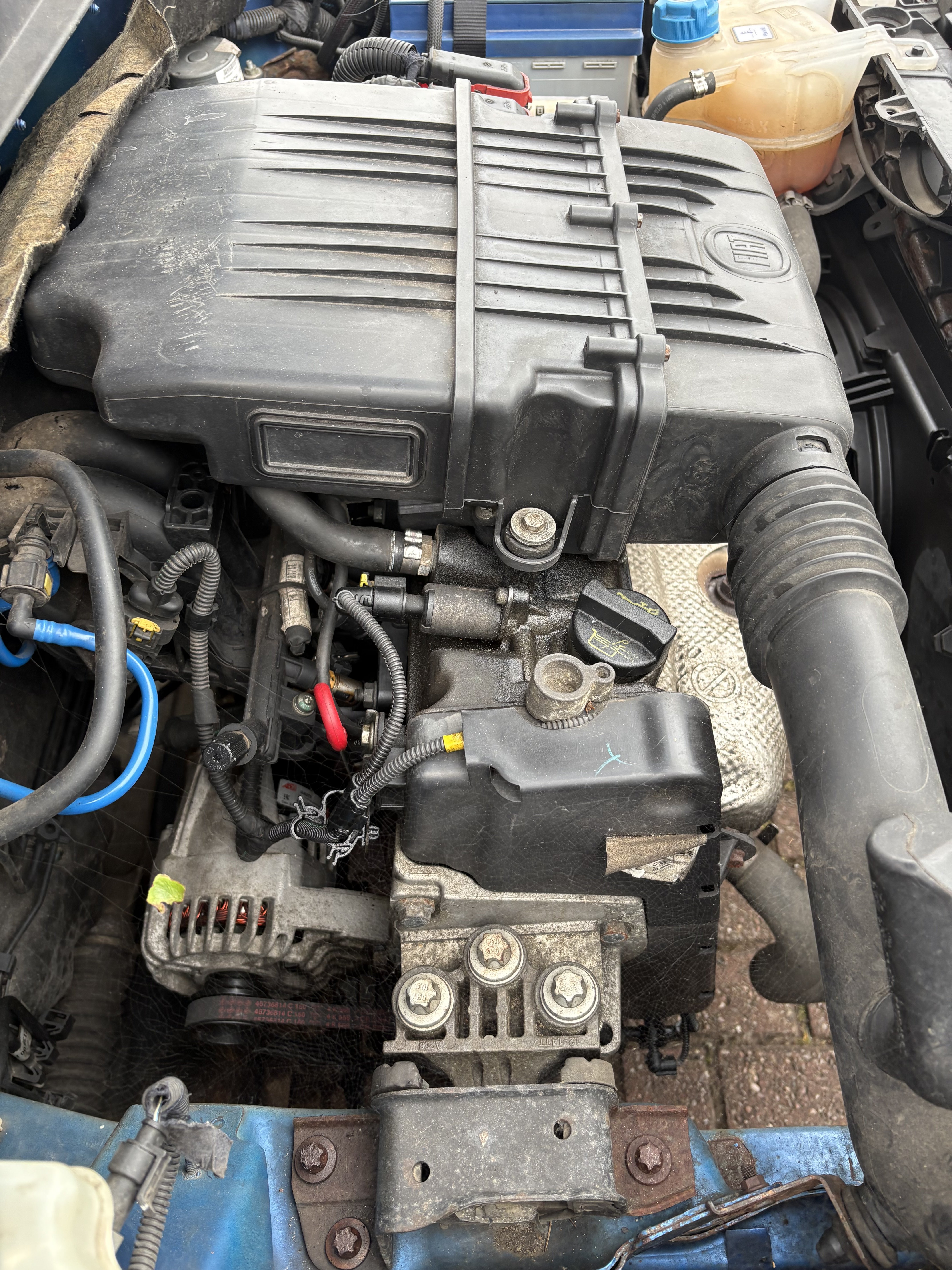

That’s the engine. Is there an easy way to check the belts condition ?

Comprehension check. Read the thread again.
Told you, it's 3 small bolts and you can see the timing belt (cracks, is it running on the edge of the VVT wheel, is it loose).
Watch any YouTube video (timing belt job) or find forum posts (maybe even a Guide - Grande Punto section).

Thanks , I’m not a mechanic and there is only one set of 3 bolts which don’t look easy to remove . YouTube only shows once these 3 bolts have been removed . Not how or what to remove to see the belt. And I don’t know what those arrows point too . Looks like the oil cap and 3 big bolts
